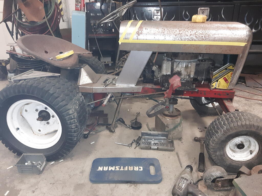

Oldskool 6,678 #78 Posted September 27, 2020 2 minutes ago, pullstart said: Could it be angled a bit, for a slanted dash? It just taped a line at the bottom to thin the hood out a bit. The 2 slanted pieces of tape are possible cuts. The one furthest back is a full cut then invert the piece. The next one is a cut up to the flat area on top then bend it down to the same angle as the uprite thats under the hood, then blend in the side curves 7 1 Share this post Link to post Share on other sites
ebinmaine 81,036 #79 Posted September 27, 2020 Either of those would look great 1 Share this post Link to post Share on other sites
Pullstart 71,481 #80 Posted September 27, 2020 Short answer? Yes! 4 Share this post Link to post Share on other sites
Tractorhead 9,218 #81 Posted September 28, 2020 5 hours ago, Oldskool said: It just taped a line at the bottom to thin the hood out a bit. The 2 slanted pieces of tape are possible cuts. The one furthest back is a full cut then invert the piece. The next one is a cut up to the flat area on top then bend it down to the same angle as the uprite thats under the hood, then blend in the side curves In princip yes, i would try to shift the hood few cm to the right, that the right slash aligns with the Tower and the front aligns with the Frame end. rounded the left lower side and built an addon Fueltank, Hood hinges below the hood from inner , more hidden, that would be my vote. but it is your project, btw - it still looking sharp 👍 2 Share this post Link to post Share on other sites
Oldskool 6,678 #82 Posted September 28, 2020 6 hours ago, Tractorhead said: shift the hood few cm to the right, that the right slash aligns with the Tower and the front aligns with the Frame end. rounded the left lower side and built an addon Fueltank, Hood hinges below the hood from inner , more hidden, that would be my vote. but it is your project, btw - it still looking sharp 👍 @Tractorhead I'm definitely thinking of sliding the hood a bit so the grille has a rake to it. As fast as cutting the hood to be flush with the tower, there is a 1" tab on the tower facing the seat that strengthens the top of it. I may put the fuel tank so the cap is thru the hood. If I go with hinges they will definitely be hidden. Thanks for the ideas. Keep 'em coming. It helps as I sit and stare at it designing. 3 Share this post Link to post Share on other sites
Tractorhead 9,218 #83 Posted September 28, 2020 18 minutes ago, Oldskool said: @Tractorhead I'm definitely thinking of sliding the hood a bit so the grille has a rake to it. As fast as cutting the hood to be flush with the tower, there is a 1" tab on the tower facing the seat that strengthens the top of it. I may put the fuel tank so the cap is thru the hood. If I go with hinges they will definitely be hidden. Thanks for the ideas. Keep 'em coming. It helps as I sit and stare at it designing. How about a bit bigger longrange Fueltank, flat end at filler and bigger end (rounded box shape) to tower direction. - with the moved hood i think a Motocycle Battery will fit in front of the Engine incl. Solenoid and regulator, so just a thinner wireharnest have to be brought to the Dash. thiner harnest = easier to hide.... 3 Share this post Link to post Share on other sites

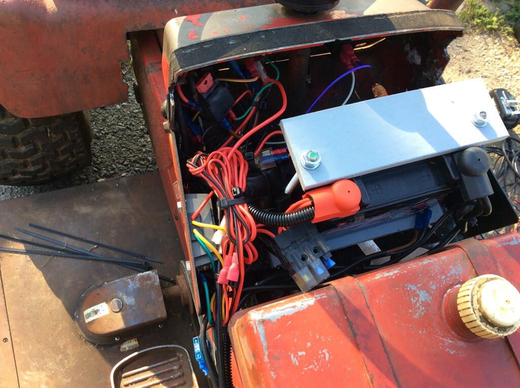

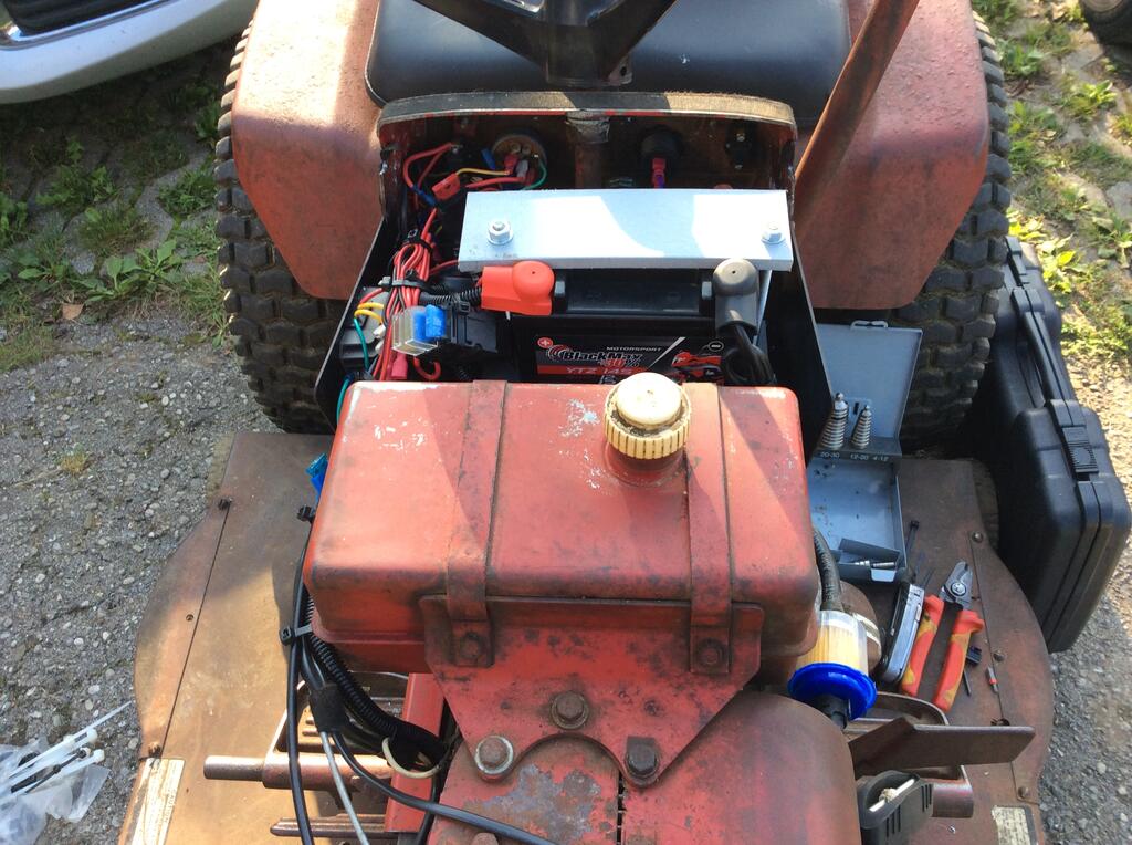

Tractorhead 9,218 #90 Posted September 28, 2020 5 hours ago, Oldskool said: The tank I have at the moment is from a gravely. It's a about 4x5x17". Not much room in front of the engine. The mock up engine doesnt have a head or rocker cover on it at the moment. I'm all for minimal wiring. I'm thinking the battery would have to be behind the seat. Hidden some how Let me show you, how i mean i have my complete electric installation compressed under the hood, include the Battery. that fit‘s under a 656 hood completely. there is also not much room, but it is enough for all the things i need. 1 1 Share this post Link to post Share on other sites
Oldskool 6,678 #91 Posted September 28, 2020 8 minutes ago, Tractorhead said: Let me show you, how i mean i have my complete electric installation compressed under the hood, include the Battery. that fit‘s under a 656 hood completely. there is also not much room, but it is enough for all the things i need. That's a tight fit. Is that a motorcycle battery? My engine bay may be a bit shorter and narrower, I'm not sure. I'm gonna try and get this hood figured out. That way I know exactly how much room I have to work with. 2 1 Share this post Link to post Share on other sites
Tractorhead 9,218 #92 Posted September 28, 2020 (edited) 15 minutes ago, Oldskool said: That's a tight fit. Is that a motorcycle battery? My engine bay may be a bit shorter and narrower, I'm not sure. I'm gonna try and get this hood figured out. That way I know exactly how much room I have to work with. Yap, that‘s a motocycle Battery with 225 CCA, what is enough Power to fire up the Engine easily. I can measure maybe tomorrow and give you my Values. the battery i use is a BlackMax YTZ14-S Motorradbatterie GEL 12V 12Ah YTZ14-4 Batterie GTZ14-4 51201 That fit‘s snug under the Hood. The Battery mount is selfmade out of Plastic i have aside, because i like to built it non conductive. Technical datas ( sorry for the german, but it was a pict) but i believe the Dimensions and compare values may help you. ETN: GEL 511021023 Spannung: 12 Volt Kapazität: 12 Ah Kaltstartstrom: 255 A/EN Länge: 150 mm Breite: 87 mm Höhe: 110 mm Gewicht: 3,9 kg Schaltung: Pluspol links Technologie: GEL (VRLA) Wartungsfrei nach DIN: Ja DIN-Typ: 51121 Kompatibel zu: 51101, 51121, 511902023, CTZ14S, FTZ14S, GTZ14S, TTZ14S-BS, YTZ 14S, YTZ14-S, YTZ14S, YTZ14S-BS Sortiment: BlackMax Plus 30 Motorsport Fahrzeugtyp: Jetski, Motorrad, Quad, Roller Lieferzustand: Neu, gefüllt & geladen = Einsatzbereit Verwendung: Starterbatterie I payed 33€ for it. the height of the battery was 110mm, that give me a clearance of 40mm over all in height to metall parts. if i estimate your build right, that could be comparable. btw i used the same battery on my 212 Horse with an upgraded Loncin 16 HP Engine without any troubles since a year. It fires right up even in Winter use. Edited September 28, 2020 by Tractorhead 1 1 Share this post Link to post Share on other sites
