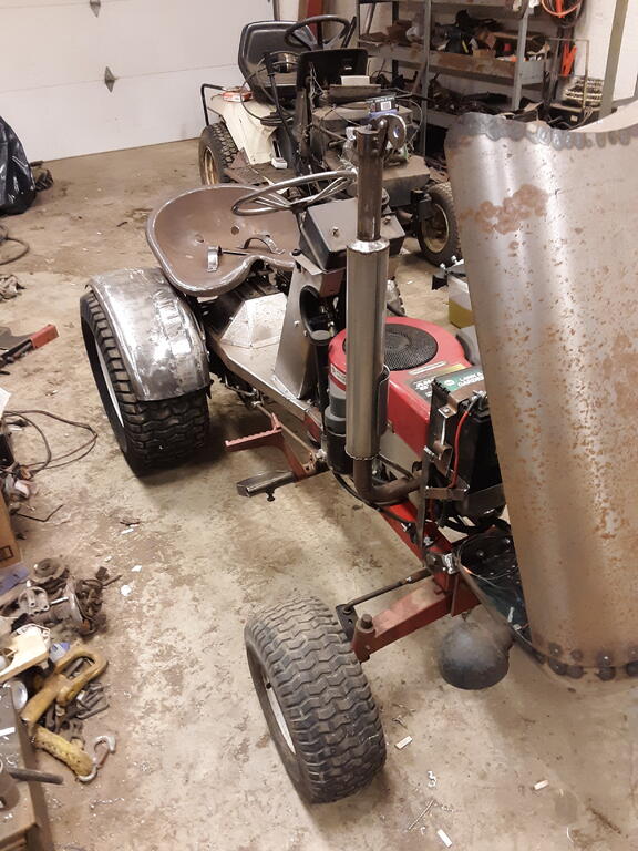

Oldskool 6,678 #332 Posted October 17, 2020 Dah horsey dont wanna run. It's being a P.I.T.A. Spark, air and starting fluid, wont fire. Gotta DIG deeper 1 Share this post Link to post Share on other sites
Achto 32,096 #333 Posted October 17, 2020 1 hour ago, Oldskool said: Dah horsey dont wanna run. It's being a P.I.T.A. Spark, air and starting fluid, wont fire. Gotta DIG deeper Check the fly wheel key. I have found that if I have every thing that I need on a Briggs but it won't run, chances are that the fly wheel key sheared some how. 3 Share this post Link to post Share on other sites
Oldskool 6,678 #334 Posted October 17, 2020 4 minutes ago, Achto said: Check the fly wheel key. I have found that if I have every thing that I need on a Briggs but it won't run, chances are that the fly wheel key sheared some how. That was the next thing I checked. That was the culprit. Purrs like a lion or um a HORSE 5 Share this post Link to post Share on other sites

Oldskool 6,678 #350 Posted October 18, 2020 Back on topic for a sec. No test drive today. The tank sealer hasnt cured yet. But it's already to go other than that 5 Share this post Link to post Share on other sites
