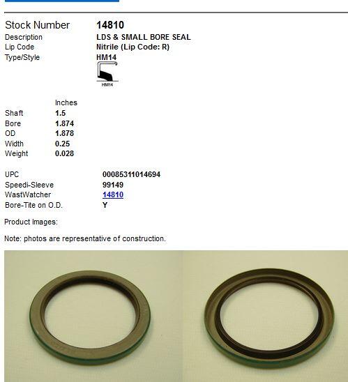

pfrederi 20,627 #3 Posted September 11, 2020 (edited) 14810 +/- $4.85 Edited September 11, 2020 by pfrederi Share this post Link to post Share on other sites
The Tuul Crib 7,354 #4 Posted September 11, 2020 Is this the skf number? Share this post Link to post Share on other sites

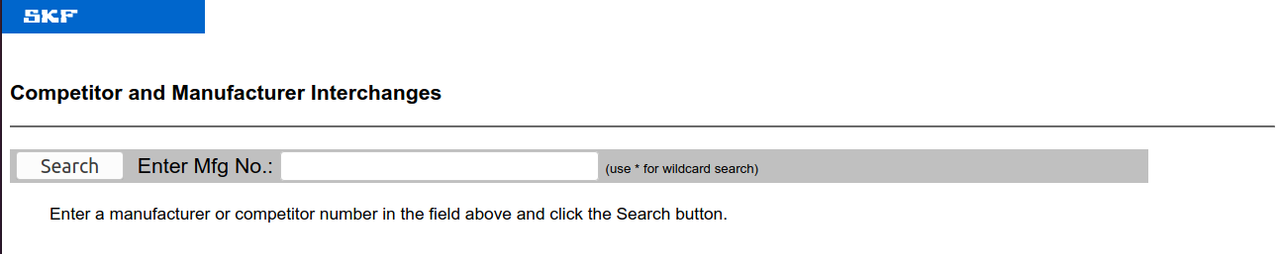

bc.gold 3,406 #5 Posted September 11, 2020 (edited) SKF Competitor and Manufacturer Interchanges Enter Mfg No.: (use * for wildcard search) Mfg No. Mfg Name SKF Part No. 6663 NATIONALAUTOM.SEALS 47660 6663 MURRAYS/CSK 47660 6663 WHEELHORSE 14810 6663 FMSEAL&BRG 47660 6663 NATIONALAUTOM.SEALS 47660 6663 NATIONAL 47660 6663 TIMKENSEALS 47660 6663 NATIONAL-INDLCANADA 47660 6663 TIMKENSEAL&BEARING 47660 Edited September 11, 2020 by bcgold Share this post Link to post Share on other sites

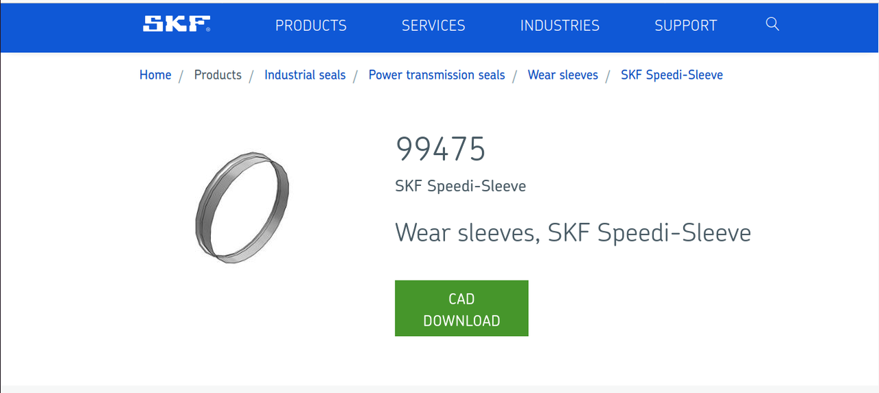

bc.gold 3,406 #6 Posted September 11, 2020 (edited) Here's the SKF number for the speedie sleeve if your shaft in showing some wear. Edited September 11, 2020 by bcgold Share this post Link to post Share on other sites

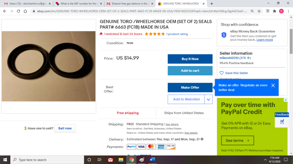

The Tuul Crib 7,354 #7 Posted September 11, 2020 I just called my local NAPA hear the seal was seven bucks which is good but it was a special order which would've cost it again plus for shipping nearly 20 bucks for the whole order for one seal. Found two on eBay free shipping for 7.50 apiece. Share this post Link to post Share on other sites
