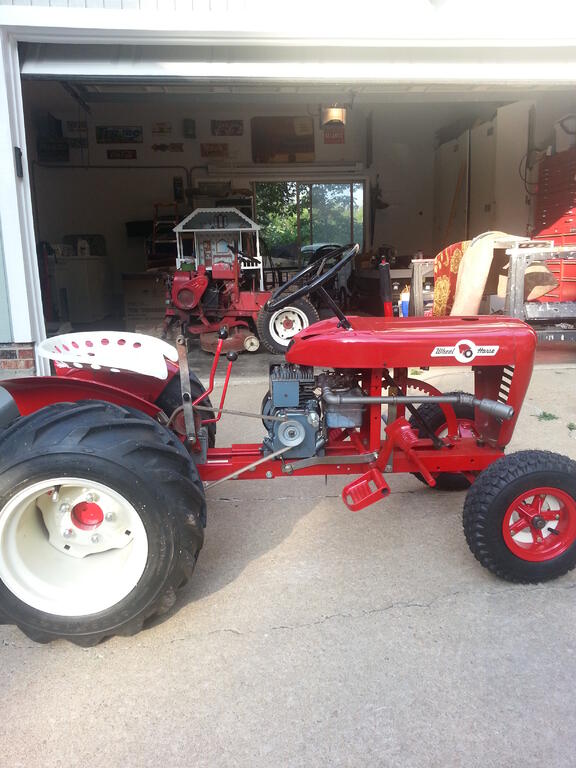

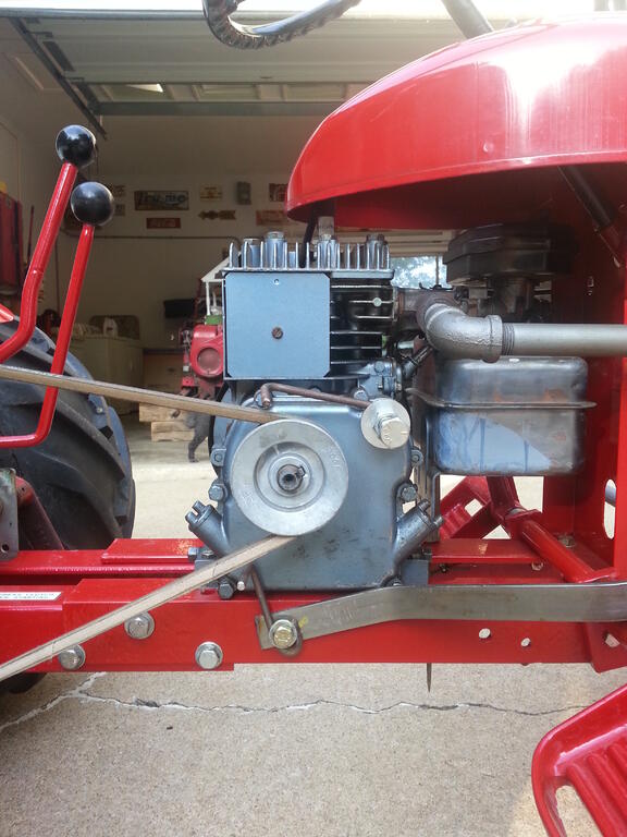

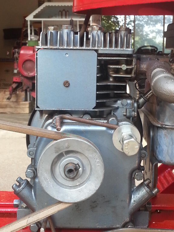

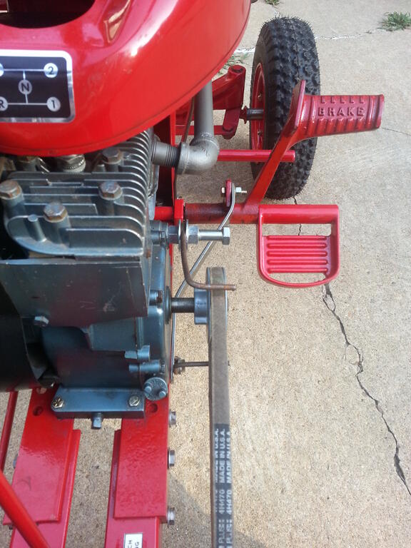

stevasaurus 23,857 #12 Posted September 12, 2020 Here are a few pictures of how Wallfish used the rod on Howard's horse. 2 1 Share this post Link to post Share on other sites
ebinmaine 80,772 #13 Posted September 13, 2020 12 hours ago, stevasaurus said: Here are a few pictures of how Wallfish used the rod on Howard's horse. @Stepney Spenser, you should show or send a link of this post to your buddy Andrew. I saw @wallfish John saying something to him about these wire guides yesterday. A visual is often helpful. Share this post Link to post Share on other sites
Kenjets 19 #14 Posted September 16, 2020 Thanks for the pic and all the help I now have it running well!!!! 4 2 Share this post Link to post Share on other sites

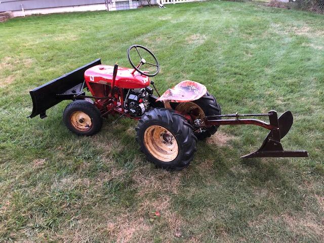

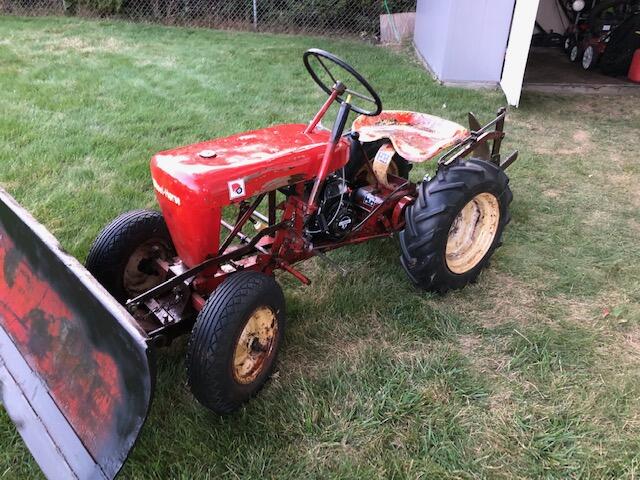

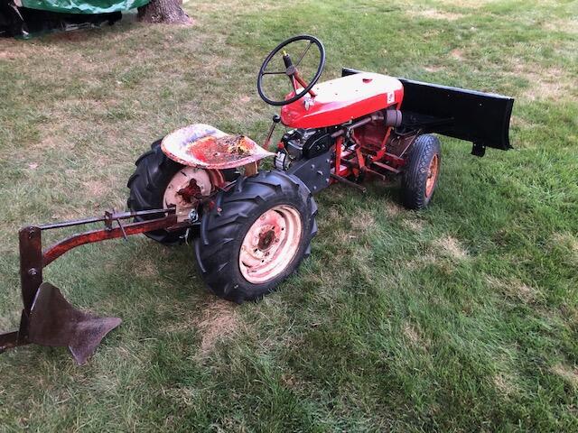

Kenjets 19 #15 Posted September 21, 2020 just wanted to post my Wheel Horse pics 1 3 2 Share this post Link to post Share on other sites
Pullstart 71,332 #16 Posted September 25, 2020 and what a machine @Kenjets! Share this post Link to post Share on other sites
The Tuul Crib 7,354 #17 Posted September 25, 2020 T😂 Nice tractor! Share this post Link to post Share on other sites
Tractorhead 9,217 #18 Posted September 25, 2020 to Beautiful Rig you‘re own. Share this post Link to post Share on other sites
