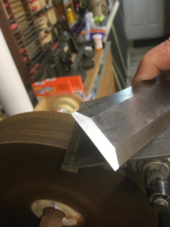

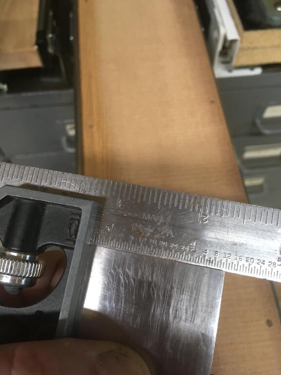

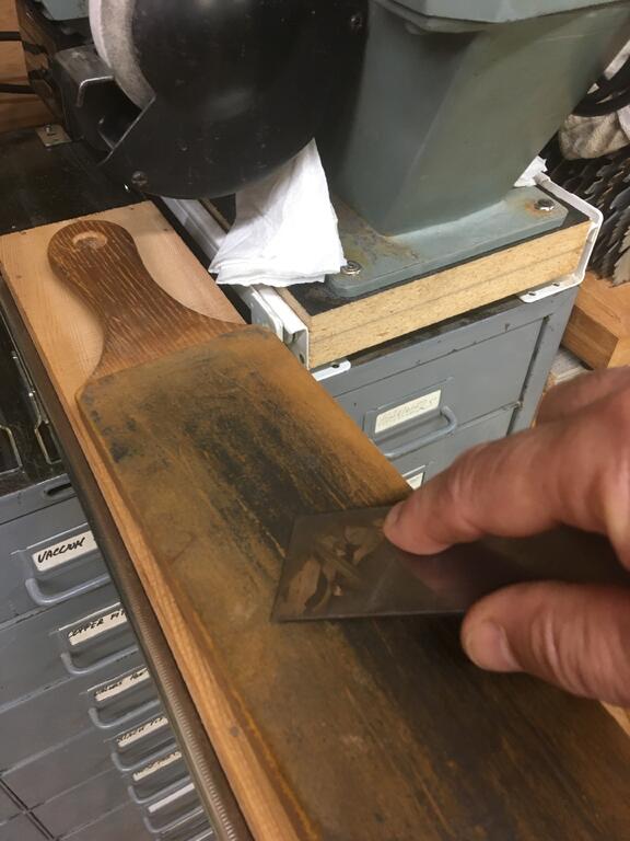

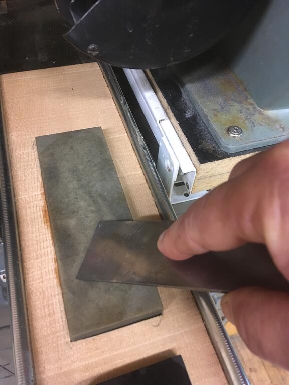

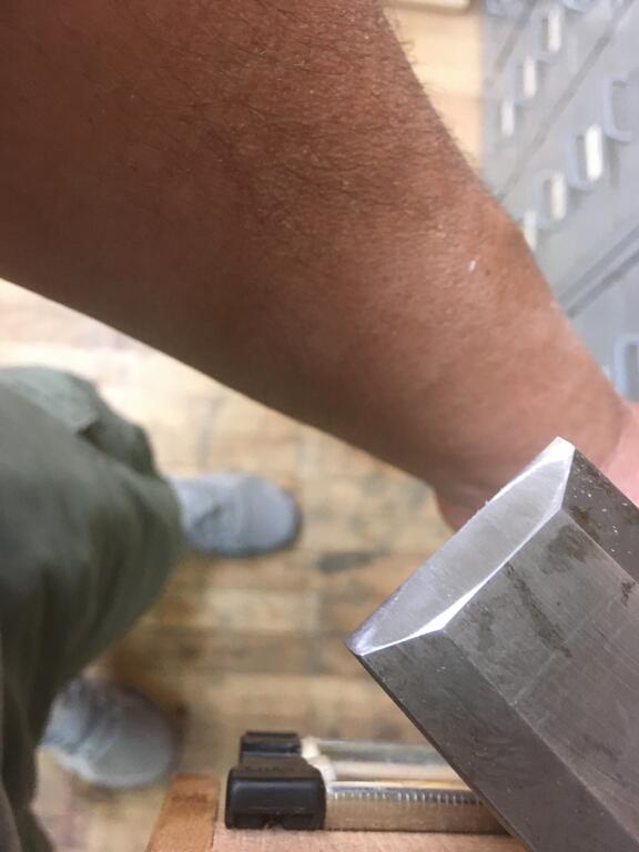

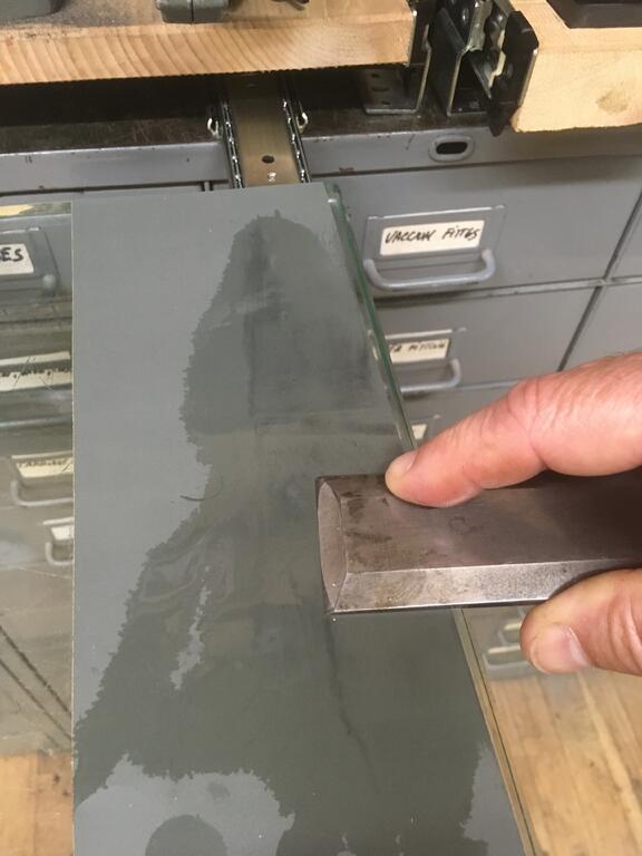

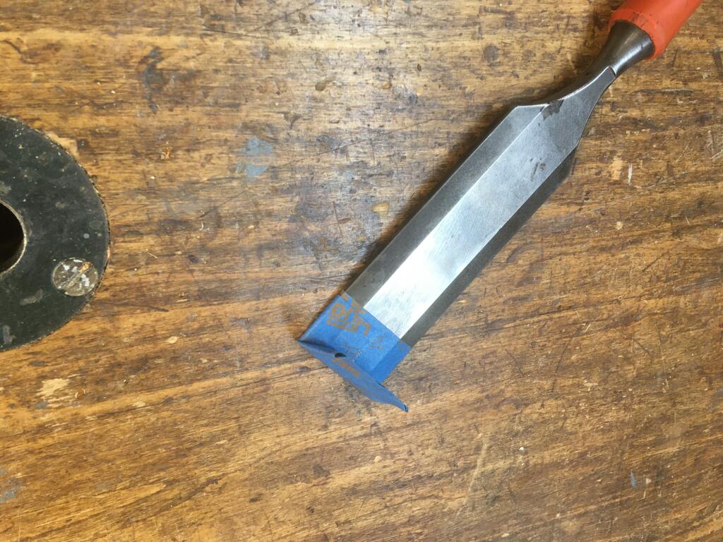

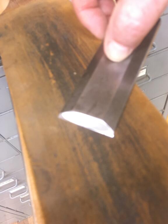

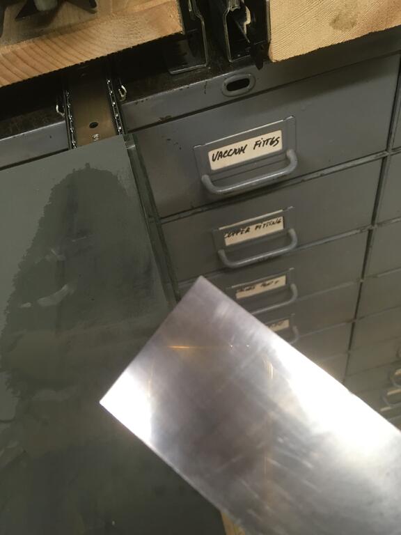

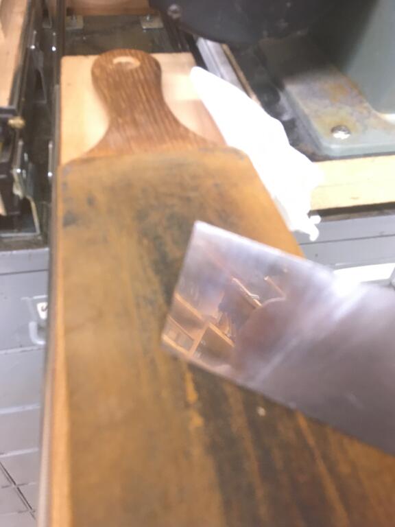

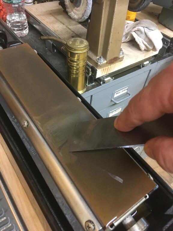

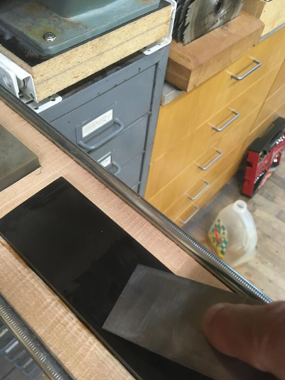

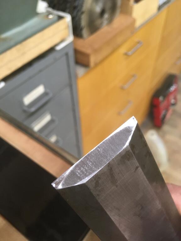

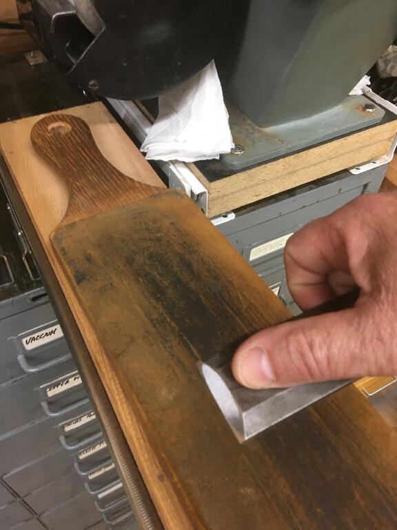

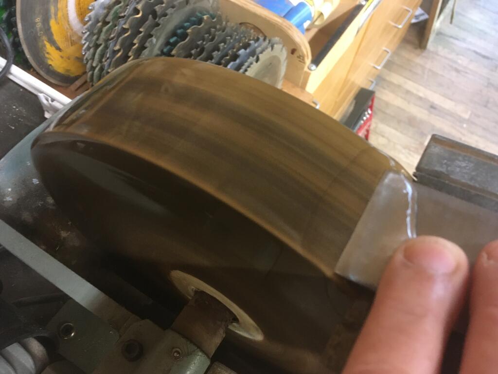

formariz 12,381 #1 Posted September 10, 2020 (edited) Time to regrind some chisels so here is how I go about it. first step is to grind a hollow ground bevel on slow water stone so as not to draw the temper. End result must be even , straight, and square to sides of chisel. Bevel angle depends on what chisel is used for. Softwoods and hardwoods require very different angles. Next is preliminary honing on a Norton Fine India drenched in kerosene. Then I do a final honing first on the Translucent Arkansas finishing then on the Black Surgical Arkansas also lubricated with kerosene I then remove burr from back on a flat glass plate with 2000 wet paper also loaded with kerosene. Back of chisels and plane blades have to be absolutely flat and void of marks or scratches. Honing stones are never flat to accomplish that. I originally lap all of them flat to a mirror finish on glass plates with sandpaper. I then finally use a leather strop On both bevel and back for a finishing touch. Back needs to be kept flat on strop also . Final test is shaving my left arm dry. If it doesn’t do that properly it’s not ready for wood. Blade is now good for about half a dozen honings until whole process needs to be done again. Sounds time consuming but if one does it often maintaining a hollow ground it’s really quick. This one took me less that 10 minutes beginning to end. To protect edges while not in use I tape them with masking tape. Edited September 10, 2020 by formariz 2 4 4 Share this post Link to post Share on other sites
