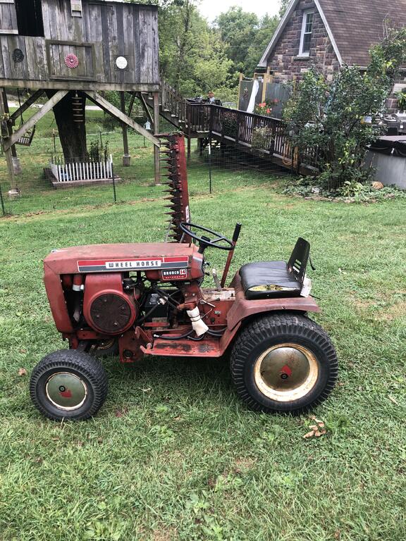

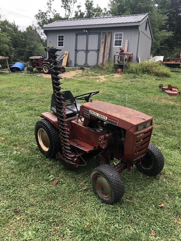

Sammy 89 #1 Posted September 10, 2020 I was wondering if anyone could give me any information on either of these wheel horse items, they both seem to be rarer objects but I’m trying to find out how rare and how much I could get for the whole setup. Every function on the tractor being the ampress, rectifier, both choke and throttle cables, headlight and tail light, cigarette lighter, and electric clutch work perfectly and it’s an all original machine. The sickle works great and I mow my banks with it every day! 4 Share this post Link to post Share on other sites

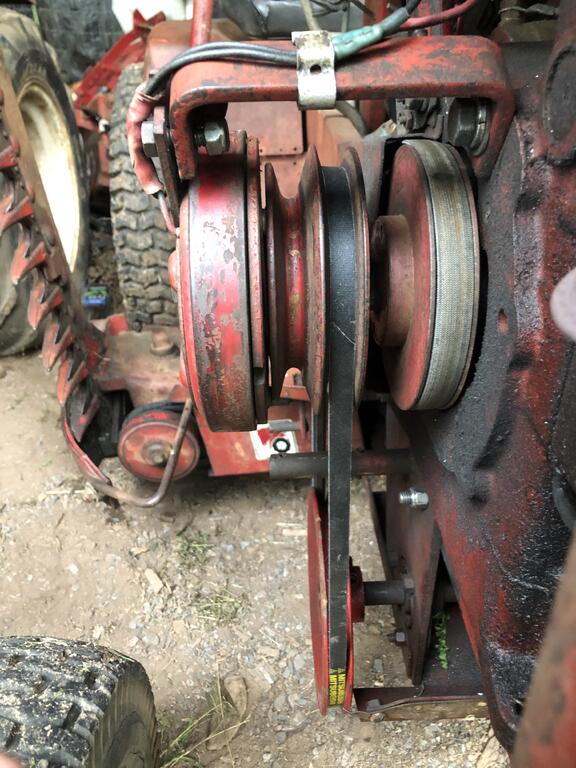

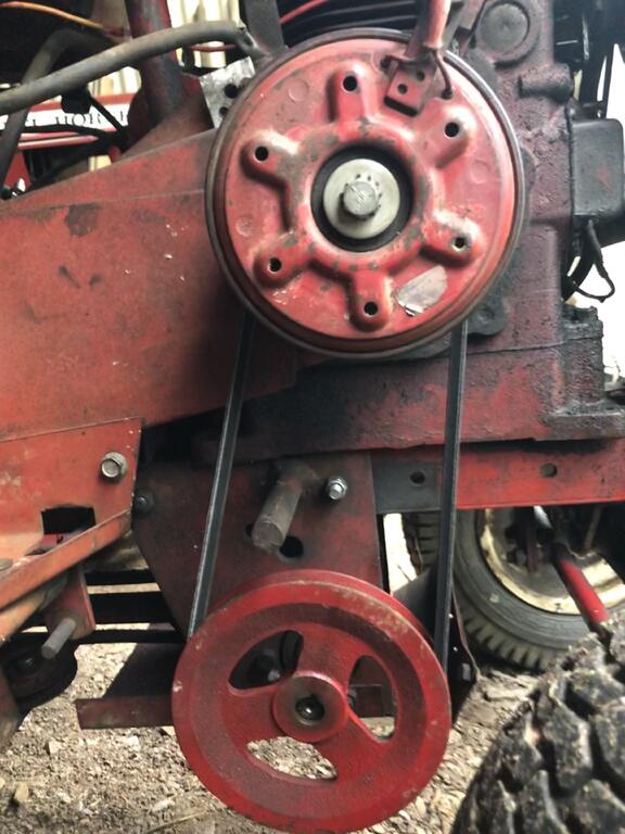

Goldnboy 1,156 #3 Posted September 10, 2020 I have read of few member posting that they were not able to figure out or were able to acquire the right pulleys to use the electric pto and had to convert to manual pto. Maybe you show post more pictures of this setup... Share this post Link to post Share on other sites
Sammy 89 #4 Posted September 10, 2020 (edited) 4 hours ago, Goldnboy said: I have read of few member posting that they were not able to figure out or were able to acquire the right pulleys to use the electric pto and had to convert to manual pto. Maybe you show post more pictures of this setup... Here are some pictures of it. It’s a standard bronco 14 electric clutch on the engine PTO and then on the sickle bar bracket that bolts to the frame it’s a cast iron pulley off of a 1871 800 special transmission. It’s 7 inches In diameter and a 3/4 inch bore. And for the belt tensioner it’s quite simple, I don’t have on, the belt is tight enough it keeps its self tensioned. Also the first pictures of it have a really flimsy pulley on the sickle bar bracket but we didn’t like that so we changed it. Also I forgot to mention before that I only have $600 into this whole setup! Edited September 10, 2020 by Sammy 2 Share this post Link to post Share on other sites
