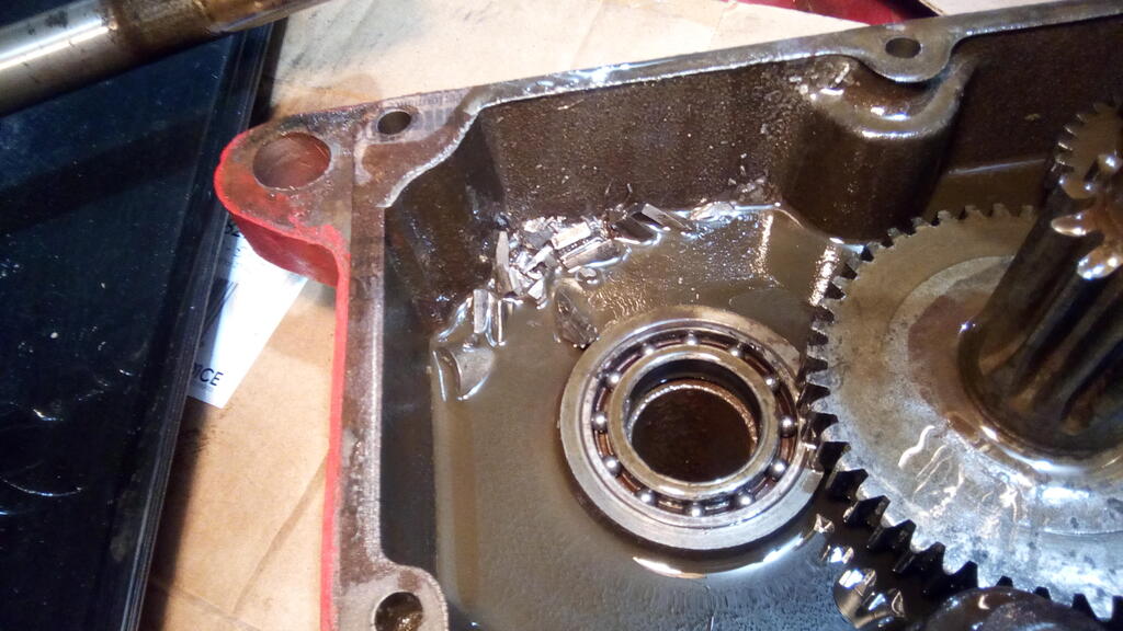

C_hasbeen 249 #1 Posted September 10, 2020 Fall plowing deep as my 6 HP techumseh could do in hard clay, I was pulling good and would find a hard pan and turn up chunks the size of a large cat and the little 6 horse pulled down hard and would get through and on we would go until the differential gears started shedding teeth I guess. I heard a racket then nothing again when I went to turn the differential seemed locked and we'll things went south from there. On the good side of things my new bearings, seals and third gear are all happy! I guess parts hunting is option one. 3 Share this post Link to post Share on other sites

953 nut 63,633 #6 Posted September 10, 2020 Never seen one blow apart like that, looks like plenty of oil in it too. The differential from any '63 or later will fit if the axles are the same size. 1 Share this post Link to post Share on other sites

WHX?? 53,919 #12 Posted September 10, 2020 And I thought I had tranny problems! Make sure you get all those chips out of there and go with a magnetic drain plug when she goes back together. 3 Share this post Link to post Share on other sites

Tractorhead 9,216 #16 Posted September 10, 2020 8 hours ago, WHX24 said: go with a magnetic drain plug when she goes back together. Yap, that‘s definitely a great idea. i thinkering allready about, if i should be provided my 656 with a magnetic drain plug or not, but after seeing this i‘m sure i will definitely go that Way. Thanks @WHX24for this reminder and @C_hasbeen good luck for a quick fix. 1 Share this post Link to post Share on other sites

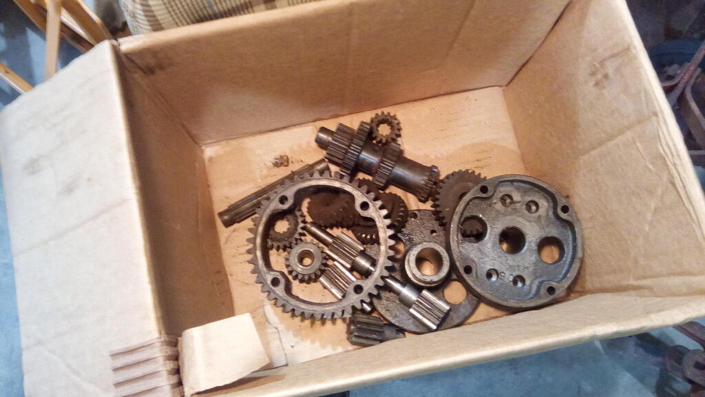

stevasaurus 23,536 #21 Posted September 12, 2020 I don't see any axle gears in that box?? 1 Share this post Link to post Share on other sites
C_hasbeen 249 #22 Posted September 13, 2020 8 hours ago, stevasaurus said: I don't see any axle gears in that box?? Yep I have them installed and all back ready for oil and put my hubs and wheel on. I may have already set them out when I grabbed a snapshot 1 Share this post Link to post Share on other sites
