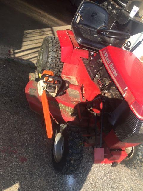

Lagersolut 793 #1 Posted September 7, 2020 Picked up this 416 last year spent last fall going over the entire tractor fixing the broke stuff dusting off the 32 years corrosion on the electrical . Absolutely love this K341 it is a beast . Still has the original seat I'm thinking of calling around finding a place that would reupholster the seat . Looking for opinions yes or no on a re do on a original wheel horse seat - Northern tool discontinued the seat that was a close match to these . Thoughts opinions Share this post Link to post Share on other sites

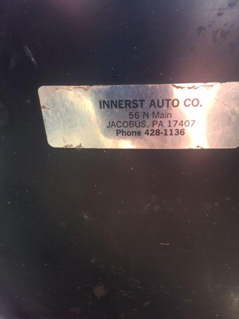

lynnmor 8,623 #2 Posted September 7, 2020 I doubt that you will find anyone that can redo the seat, they were molded and the covering was formed using heat. I contacted some upholstery shops that do motorcycle and tractor seats and they wouldn't attempt it. If you find someone, please let us all know. Innerst is where I bought my first Wheel Horse in 1991. 2 Share this post Link to post Share on other sites
Lagersolut 793 #3 Posted September 7, 2020 3 minutes ago, lynnmor said: I doubt that you will find anyone that can redo the seat, they were molded and the covering was formed using heat. I contacted some upholstery shops that do motorcycle and tractor seats and they wouldn't attempt it. If you find someone, please let us all know. Innerst is where I bought my first Wheel Horse in 1991. Thanks for the info - I still go to innerst for parts - the girl behind the counter is a real ace if you're having issues with numbers on these tractors. I bought another style seat from Northern tool for a diff tractor - bolted up fine but hated the way it sits - too high and too hard . Share this post Link to post Share on other sites

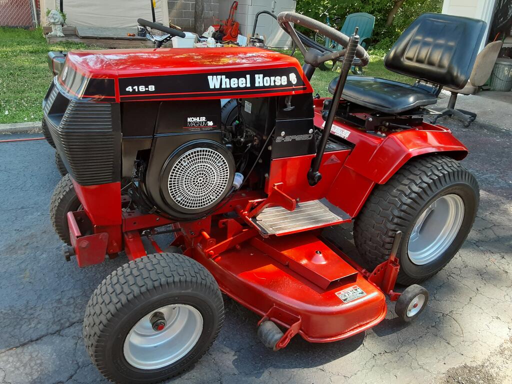

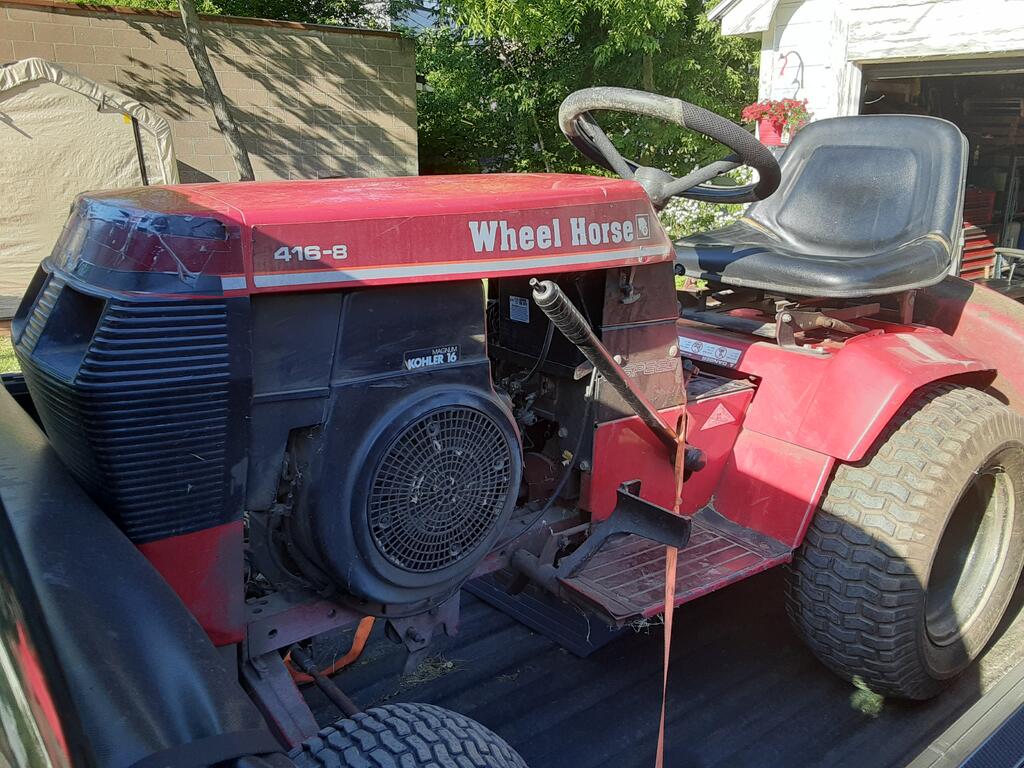

D_Mac 9,333 #9 Posted September 8, 2020 (edited) I had an 1988 416-8 that I refreashed this year. Original seat was torn at the corners. Replaced it with this sliding seat. Edited September 8, 2020 by D_Mac Share this post Link to post Share on other sites
WHNJ701 4,169 #10 Posted September 8, 2020 Not sure if this helps if the seat cover comes off? if does you glue in patch panels from behind and then use black vinyl filler, I figured out how to do this repair wasn't to bad 1 Share this post Link to post Share on other sites
Lagersolut 793 #11 Posted September 8, 2020 4 hours ago, D_Mac said: I had an 1988 416-8 that I refreashed this year. Original seat was torn at the corners. Replaced it with this sliding seat. Beautiful job on the re do -noticed yours has a magnum - wondering if I dated mine wrong - thought mine was a 1988 but I’m sporting a K341 ... were they just starting to introduce the mags ? 1 Share this post Link to post Share on other sites
wallfish 19,281 #12 Posted September 9, 2020 The K engines ended in 86 for the 416. 87 started with the magnums 1 Share this post Link to post Share on other sites

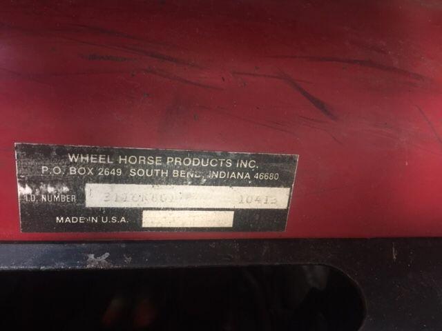

Lagersolut 793 #13 Posted September 9, 2020 (edited) 24 minutes ago, wallfish said: The K engines ended in 86 for the 416. 87 started with the magnums This is what’s left of the model serial tag ... Edited September 9, 2020 by Lagersolut Wrong tag picture Share this post Link to post Share on other sites

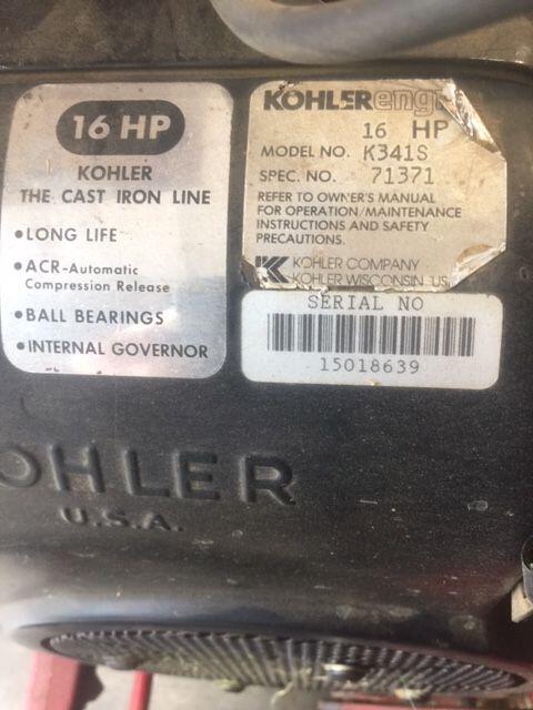

Lagersolut 793 #14 Posted September 9, 2020 Think I got this figured out - paged through my pictures today found a better one I took right after I bought it - my eyes aren't what they use to be I left someone else decipher this last year who thought it was a 803 on the tag putting it at 1988 - today I dated the Kohler numbers engine dates to 1985 - looks like I have a 1985 416-8 Share this post Link to post Share on other sites
