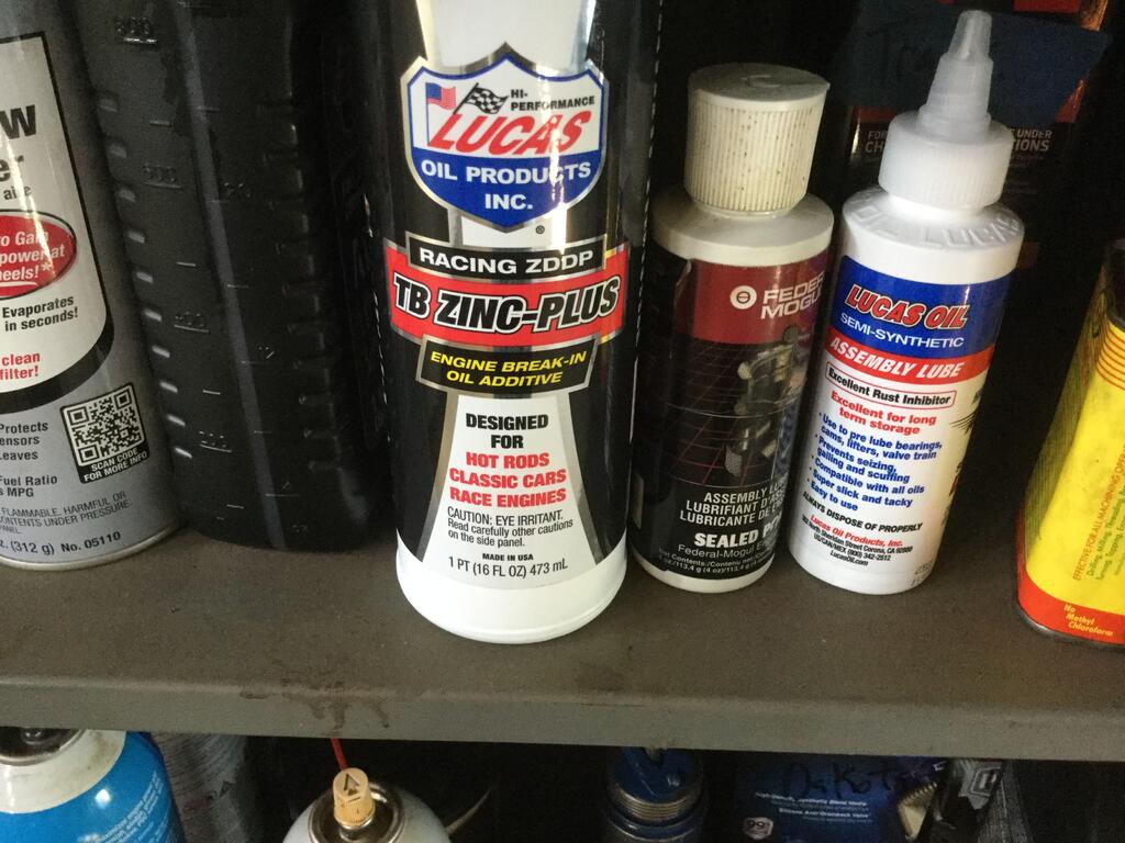

richmondred01 2,333 #8 Posted September 7, 2020 On all my Kohler k and Magum engines I rebuild I recommend using the zinc additive too. For break in: 2.5 ounces for a two quart pan, put the additive in then fill with a high quality 30w detergent oil. Run the engine at governed speed 85-90% for 2 hours and don’t let it idle for any extended period. After 2 hours, drain the oil. Continue to use the additive and high quality 30 weight detergent oil and change the oil every 20 hours. I use the Lucas however, I may switch to the RISLONE ZINC HY-PER LUBE , ZDDP SUPPLEMENT because of the price difference. 3 Share this post Link to post Share on other sites

richmondred01 2,333 #11 Posted September 7, 2020 I guess I wasn’t clear. Sorry. I use Lucas for break in. Ill start using Rislone after. 2 Share this post Link to post Share on other sites

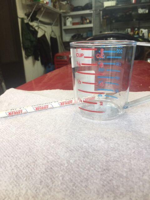

Lagersolut 793 #17 Posted September 11, 2020 On 9/7/2020 at 10:55 AM, peter lena said: lynnmor, i only use a small amount of zinc to my fresh oil changes , wish the bottle had an amount scale on it, its an 11 oz bottle , so a couple of light squeezes does it. on the other hand the old chevy oil capacity , would take the bottle, pete I just picked this up on Amazon to measure out my oils and additives - 6 bucks but it's really a sturdy little cup ( 8 oz ) 1 to 8 ounces . 1 Share this post Link to post Share on other sites
