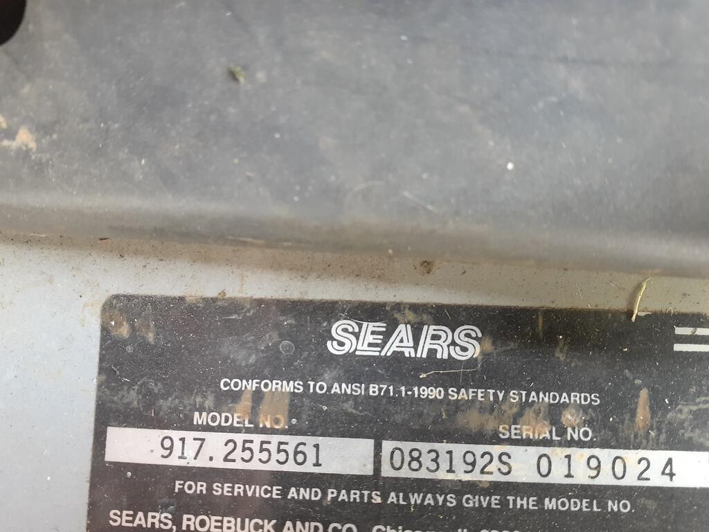

bds1984 1,518 #7 Posted September 3, 2020 You have a Sears to call?!? Mine closed last November. Some pictures and model numbers would help us help you much quicker. There has to be a hundred of those transaxles in any junkyard. Share this post Link to post Share on other sites
Renrag 69 #8 Posted September 5, 2020 Sorry phones been screwed up, I'll get pics of collar in a bit, but i got numbers, and no i called sears, no help there. Share this post Link to post Share on other sites
