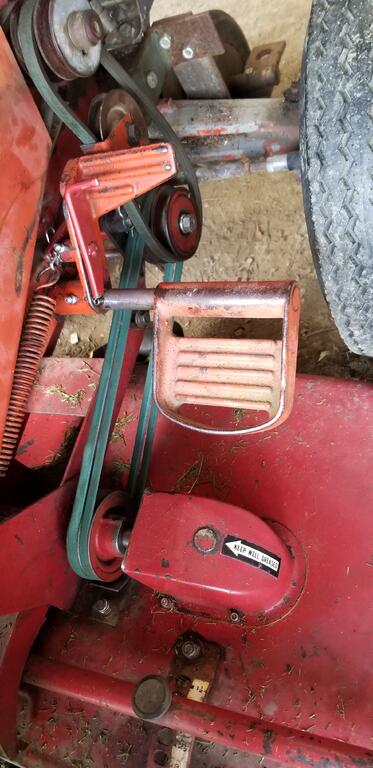

atbinkowski 13 #32 Posted September 3, 2020 Thanks for the ideas fellas. I have another question. How do I disengage the PTO on the 500? From what I've seen in the few (ok, one) video I've found with someone trying to do it, it has to do with a lever on the left pedal. It doesn't budge on mine, yet. I want to make sure I'm not missing anything before the Marine comes out in force Share this post Link to post Share on other sites
Racinbob 13,135 #33 Posted September 3, 2020 It's the small lever on the left side of the pedal on the right. Push the larger pedal and the lever will hold it disengaged be catching a roll pin. Push the little lever and it will allow it to clear the roll pin and let the pedal move back and tighten the belt. Simple but kinda hard to say. You'll need to get all the parts freed up 2 Share this post Link to post Share on other sites

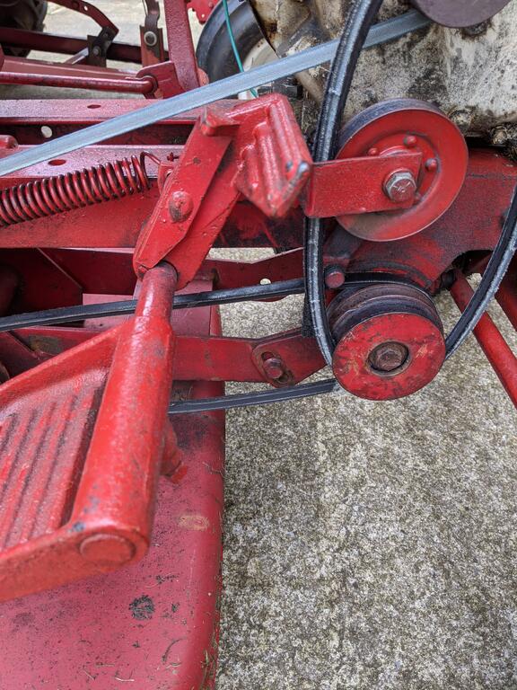

gt14rider 1,278 #34 Posted September 3, 2020 (edited) Some pics Edited September 3, 2020 by gt14rider More pics 1 Share this post Link to post Share on other sites
atbinkowski 13 #35 Posted September 4, 2020 Thank you both. When I've looked all mine, it doesn't seem like the little lever can move because of how it rides against the shaft of the pedal, but it is the exact same as in the picture. I'll see about getting it moving next week. Planning for a weekend long camping trip with my son that starts today. Thank you all again for your help and advice! Have a great Labor Day Weekend! 1 Share this post Link to post Share on other sites

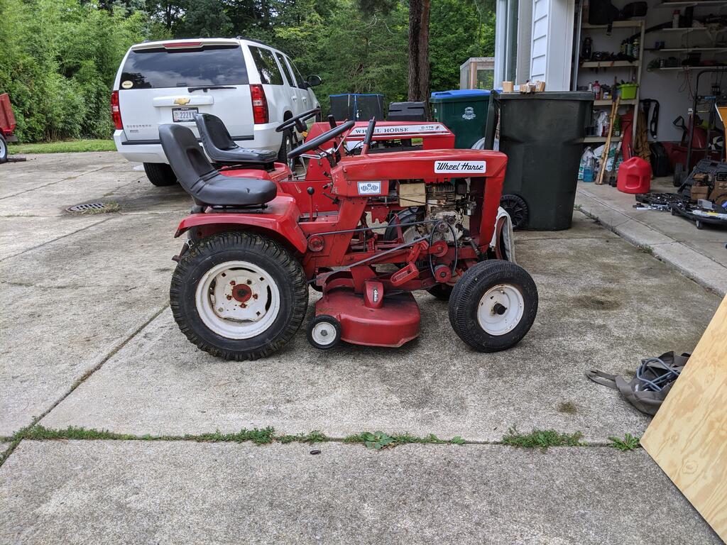

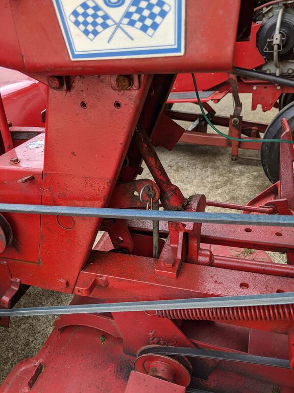

atbinkowski 13 #40 Posted September 14, 2020 Their for the link to the crankshafts! I have another question. Is there a way to raise the front of the deck? Mine send to sit really low. I know the way to check it is to have the deck on the ground, so forgive the pictures. Do I have the roof from the deck to the lift lever in the right position (second pic)? What is the purpose of the bolt in the third picture? Thanks again for all the help! Share this post Link to post Share on other sites
