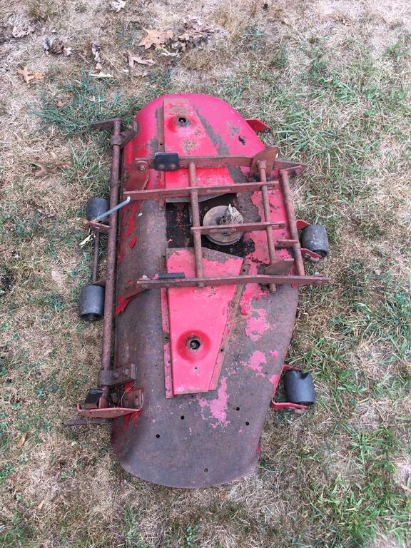

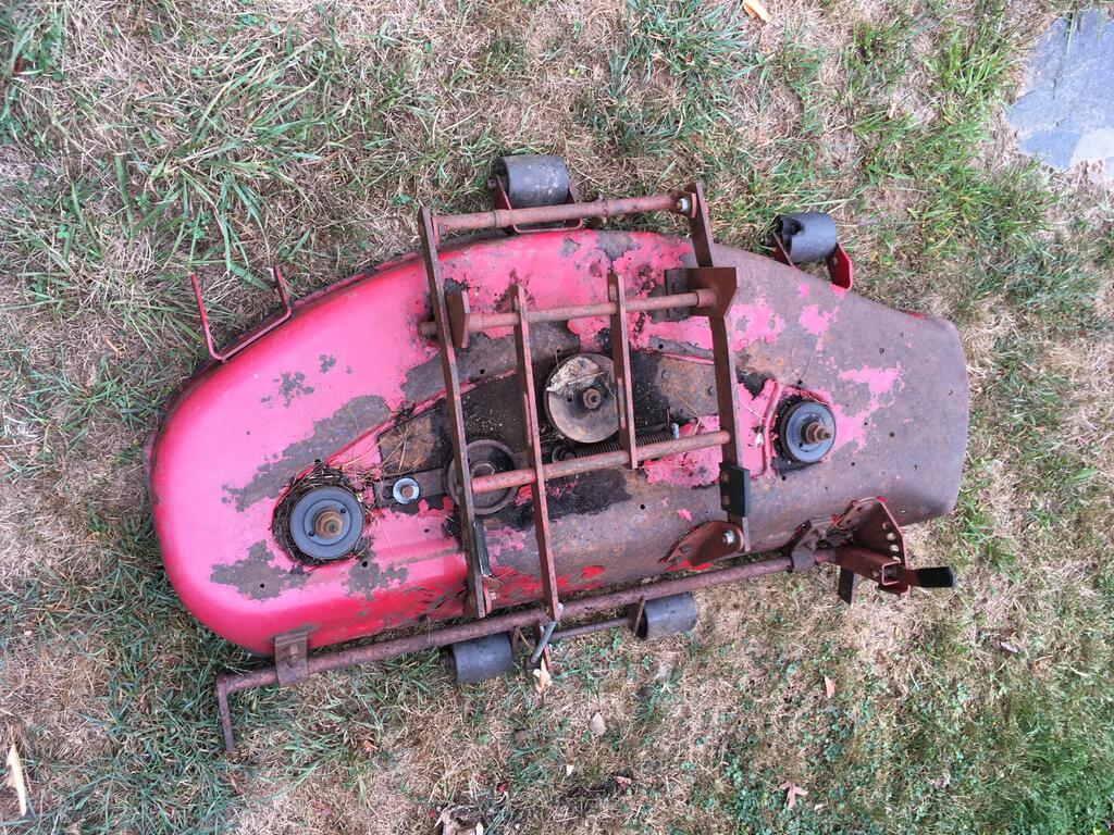

TonyToro 1,166 #1 Posted September 1, 2020 Hey Guys. I’ve searched the site but can’t find determine if my deck will fit the B-80. I don’t see any numbers on the deck to get a model number. Any help would be appreciated. Share this post Link to post Share on other sites
Goldnboy 1,117 #2 Posted September 1, 2020 Yes it will, I run same deck on my B80-8 if grass is tall may want to mow in low range 2 Share this post Link to post Share on other sites
c-series don 11,944 #3 Posted September 1, 2020 It will fit, but that looks to be a 48” deck which might be a bit much for an 8hp. 1 Share this post Link to post Share on other sites
TonyToro 1,166 #4 Posted September 1, 2020 Awesome! 2 quick yes good enough for me!! Thanks guys!!!! 1 Share this post Link to post Share on other sites
oldlineman 1,722 #5 Posted September 1, 2020 No it's a 42" but it need gage wheels. Share this post Link to post Share on other sites
TonyToro 1,166 #6 Posted September 1, 2020 4 minutes ago, oldlineman said: No it's a 42" but it need gage wheels. I just measured it and yes I agree I think it’s a 42”. Share this post Link to post Share on other sites
daveoman1966 3,883 #7 Posted September 1, 2020 I confirm that it is a 42" deck...not 48". The deck belt you need is # 6738. 1 Share this post Link to post Share on other sites
TonyToro 1,166 #8 Posted September 1, 2020 4 hours ago, daveoman1966 said: I confirm that it is a 42" deck...not 48". The deck belt you need is # 6738. Lol how did you know that was going to be my next question. 1 Share this post Link to post Share on other sites
pfrederi 20,613 #9 Posted September 1, 2020 No reinforcing plate and height adjuster is on discharge size... 2 Share this post Link to post Share on other sites
