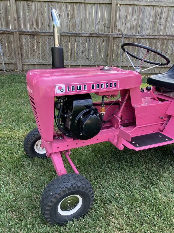

dclarke 4,117 #9 Posted September 1, 2020 Here’s a couple of later model Rangers, one with a K91 and one with a K181. Both are pull start. 3 Share this post Link to post Share on other sites

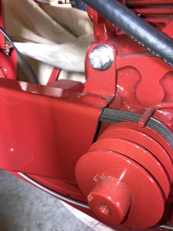

71_Bronco 1,072 #11 Posted September 2, 2020 Finally got in touch with the leaf blower guy. Says it starts up first or second pull and runs perfectly. I'll be meeting up with him tomorrow after work. I'll probably use it to blow leaves this fall, then tear it down this winter and swap over the starter-generator parts. @dclarke, on the red Lawn Ranger, with the K181, did that crank fall in the same spot as the old Tecumseh? Or did you need to modify the belt guard to work with the new engine? Share this post Link to post Share on other sites
dclarke 4,117 #12 Posted September 2, 2020 4 minutes ago, 71_Bronco said: @dclarke, on the red Lawn Ranger, with the K181, did that crank fall in the same spot as the old Tecumseh? Or did you need to modify the belt guard to work with the new engine? I think the only mod I made to the belt guard was I made a bracket to bolt the guard to the Kohler engine. 3 Share this post Link to post Share on other sites

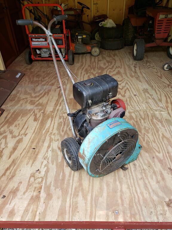

71_Bronco 1,072 #13 Posted September 4, 2020 @dclarke, thanks for the info. I can make a bracket no problem. I got the leaf blower last night. Pretty cool old machine, thick sheet metal housing, impeller looks to be cast aluminum. I plan to use it this fall, then possibly pull the motor in the winter. I'll probably keep on the look-out for another K181, as this little machine is almost too nice to tear apart. I'll post some pics this weekend. Share this post Link to post Share on other sites

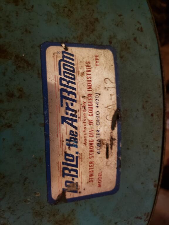

71_Bronco 1,072 #14 Posted September 7, 2020 (edited) Here's the leaf blower, took some pics today after cleaning the shed a little. It is a "Lo-Blo" leaf blower. The spec number on the engine says it has a standard, straight, keyed output shaft, should work just fine. Edited September 7, 2020 by 71_Bronco Share this post Link to post Share on other sites
