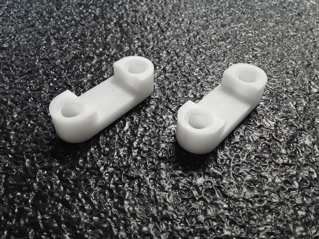

Goldnboy 1,147 #4 Posted August 31, 2020 I have a pair of used Teflon slides. Pm If you want a pair of used ones. Share this post Link to post Share on other sites
Goldnboy 1,147 #5 Posted August 31, 2020 I can get you pictures today or tomorrow but I sell a pair for $12 shipped Share this post Link to post Share on other sites
