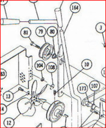

prondzy 3,891 #1 Posted August 31, 2020 does anyone have the dimensions for this spacer on an 875? Mine is missing and i have nothing to go by. Or possibly an extra one lying around??? Share this post Link to post Share on other sites
Achto 32,927 #2 Posted August 31, 2020 I believe that you could get away with some common washers there. It just needs to keep the pulley from rubbing on the bracket. 1 Share this post Link to post Share on other sites
prondzy 3,891 #3 Posted August 31, 2020 (edited) Dan of you look at the picture the bushing is shaped like a top hat and needs to go inside the bracket to keep proper spacing. I can turn one on the lathe if i could get some dimensions. Edited August 31, 2020 by prondzy Share this post Link to post Share on other sites

WHX?? 58,347 #6 Posted August 31, 2020 (edited) Would it be the same as a '66 or 67 Mike? What's the part number? If it's the same I bet I have one. Looks like it is...# 80 bet there is one on the parts tractor. Will look tonite. There is a flanged reducer bushing that does the spacing, or helps, in the idler too if I remember right. From a 10/1277 IPL Edited August 31, 2020 by WHX24 1 Share this post Link to post Share on other sites
prondzy 3,891 #7 Posted August 31, 2020 5 hours ago, WHX24 said: Would it be the same as a '66 or 67 Mike? What's the part number? If it's the same I bet I have one. Looks like it is...# 80 bet there is one on the parts tractor. Will look tonite. There is a flanged reducer bushing that does the spacing, or helps, in the idler too if I remember right. From a 10/1277 IPL Yes #80 i just need some dimensions to get i close like i said i can probably just turn one on the lathe 1 Share this post Link to post Share on other sites

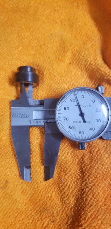

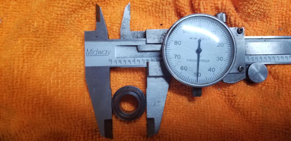

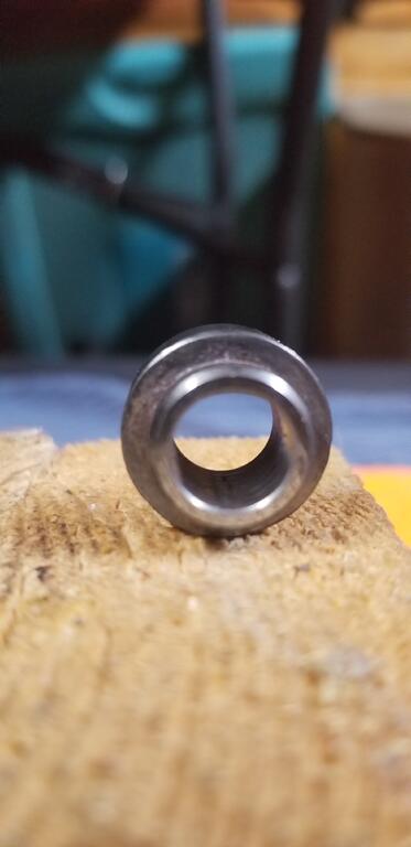

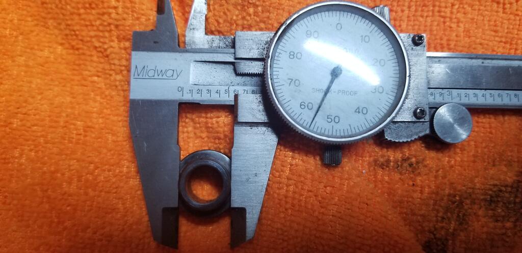

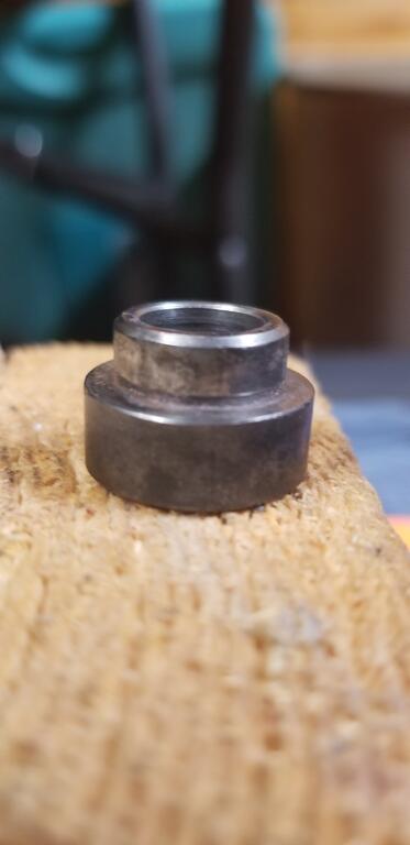

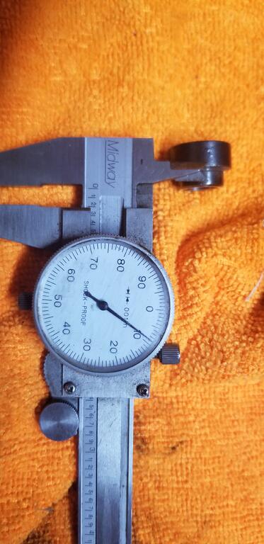

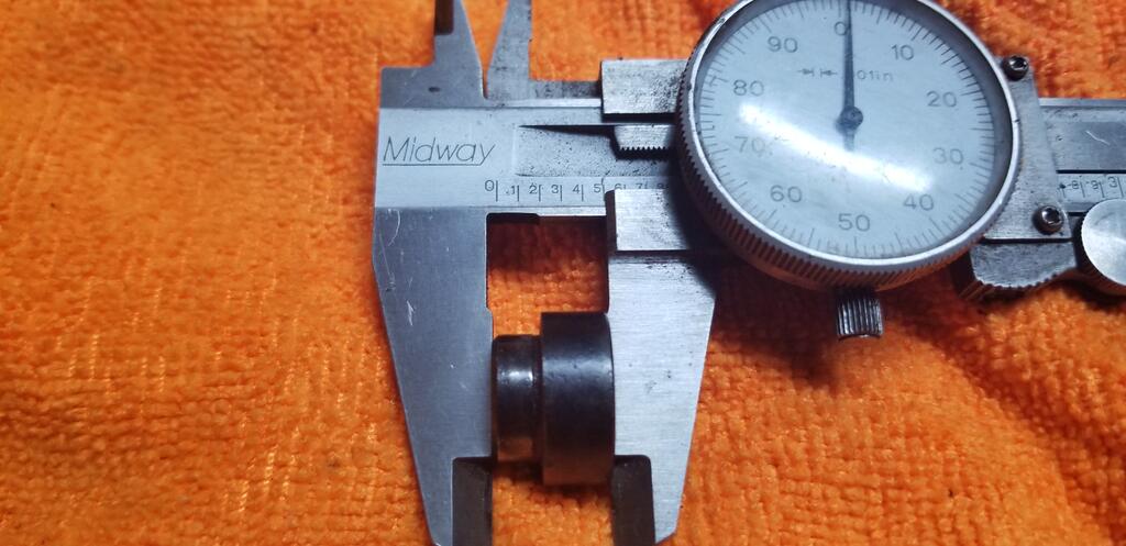

gt14rider 1,283 #12 Posted September 1, 2020 Here's one off a gt14, 1 Share this post Link to post Share on other sites
pfrederi 21,312 #13 Posted September 1, 2020 The part number for an 875 spacer is 6134 (new number 100309 still available) For a GT-14 spacer 100431 (NLA) and for a Charger 7435 (NLA) Confused yet???? 1 1 Share this post Link to post Share on other sites
