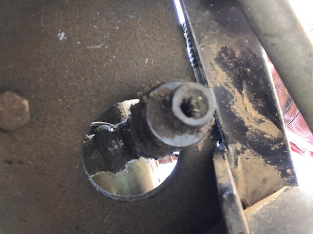

TimH 105 #1 Posted August 30, 2020 Can you what kind of oil drain plug this is on our newest Horse ? And how it works ? Share this post Link to post Share on other sites
rmaynard 17,105 #2 Posted August 30, 2020 Are we viewing from the underside of the frame? Share this post Link to post Share on other sites
squonk 46,101 #3 Posted August 30, 2020 (edited) I've seen those. Not factory. I think those you just grab it and pull out to drain and push in to close Edited August 30, 2020 by squonk Share this post Link to post Share on other sites
TimH 105 #4 Posted August 30, 2020 Thanks. I figured it out Push in and twist 1/4 turn Out comes the oil 3 Share this post Link to post Share on other sites
peter lena 9,849 #5 Posted August 30, 2020 TIMH, i am not familiar with that type of drain plug ,and would be leary of its function , i am familiar with failsafe type of oil valve , commonly on boats and difficult service areas .https://www.ezoilchangevalve.com/store/p37/EZ-5_[Thread_size_%3A_25mm-1.5].html?gclid=EAIaIQobChMI5OHf-rfD6wIVvYpaBR3PsQVaEAQYASABEgLWbfD_BwE . just showing you this as a possible go to if you decide to swap. pete Share this post Link to post Share on other sites
shallowwatersailor 3,221 #6 Posted August 30, 2020 This is a very reliable drain plug! The Kohler Command on the 5xi tractors use this type of tool-less drain plug. On my 518xi and 520xi I never had a problem with leakage, and at the point I sold them they were 19 and 17 years old. As you can see in the photo, they do draw dirt but you could attach a small hose to divert the used oil when an attachment is in the way. 1 1 Share this post Link to post Share on other sites
