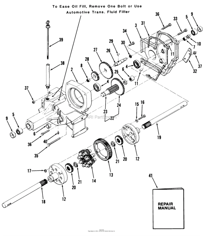

Tgalo 128 #4 Posted August 29, 2020 (edited) Yeah thats the strange thing, I found a picture on both Jacks and Toro's site but the transmission in the picture appears to be a manual trans. The only picture that makes sense is the hydrostatic picture. Shows a 108319 gasket which is the pump to case but thats it. Found this for my 418. Looks like the same thing and the case gasket is 108312 as you said, thanks Edited August 29, 2020 by Tgalo 2 Share this post Link to post Share on other sites
