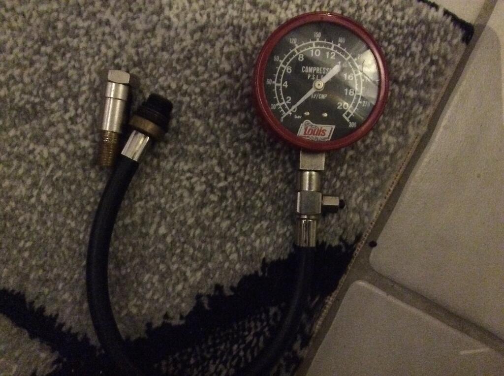

Tractorhead 9,217 #36 Posted September 12, 2020 The idea with water and dish soap to check on cold engine if it leaks is also my preferred Version. it show‘s lightest fails visible up, even on slow cranking if it was outside the Combustion chamber. I would suggesting to buy a cheap compression tester with a gauge. i purchase mine in a motocycle store when they have a Sale for just 5 Bucks. it comes with an adapter to fit in each motocycle sparkplug hole. it‘s a simple to use tool and very handy to check old engines about compression. Even a cheap compression tester is for that kind of Engines good enough, mine shows in PSI and KP/squarecentimeters to find out if the Engine is definitive able to run and shall load your Budget with not more than about 10$. it shows you quick if a rework of the engine is needed or if it shall run. A oil smoking Engine produces a lot of gunk as also allready mentioned before, that oil neboulous internally in combustion chamber can also be contaminated with some worn material , that was also possible to reduces the ignition quality on a sparkplug by shortening while combusting, it depends on how old the oil is. If the Oil is older, maybe an oilchange can reduce that contamination and this effect. Also a carbon in the combutionchamber over times (what i be sure it have internally) can broke free and clogging or even ruin the intake or exhaust Valve seat with minimal bypass pit‘s than the valve is unable to tighten right up, result of that can also be a too weak compression. Here a Fingertest say‘s nothing more than a bad estimation. I do on each of My machines after i purchased them a check about ground potential, after that mostly a rework on the Ground site. search for a good place ( i. Eg the Frame) and mount an unisolated Bolt on and path each ground with a seperate Wire to that ground potential point. So you can be sure, all systems have definitively the same potential. Another issues can be loosen screws on the carbmount or a defect Seal, where Air can bypass a way into engine as it didn‘t should. Remove the head and put on closed Valves an extreme thin oil onto ( diesel i. Eg.) This will show you if the Valveseats are tighten good enough. if you remove the head for check the Helicoil insert, you will be able to test that out. turn the engine in cumbustion stroke and put a few dribbs of diesel aside the valves until ther‘s a little drop in height all arround the valve. if it begin to pass between valve and valveseat it has to be redone, if the valve was tight, this dieselhill arround the Valve will stay for 2 minute at least. also a simply and cheap leak test Btw. if the head wasn‘t removed while inserting the helicoil a contamination of the combustionchamber can be also resulting in loose combustion pressure. 1 Share this post Link to post Share on other sites
tunahead72 2,640 #37 Posted September 13, 2020 Thanks for all your help with this, guys. I wasn't able to work on the tractor today, but I'll get back to it middle of next week and keep you posted. Thanks again! 2 Share this post Link to post Share on other sites
