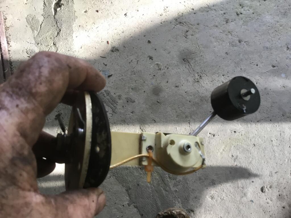

JoeM 10,318 #4 Posted August 27, 2020 Zek I am working on a 522xi now and I could take the sender out and compare it to a 520H, let me know it that will help. 1 Share this post Link to post Share on other sites

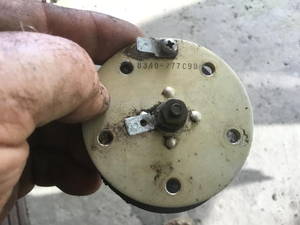

Zekepup 0 #7 Posted August 27, 2020 This is the gas sending unit I need for the 2002 520xi .Also is there a replacement temperature sensor for it too. The tractor goes to the red zone after just a few minutes . I just cleaned the motor removing as much tin work as possible with the engine in. It was not real bad,but no change in the temp gauge before or after.I just bought the tractor with 677 hours. Share this post Link to post Share on other sites

JoeM 10,318 #9 Posted August 28, 2020 (edited) That temp sensor maybe available from Kohler. research CH20 sensor comes up with this Kohler Part # 2441812S Temperature Sensor Not sure if it is the same as yours. this was the sender out of the 520H looks close Edited August 28, 2020 by JoeM Share this post Link to post Share on other sites

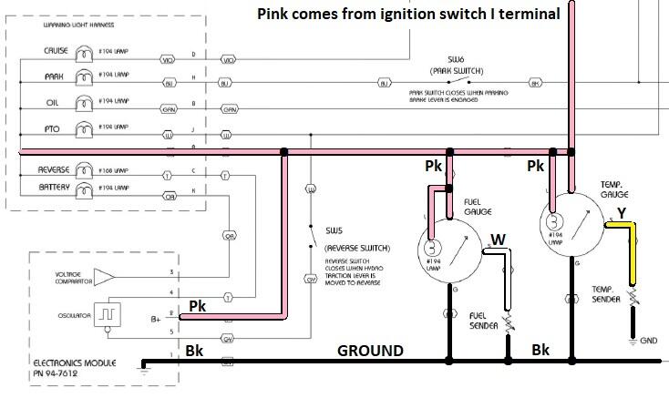

gwest_ca-(File Mod) 12,535 #10 Posted August 28, 2020 Were you also inquiring about the battery voltage monitor? Just noticed the voltage monitor, fuel gauge and engine oil temperature are all powered by the same ignition circuit. Perhaps the power supply for this circuit is compromised. Could also be the grounds for the gauges. Garry Share this post Link to post Share on other sites

gwest_ca-(File Mod) 12,535 #12 Posted August 28, 2020 Looks like there are 4 connections and a 10 amp fuse between the ignition switch "I" terminal and the diagram I posted. Garry Share this post Link to post Share on other sites
