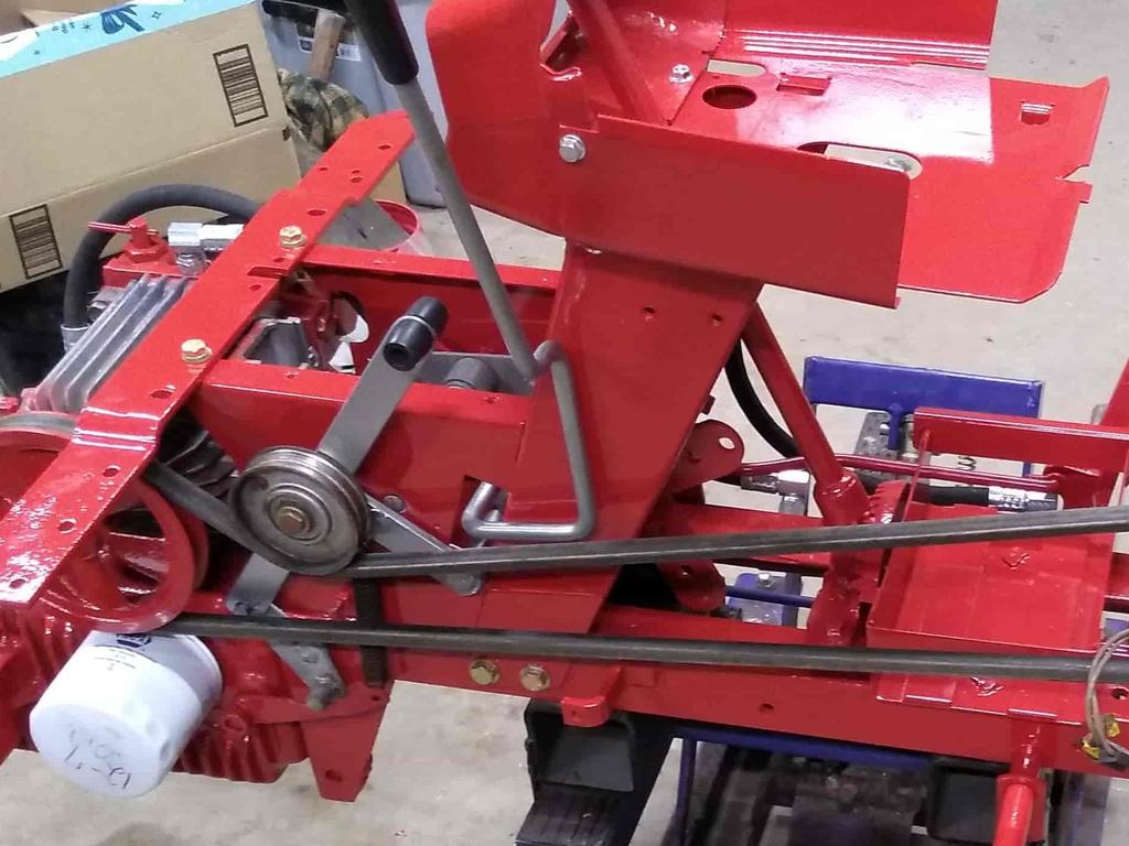

The Tuul Crib 7,354 #1 Posted August 27, 2020 (edited) I have been looking for these two springs for my charger. I've contacted A-to-Z tractors and I have Lincoln looking for them. I need the one for the parking brake and The other one that connects on the foot pedal brake. Any sources or where to find these springs would be helpful. Thanx Edited August 27, 2020 by The Tuul Crib Share this post Link to post Share on other sites

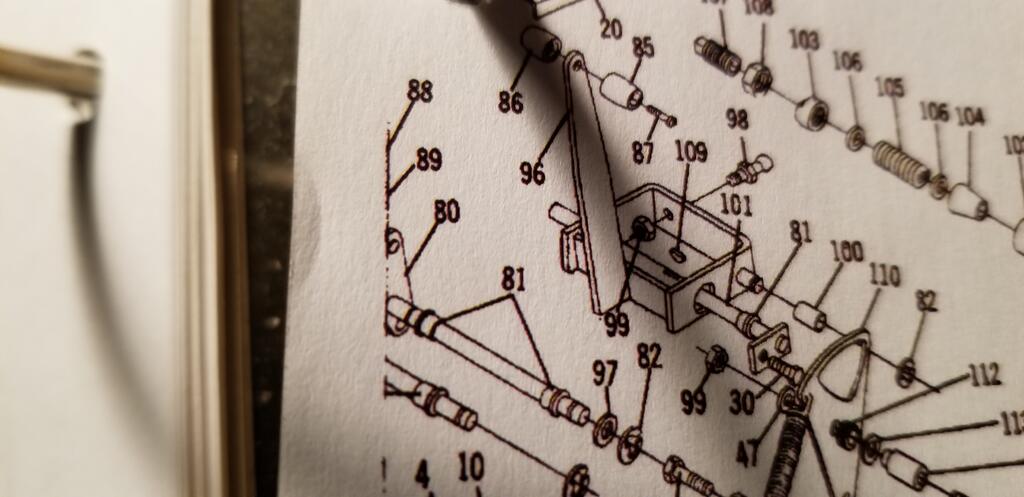

gt14rider 1,158 #5 Posted August 27, 2020 (edited) Motion control spring 1230 E-brake spring 9170 A-z shows 2 in stock Pat's small engs (psep.biz) has 9170, call on 1230 Edited August 27, 2020 by gt14rider Share this post Link to post Share on other sites
clueless 3,388 #6 Posted August 27, 2020 I have the 1230 spring NOS, if you need one I'll mail it to you. Chris Share this post Link to post Share on other sites
ebinmaine 78,288 #7 Posted August 27, 2020 48 minutes ago, gt14rider said: Motion control spring 1230 E-brake spring 9170 A-z shows 2 in stock Pat's small engs (psep.biz) has 9170, call on 1230 when you say e brake spring are you talking about the one that pulls the brake pedal back to position? Share this post Link to post Share on other sites
gt14rider 1,158 #8 Posted August 27, 2020 Part #82 9170 Part# 109. 1230 The parts brake down is for a gt 14 but charger 12 should be the same. 1 Share this post Link to post Share on other sites

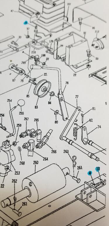

ebinmaine 78,288 #9 Posted August 27, 2020 8 minutes ago, gt14rider said: brake down is for a gt 14 but charger 12 should be the same Looks like the same setup. Not to hijack Randy's thread but the problem on my charger is that the brake pedal does not return to center.. I assume I'm missing some sort of spring. First hydro I've had so I'm not familiar with the setup. Share this post Link to post Share on other sites

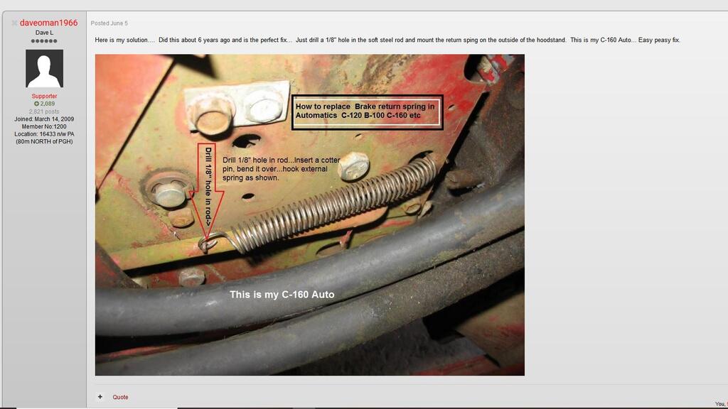

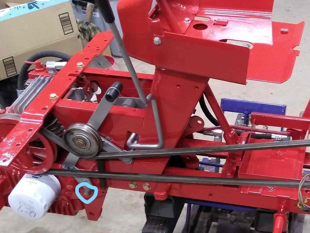

pfrederi 20,271 #10 Posted August 27, 2020 2 minutes ago, ebinmaine said: Looks like the same setup. Not to hijack Randy's thread but the problem on my charger is that the brake pedal does not return to center.. I assume I'm missing some sort of spring. First hydro I've had so I'm not familiar with the setup. The spring that pulls the pedal back is the one in the bottom pic above hooks into #110 It is WH #1230 Daveoman has an external fix in this pic. Hooking the correct spring inside is a PIA I have some springs I got from Mcmaster to use inside like 1230 you want one??? 1 1 Share this post Link to post Share on other sites
ebinmaine 78,288 #11 Posted August 27, 2020 2 minutes ago, pfrederi said: The spring that pulls the pedal back is the one in the bottom pic above hooks into #110 It is WH #1230 Daveoman has an external fix in this pic. Hooking the correct spring inside is a PIA I have some springs I got from Mcmaster to use inside like 1230 you want one??? I'd love one Paul. Thank you. I'll p.m. you my address. Shouldn't be as bad for me because the transmission is off at the moment. Share this post Link to post Share on other sites
pfrederi 20,271 #12 Posted August 27, 2020 5 minutes ago, ebinmaine said: I'd love one Paul. Thank you. I'll p.m. you my address. Shouldn't be as bad for me because the transmission is off at the moment. Even so you are going to want some really long needle nose pliers will send springs today or tomorrow 1 Share this post Link to post Share on other sites

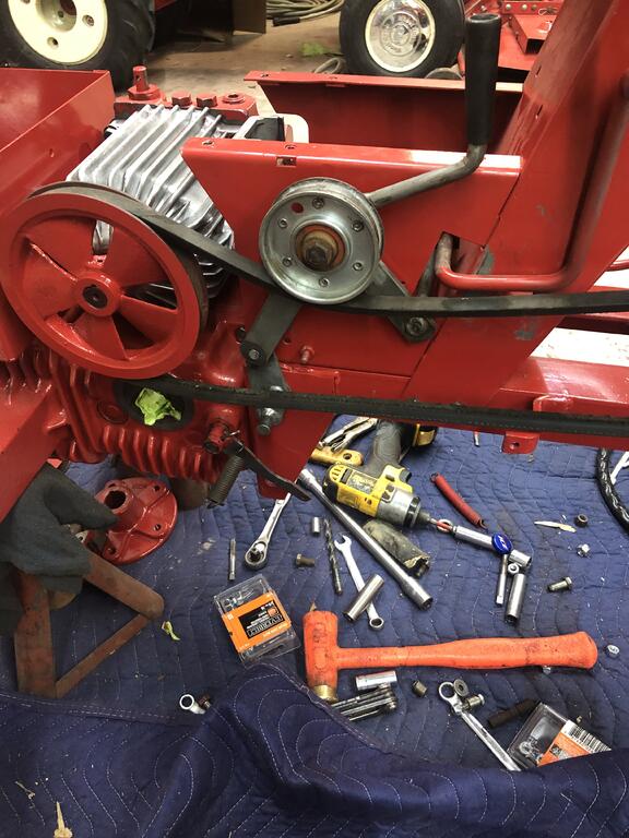

Achto 31,560 #14 Posted August 27, 2020 1 hour ago, ebinmaine said: when you say e brake spring are you talking about the one that pulls the brake pedal back to position? The E-Brake spring is the one in this picture. It holds belt tension on when the brake is released. Also the lower rocker shaft holds the E-brake lever down when the brake is in the release position. When the brake is set the rocker shaft pivots back and the spring pulls up on the E-brake lever to set the brake inside the transmission. 1 Share this post Link to post Share on other sites
ebinmaine 78,288 #15 Posted August 27, 2020 3 minutes ago, Achto said: The E-Brake spring is the one in this picture. It holds belt tension on when the brake is released. Also the lower rocker shaft holds the E-brake lever down when the brake is in the release position. When the brake is set the rocker shaft pivots back and the spring pulls up on the E-brake lever to set the brake inside the transmission. So mine is working properly. Takes a fair amount of gumption to pull up or down on that lever and I'm wondering if there's some linkage worn somewhere. I'll check it out. 1 Share this post Link to post Share on other sites
Achto 31,560 #16 Posted August 27, 2020 1 minute ago, ebinmaine said: Takes a fair amount of gumption to pull up or down on that lever and I'm wondering if there's some linkage worn somewhere. I'll check it out They usually don't move real easy. It's kind of a pull up & pivot back motion to get the two arms attached to the handle to swing correctly. 1 Share this post Link to post Share on other sites

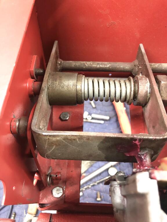

pfrederi 20,271 #19 Posted August 27, 2020 27 minutes ago, ebinmaine said: So mine is working properly. Takes a fair amount of gumption to pull up or down on that lever and I'm wondering if there's some linkage worn somewhere. I'll check it out. Check the bottom of the pin (Blue Circle. The arm can wear a deep groove in it increasing the resistance/friction 1 1 Share this post Link to post Share on other sites

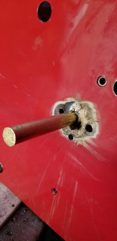

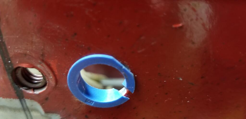

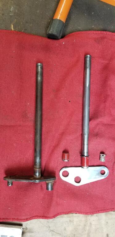

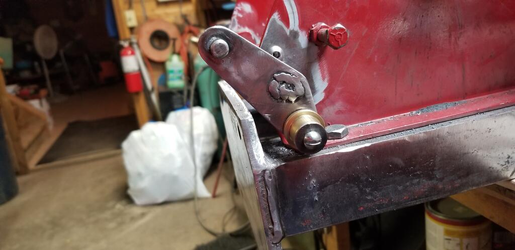

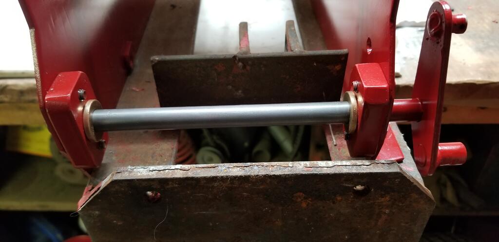

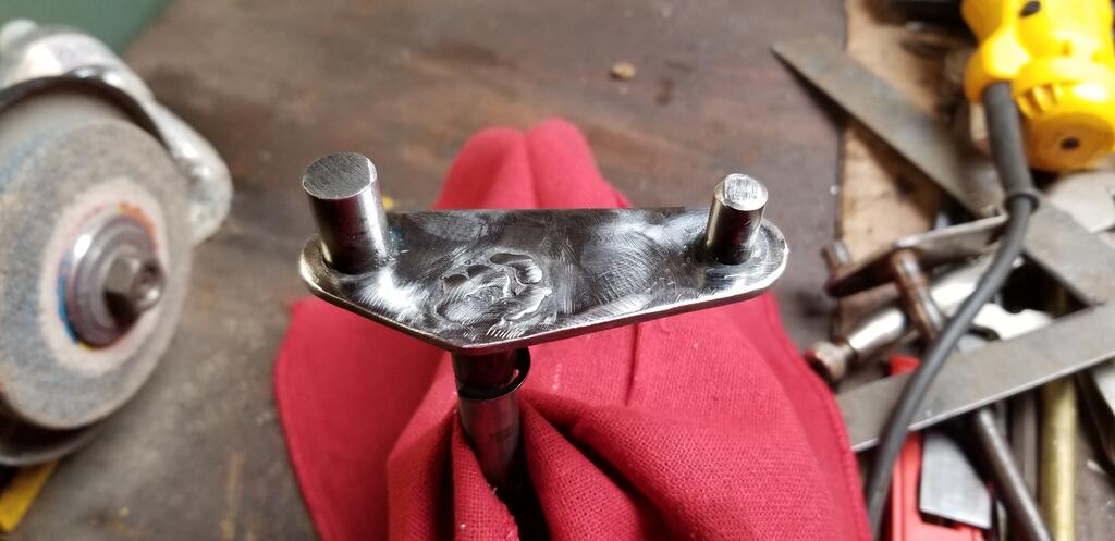

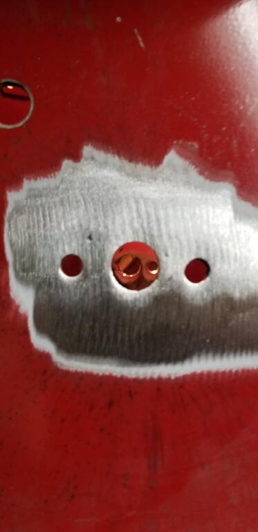

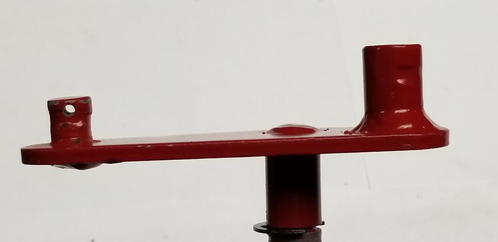

gt14rider 1,158 #20 Posted August 28, 2020 Made some new pivot pins, going to try bronze bushing on e-brake side of pivot. Made bushings for rods. Welded eggshaped holes in side plates, added grommets to the holes 2 Share this post Link to post Share on other sites
oliver2-44 11,401 #21 Posted August 28, 2020 Looks good. It’s the little things like this repair that stretch out a restoration, but really makes the difference. 1 1 Share this post Link to post Share on other sites
