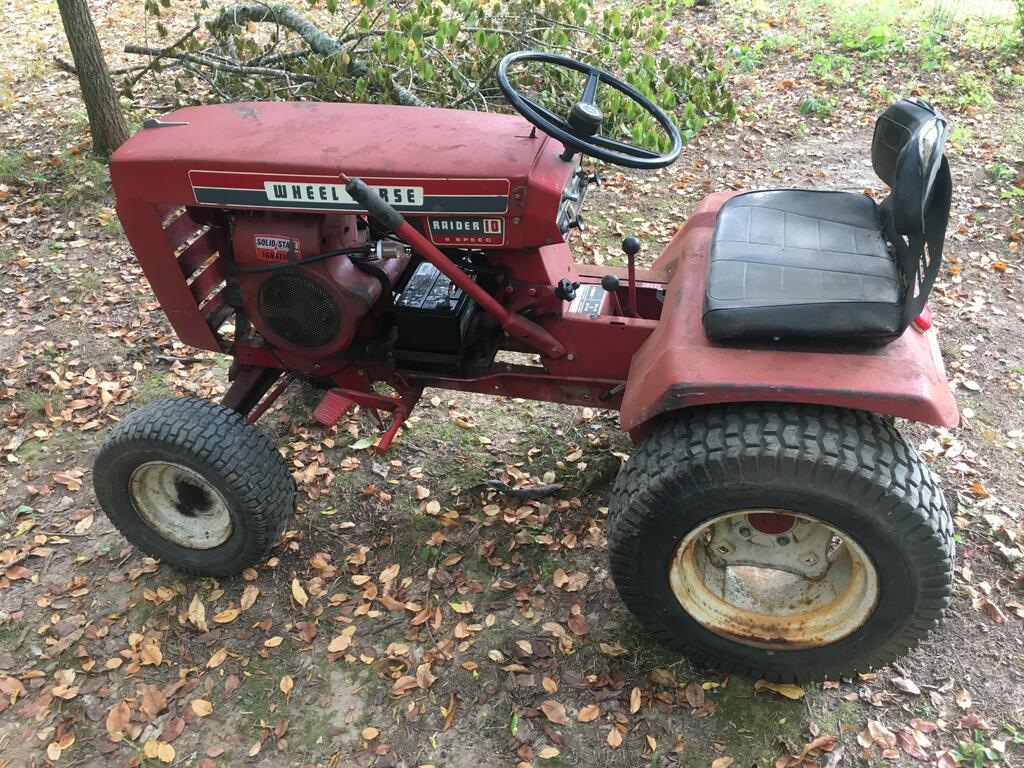

ebinmaine 80,772 #11 Posted August 26, 2020 Nice looking rig. Should have limited slip differential. Great work tractor. 1 Share this post Link to post Share on other sites
stevasaurus 23,857 #12 Posted August 26, 2020 Nice horse...depends on the year for a Raider 10 to have the LS Transmission. 2 Share this post Link to post Share on other sites
Joe Skeeterbomb 18 #13 Posted August 26, 2020 It says “Uni Drive” on the housing. I’m not sure what you mean by “LS” transmission. Share this post Link to post Share on other sites
stevasaurus 23,857 #14 Posted August 26, 2020 What is the model # and/or year of your horse.?? 1 Share this post Link to post Share on other sites
pfrederi 21,184 #15 Posted August 26, 2020 (edited) 8 minutes ago, Joe Skeeterbomb said: It says “Uni Drive” on the housing. I’m not sure what you mean by “LS” transmission. Some transaxles had 10 pinion limited slip (LS) differentials Edited August 26, 2020 by pfrederi 1 Share this post Link to post Share on other sites

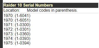

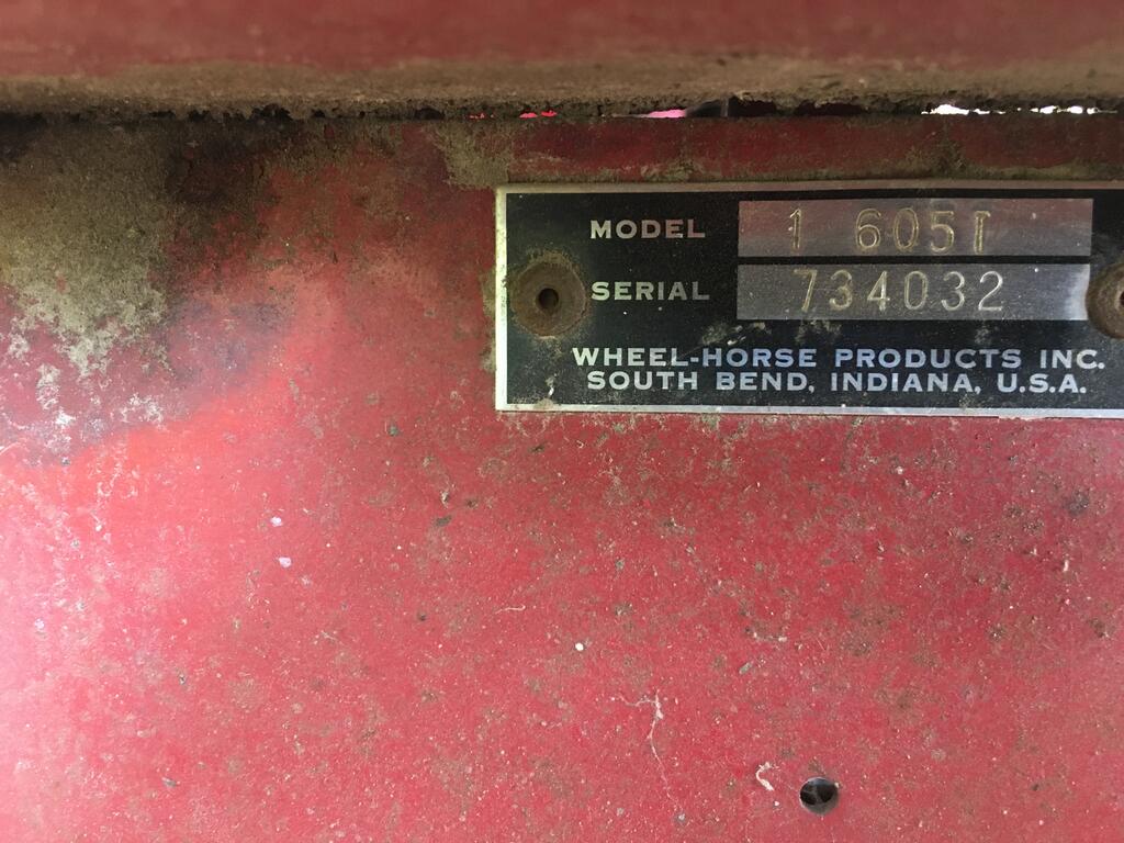

Joe Skeeterbomb 18 #16 Posted August 26, 2020 Not sure the year, picked it up out of St Louis. Previous owner lost a bolt on the deck carrier arm and parked it several years ago. I got it, the deck, cultivators and what he called “Hiller”; supposed to make mounds to plant potatoes. 2 Share this post Link to post Share on other sites
bottjernat1 2,197 #17 Posted August 26, 2020 (edited) It is a 1970 model Edited August 26, 2020 by bottjernat1 1 Share this post Link to post Share on other sites
bottjernat1 2,197 #18 Posted August 26, 2020 Here you go joe! 1 1 Share this post Link to post Share on other sites
Joe Skeeterbomb 18 #19 Posted August 26, 2020 Thanks to everyone! You all are awesome! 2 Share this post Link to post Share on other sites
bottjernat1 2,197 #20 Posted August 26, 2020 Just now, Joe Skeeterbomb said: You are awesome! I know thanks. LOL All kidding aside we love to keep this old iron going. Thanks for keeping the hobby going!! 2 Share this post Link to post Share on other sites
pfrederi 21,184 #21 Posted August 26, 2020 Yours has the limited slip differential. 2 2 Share this post Link to post Share on other sites

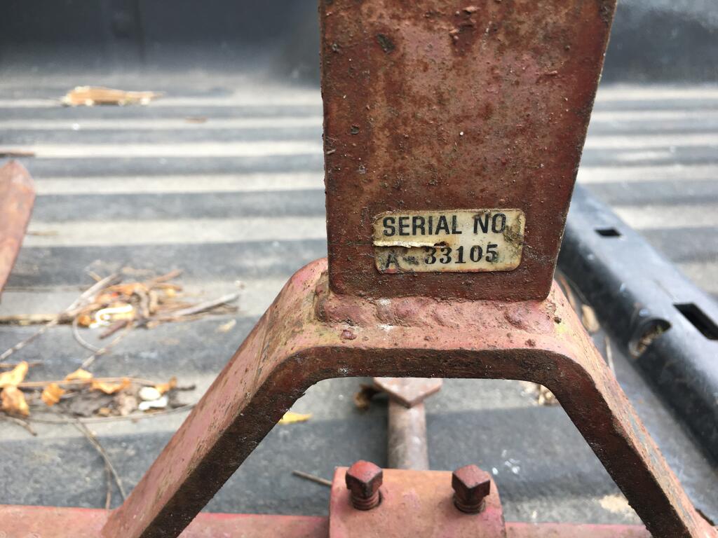

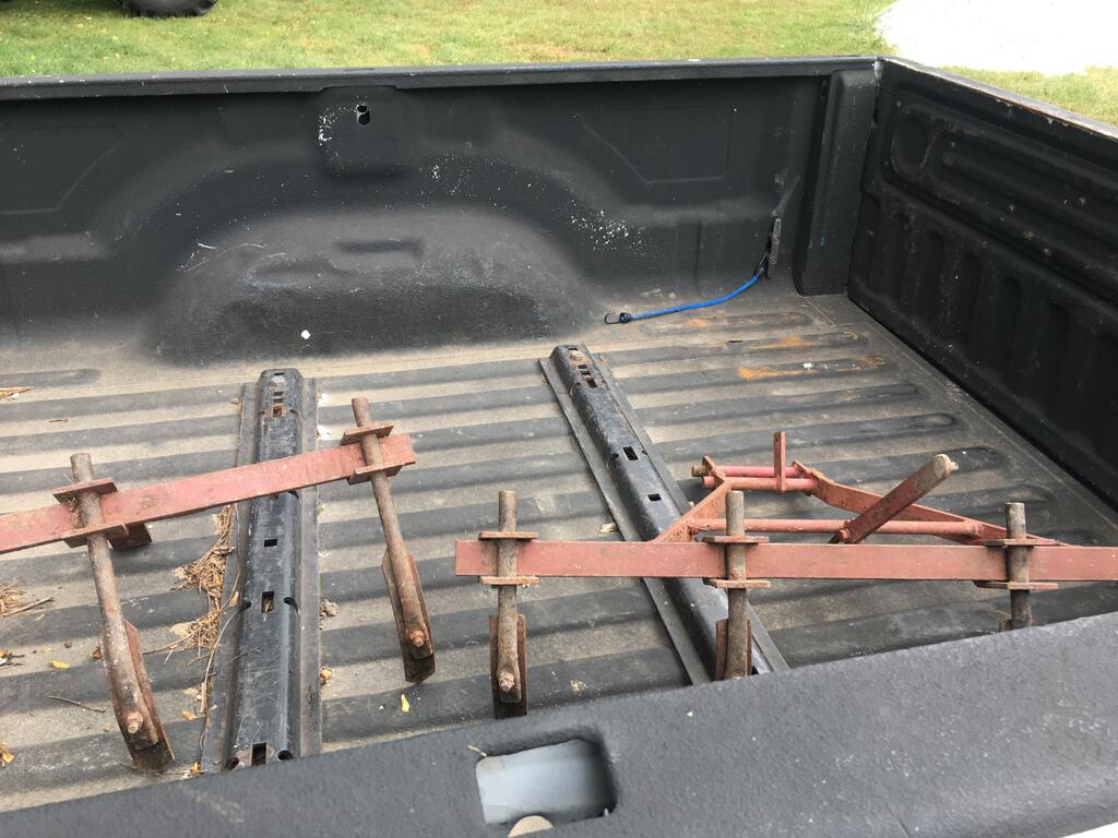

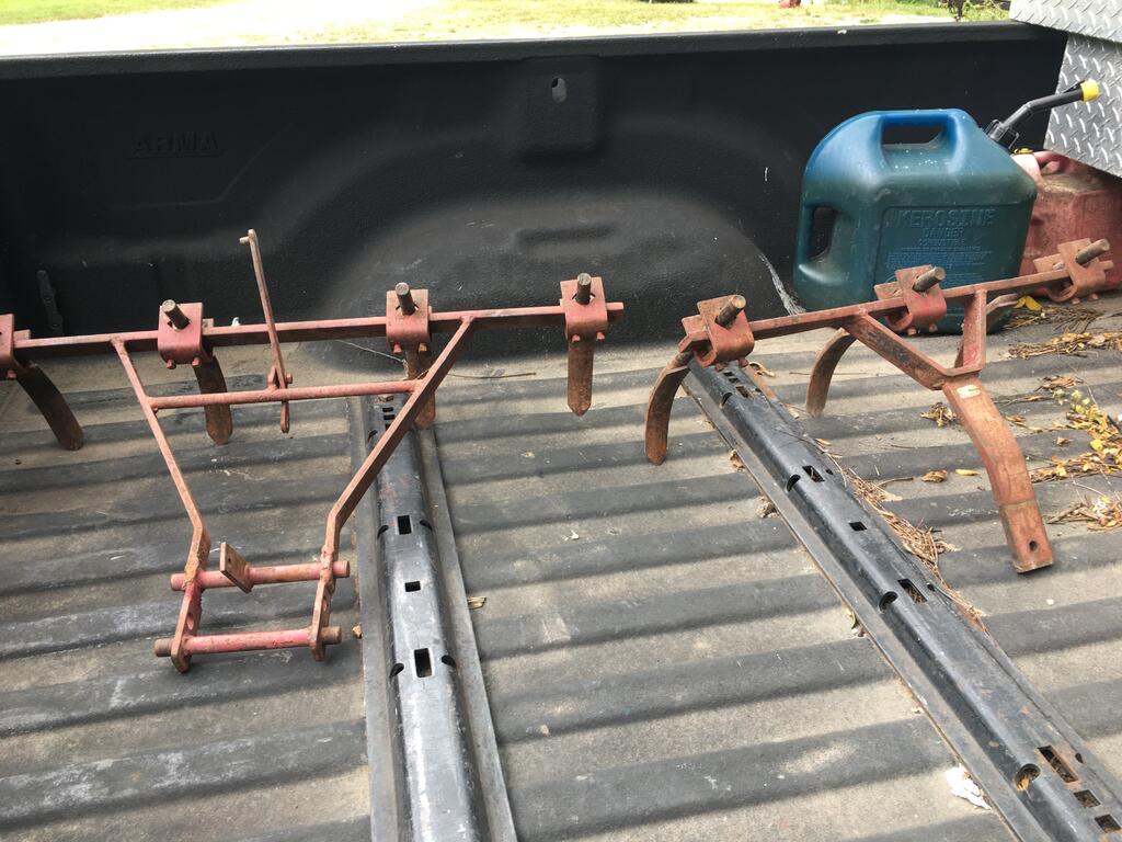

ebinmaine 80,772 #24 Posted August 26, 2020 53 minutes ago, Joe Skeeterbomb said: I got it, the deck, cultivators and what he called “Hiller”; supposed to make mounds to plant potatoes Can you post pictures of the cultivators and the hiller with any model numbers or stickers? Share this post Link to post Share on other sites
Joe Skeeterbomb 18 #25 Posted August 26, 2020 This is what I got... 1 Share this post Link to post Share on other sites
