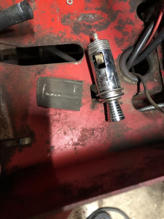

WHNJ701 4,173 #1 Posted August 25, 2020 My commando 6 had the cigarette lighter at one time I guess, how did they mount the socket? If someone can post a pic of the bracket. I have a lighter and socket from a 65 mustang that will fit in the hole Share this post Link to post Share on other sites
BHunter 1,702 #2 Posted August 25, 2020 Hi Jason, my 877 doesn’t use a bracket. It just has this dark sleeve piece that acts like a nut on the back side of the dashboard. It has teeth that grab the back of the dash. 3 1 Share this post Link to post Share on other sites
echris 1,426 #3 Posted August 25, 2020 17 minutes ago, BHunter said: Hi Jason, my 877 doesn’t use a bracket. It just has this dark sleeve piece that acts like a nut on the back side of the dashboard. It has teeth that grab the back of the dash. That's the only way I've even seen one mounted, car or tractor. The threaded outer sleeve, which on some lighter sockets acted as the ground. Better off with a dedicated ground wire. I lit a lot of cigarettes using the WH lighters at the dealership back in the day. My boss liked when I pointed out when a tractor in for service had a dead lighter. UPSELL!!! 2 3 Share this post Link to post Share on other sites

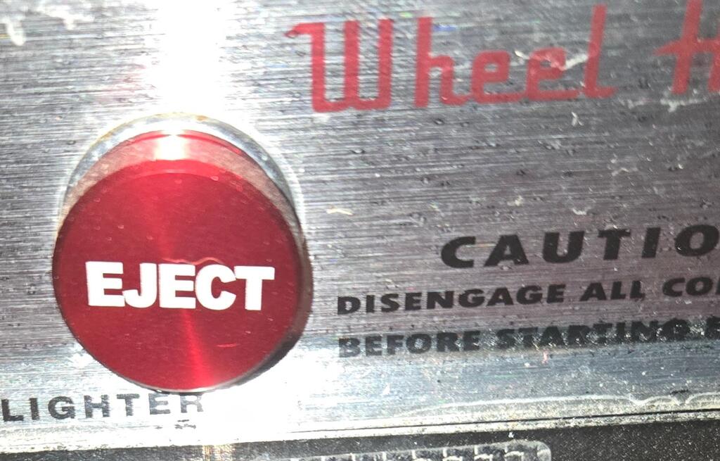

kpinnc 18,851 #13 Posted December 24, 2025 I never even wired mine up, and decided to just make a funny instead... 1 2 Share this post Link to post Share on other sites
