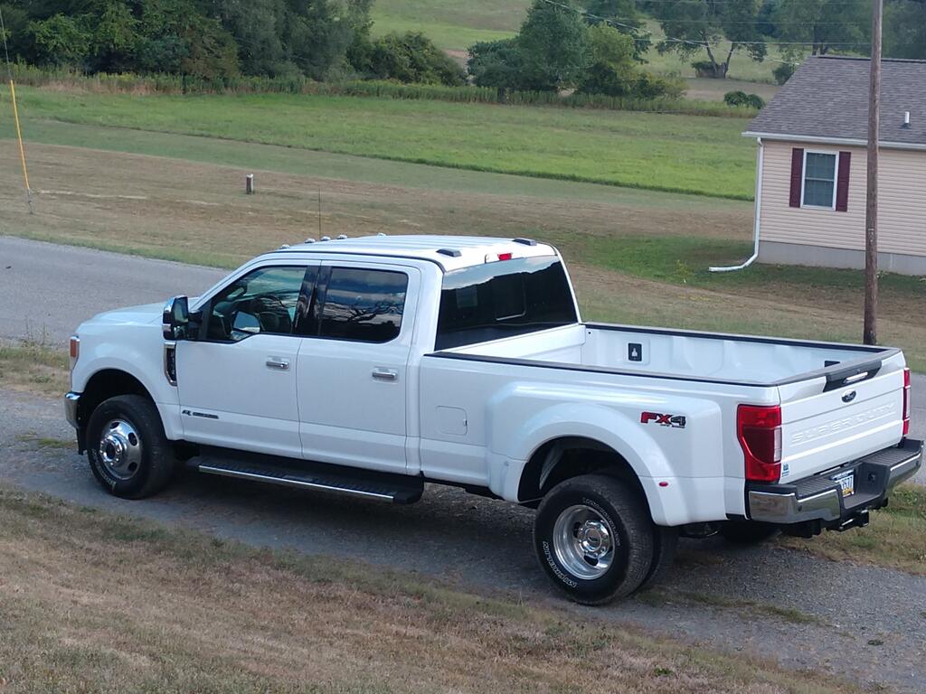

briankd 833 #3 Posted August 25, 2020 hope you have good luck with that ford diesel . we have 6 of them at my work and they all at the ford dealer more than they are at our shop always check engine lites and derated 1 Share this post Link to post Share on other sites

troutbum70 858 #5 Posted August 25, 2020 The specs on the camper calls for a 50 amp service, my brother feels if we only ran one ac at a time could probably do it on 30 amps. One ac is 15,000 btu and the other is 13,000. I would like to put a cummins onan 5.5k in it but right now thats wayout of the budget. 55 minutes ago, briankd said: hope you have good luck with that ford diesel . we have 6 of them at my work and they all at the ford dealer more than they are at our shop always check engine lites and derated Time will tell Brainkd, I know a couple guys that have running the ford 450's and power strokes for a few years now delivering campers around the country and they have had any major complaints. 1 Share this post Link to post Share on other sites

ZXT 2,401 #7 Posted August 25, 2020 Nice looking truck! I'm not much of a Ford guy, but I do like the looks of their new 3/4 and 1 tons. Plus you can't argue with the power of a 6.7. 1 hour ago, briankd said: hope you have good luck with that ford diesel . we have 6 of them at my work and they all at the ford dealer more than they are at our shop always check engine lites and derated What engines do they have in them? If they're 6.0 or 6.4's then I can understand them being in the shop all of the time. They are junk without a bunch of work. I haven't heard anything bad about the 6.7. As for your generator, A 50A RV service will be your standard 4 wire 240v range plug. The RV will have 240v to it, but the appliances are (for the most part, not always) 120v and will run off of one leg or the other. Biggest thing is knowing if it is a 120 or 240v air conditioner. Amperage pulled by the AC will be considerably less at 240v as opposed to 120. There are adapters out there to allow you to plug a 50a 240v RV plug into a 30A 120V receptacle. You'll just need to be selective on what appliances you run to keep your amp draw low enough. 1 Share this post Link to post Share on other sites
troutbum70 858 #8 Posted August 25, 2020 15 minutes ago, ZXT said: Nice looking truck! I'm not much of a Ford guy, but I do like the looks of their new 3/4 and 1 tons. Plus you can't argue with the power of a 6.7. What engines do they have in them? If they're 6.0 or 6.4's then I can understand them being in the shop all of the time. They are junk without a bunch of work. I haven't heard anything bad about the 6.7. As for your generator, A 50A RV service will be your standard 4 wire 240v range plug. The RV will have 240v to it, but the appliances are (for the most part, not always) 120v and will run off of one leg or the other. Biggest thing is knowing if it is a 120 or 240v air conditioner. Amperage pulled by the AC will be considerably less at 240v as opposed to 120. There are adapters out there to allow you to plug a 50a 240v RV plug into a 30A 120V receptacle. You'll just need to be selective on what appliances you run to keep your amp draw low enough. Okay tnx I will know more about the camper and its components when I get the hitch in the truck and get the camper home. 2 Share this post Link to post Share on other sites

Redneckdavis 308 #11 Posted August 25, 2020 Just my 2¢ . . One thing about the power is, it is possible and very easy to overload generators. Then like they said ,over heat, fire, shorten life of electrical components blah blah blah. Bad things. I'd go for the 2 good size ones or one really big one. If you had the money for $100k of truck and trailer, don't cheap out on powering it. As for the truck, if it does give you trouble and it's out of warranty. First thing I'd do is remove all the DEF crap. Big brother and the dealership frowns upon it, but there is plenty of professional shops that will do it and make it look like it never happened. All of that emissions junk is like they did in the 70s by taking all the v8s and choking them down to half power and efficiency. 1 Share this post Link to post Share on other sites
troutbum70 858 #12 Posted August 25, 2020 I have a 8 year 125,000 bumper to bumper warranty on it so won't worry about failures for a while, hopefully over the eight years we can work out the bugs. 1 Share this post Link to post Share on other sites

lynnmor 8,651 #15 Posted August 25, 2020 Last week while camping my 2011 6.7 Ford had a check engine light for the first time. The DEF heater is a known problem and a special warranty on that issue took care of it for free. Google Onan 4500i to see just another Chinese clone generator. Onan stooped to this low level and IMO is no longer a reputable company. Campgrounds have severely abused outlets because of numerous clueless people plugging in and out while under load. These burnt outlets can have high resistance causing heat and destruction of your plug. Here is what we do: Turn off the breaker. Plug in and out multiple times to wipe the contacts. We use a short pigtail as a sacrificial connection. We always have a voltmeter permanently plugged in. Turn on the breaker and check voltage, if under 108 then AC cannot be run. Turn on AC and again check voltage, if now too low, turn it off. For voltage below 110, we use a Hughes autoformer. Be aware that voltage can vary greatly as other campers increase and decrease their loads. I have seen 99 volts when the Friday night crew rolled in and fired up the AC, water heater and cooked dinner. That was the day years ago that I decided to buy an autoformer. 1 Share this post Link to post Share on other sites

troutbum70 858 #20 Posted August 26, 2020 Lynnmor I am not famillar with the Hughes Autotransformer I will research it. Acto I am sure their plan is for the consummer to have to buy to 3500's. Sqounk I did plan to run fridge on gas to reduce needed amps. Made a trip to the buckeye and back with the pickup today 500 mile round averaged 23 mpg, less than a thousand miles on the power stroke at this point so not real bad. This one has 4.10 gears with the 10 speed tranny, at 70 mph tach hangs around 1750 with 17 inch tires. 1 Share this post Link to post Share on other sites
