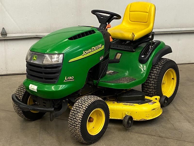

RED-Z06 2,680 #36 Posted December 21, 2021 The Deere G110 vs L130 G110..23" rear tires, 54 deck, K66 trans, 25hp $3700 L130..same chassis, 22" rear tires, 48" deck, 23hp. K46 trans. $2600 Which one sold more? 1 Share this post Link to post Share on other sites

Snoopy11 5,719 #38 Posted December 21, 2021 Just now, RED-Z06 said: The Deere G110 vs L130 G110..23" rear tires, 54 deck, K66 trans, 25hp $3700 L130..same chassis, 22" rear tires, 48" deck, 23hp. K46 trans. $2600 Which one sold more? People have a perception that the cheaper John Deere is capable of just as much as the more expensive John Deere... because it is a John Deere. See the circular reasoning there? But if that was true... why would there be more expensive models...? Further, I hate to speak collectively, but most people would PREFER a transmission that "doesn't need to be serviced" ...less work, less maintenance, less money. And they think ...It will last forever... Whatever... Don Share this post Link to post Share on other sites

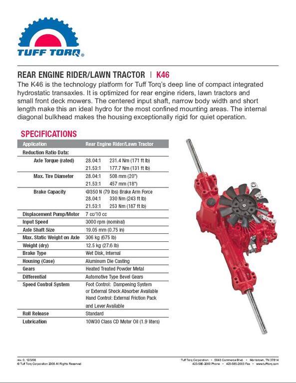

Snoopy11 5,719 #41 Posted December 21, 2021 I think it says enough that the K46, according to Tuff Torq, is "light duty" Don Share this post Link to post Share on other sites
RED-Z06 2,680 #42 Posted December 21, 2021 27 minutes ago, Snoopy11 said: People have a perception that the cheaper John Deere is capable of just as much as the more expensive John Deere... because it is a John Deere. See the circular reasoning there? But if that was true... why would there be more expensive models...? Further, I hate to speak collectively, but most people would PREFER a transmission that "doesn't need to be serviced" ...less work, less maintenance, less money. And they think ...It will last forever... Whatever... Don To the buying public...which one has the robust medium duty transmission capable of years of use...and which one has the weakest hydro offered by that same manufacturer...knowing that one is 14hp and one is 23hp. 1 Share this post Link to post Share on other sites
RED-Z06 2,680 #43 Posted December 21, 2021 Yall are going to get me banned for posting pics of junk in the WH forum 🤣 1 1 Share this post Link to post Share on other sites
Snoopy11 5,719 #44 Posted December 21, 2021 5 minutes ago, RED-Z06 said: To the buying public...which one has the robust medium duty transmission capable of years of use...and which one has the weakest hydro offered by that same manufacturer...knowing that one is 14hp and one is 23hp. Common sense say: but the 130 is 10 years newer!!! Experience tells me that the 176 is 10 years older, and still going strong for a reason... Don Share this post Link to post Share on other sites

RED-Z06 2,680 #48 Posted December 22, 2021 Interesting...the K46 is only rated for up to 20" tires on its low geared model and up to 18" tires on its high geared model and lists for rear engine riders and lawn tractors. Share this post Link to post Share on other sites
