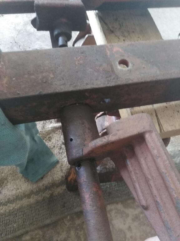

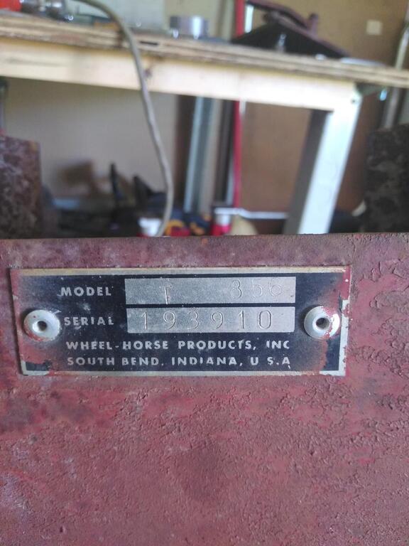

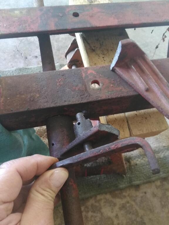

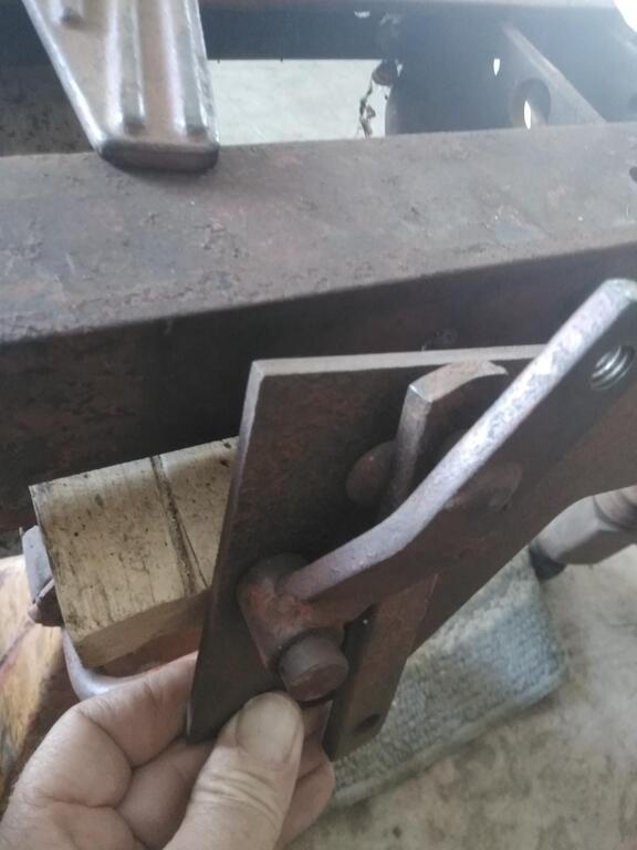

Goofball65 13 #1 Posted August 22, 2020 ok, this is what i have WH model# T 856, Serial #193910 . all i know about it is suposibaly all orginal and rare. wondering if anybody can tell me more on ? i have and if parts are available for it ,. in process of restoring it and do to weather some of the parts are siezed." footpegs drivebelt pedel and pully assesmbly" and in process of tring to freeup I broke the dang things "stupid me" . will try to upload pics soon, just need to figure out how . Any info would be much appreciated. I have the pedal casting # 4239-B4 . also need all other parts that go with it, Share this post Link to post Share on other sites
Pollack Pete 2,273 #2 Posted August 22, 2020 I believe your tractor is a 1966 Model 856.Should be a Kohler 8 horse engine.Penetrating oil is your friend when working on tractors or anything else left out in the weather.Also a fair ammount of patients. 1 1 Share this post Link to post Share on other sites

rmaynard 17,575 #5 Posted August 22, 2020 (edited) PB Blaster works great on rusted, frozen parts. Don't use WD-40. It does not penetrate. Be patient. There are a lot of parts for that model that are interchangeable with other models. It's not rare. Most models early on were only made 1 year. 8 HP 5 Manual 6 1966. 857 is the same, just the 7 is from 1967. Edited August 22, 2020 by rmaynard 3 Share this post Link to post Share on other sites

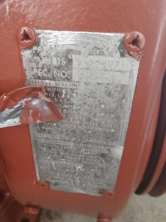

stevasaurus 23,846 #8 Posted August 22, 2020 Actually...the 8 = engine horse power 8hp Kohler k-181s the 5= electric start the 6= 1966 Model # T856 The transmission is a Wheel Horse #5053 3 speed uni-drive. 3 forward and 1 reverse. These are not rare, but they are the favorite for many of us members. The 1965, 1966, and 1967s are considered Short Frame, Square Hoods. 4 1 Share this post Link to post Share on other sites
