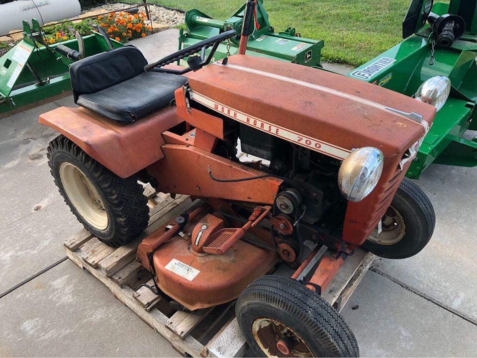

305 381 #1 Posted August 20, 2020 700 Workhorse , found it on Facebook Marketplace and it's now home after a 175 mile round trip road trip. my plan is to ditch the incorrect engine and install a good H70 i happen to have ready. then grease it up , fix a few things, sharpen the blades and go mow. tires seam to hold air i'm kinda diggin' the headlights , they may stay! 10 9 Share this post Link to post Share on other sites
stevasaurus 23,846 #2 Posted August 20, 2020 That appears to be in nice shape. Headlights look great...their great for plowing snow...to see and be seen. 1 Share this post Link to post Share on other sites
prondzy 3,890 #3 Posted August 20, 2020 Good Find!!! Share this post Link to post Share on other sites
Tractorhead 9,217 #4 Posted August 20, 2020 Nice condition, looks in good shape. 👍 Share this post Link to post Share on other sites
Terry M-(Moderator) 2,325 #5 Posted August 20, 2020 Nice!👍 Share this post Link to post Share on other sites
bottjernat1 2,197 #6 Posted August 20, 2020 She is a beauty!! Share this post Link to post Share on other sites
The Tuul Crib 7,354 #7 Posted August 20, 2020 Sssaaawweeet!!!! Those lites are cool! Share this post Link to post Share on other sites

D_Mac 9,339 #9 Posted August 20, 2020 Nice tractor. I love the headlights.. wish they were bigger !! Share this post Link to post Share on other sites

Sparky-(Admin) 26,304 #11 Posted August 20, 2020 Nice old machine with perfect patina. I’m digging those lights , would be a real plus if they still work! Share this post Link to post Share on other sites
SylvanLakeWH 32,457 #12 Posted August 21, 2020 NICE! Share this post Link to post Share on other sites
Greentored 3,221 #13 Posted August 21, 2020 That’s a clean machine! Definitely keep the lights too! Share this post Link to post Share on other sites
953 nut 69,146 #14 Posted August 21, 2020 Wonderful survivor, I wouldn't change a thing. Get it running and enjoy it as is. Share this post Link to post Share on other sites
