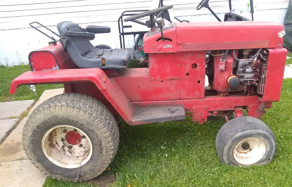

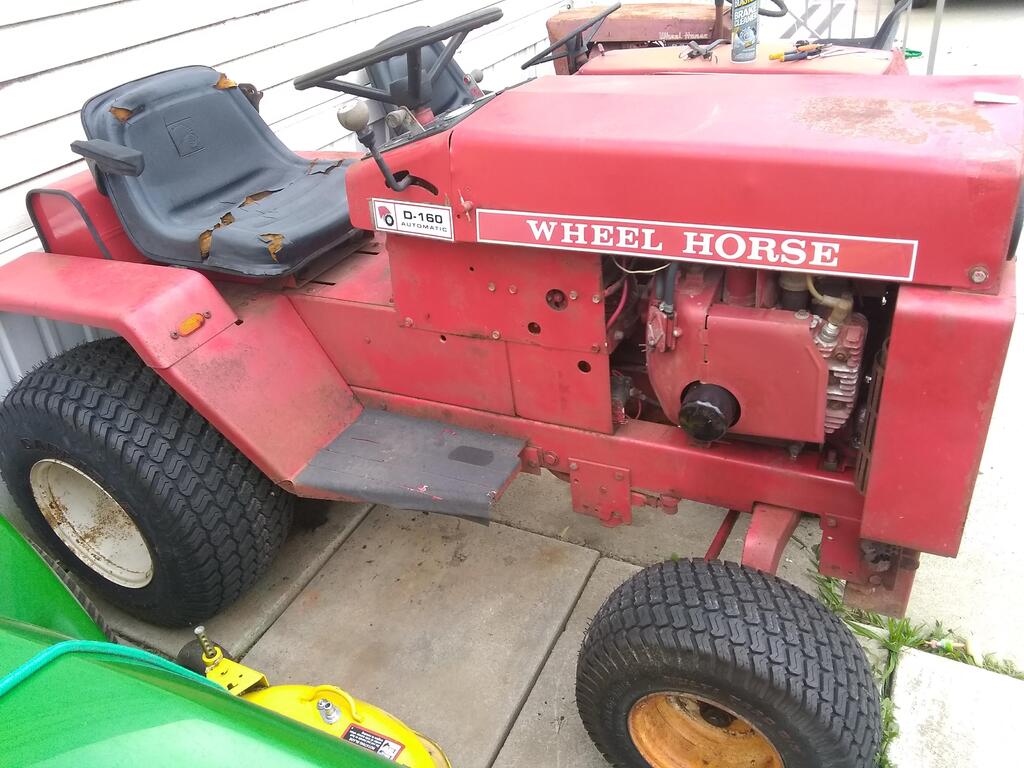

bottjernat1 2,197 #14 Posted August 20, 2020 (edited) 5 minutes ago, Mark Bartlett said: Yep, pays to be a good neighbors! Agreed also pays to just be a nice human being. I have gotten a few things given to me over the years and i return the favor all the time. This was given to me by a guy in ohio 4 hours away from me one way. Here is my before and after photo so far what ive did. Edited August 20, 2020 by bottjernat1 2 Share this post Link to post Share on other sites
