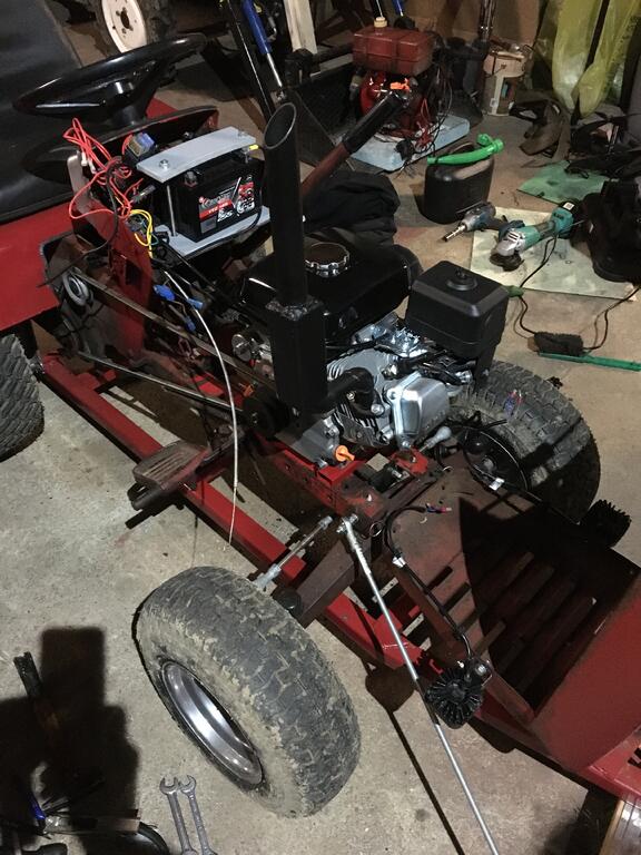

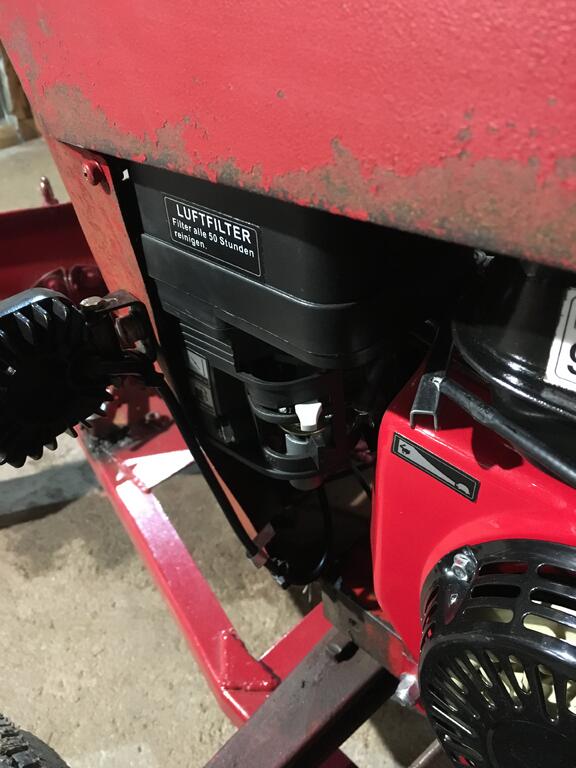

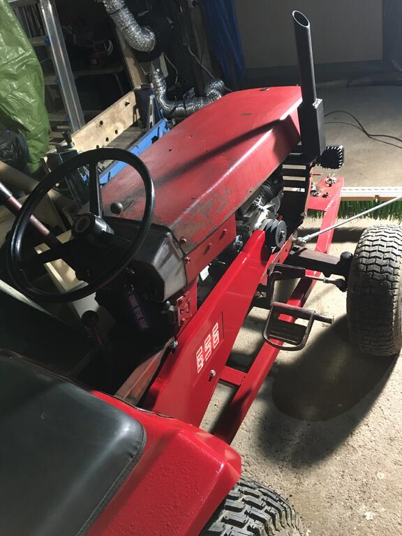

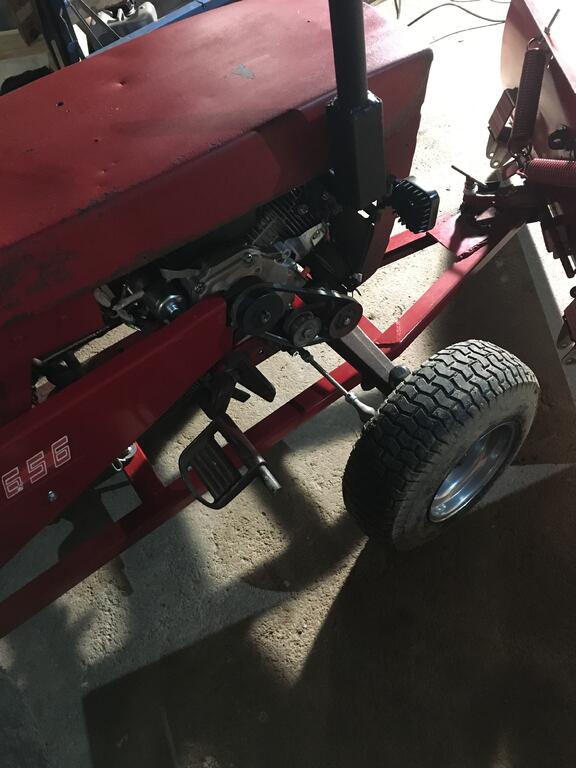

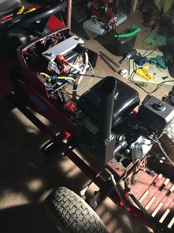

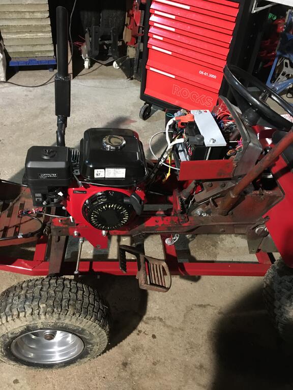

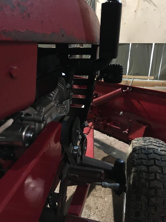

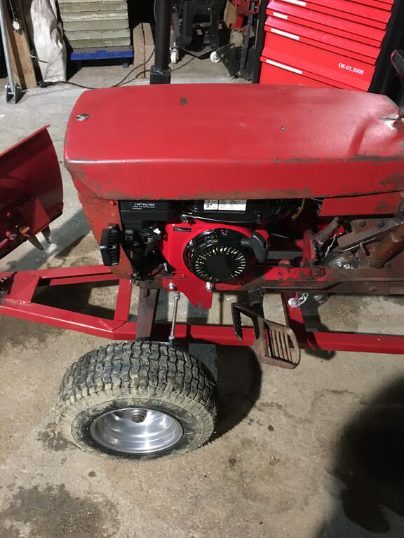

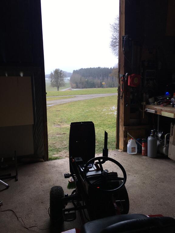

Tractorhead 9,217 #176 Posted March 14, 2021 Finalize the mechanics for function. Rewire the Tracta. Except the choke bowden, to use it there is a lot more rework needed, so i decide to use just the throttle lever and let the choke lever unused for now. Than i remount the Beltcover, to see if it fit‘s. looking not too bad, few smaller issues must be solved but it works so far. Time for a Testride if all works as it should. a gently scratching can be heared, because of the idlerpulley is scratched a little on the Beltcover. while grinding down, i try to remove scratching parts. Beltcover gap now is ok about gap but must be rewelded. one seam reduces the gap too much, so i have to grind it down. I decide to keep it now as it is for the next Workrides. After that i will next time finalize the Beltcover and repaint it. The Engine itself performs nice and grunt even under load in a cool Deep pipe Sound. and at least it appears to be a little faster than before. So far - Engine Swap is successfully done except few cosmetic issues. 3 3 1 Share this post Link to post Share on other sites
Pullstart 71,288 #177 Posted March 14, 2021 That looks nice under there Stefan! How’s it sound pulling a load? 1 Share this post Link to post Share on other sites
Tractorhead 9,217 #178 Posted March 14, 2021 5 minutes ago, pullstart said: That looks nice under there Stefan! How’s it sound pulling a load? Will do the next day‘s a Vid with the Tiller, but at 30 deg and Wet Soil it makes today no sense.. Share this post Link to post Share on other sites

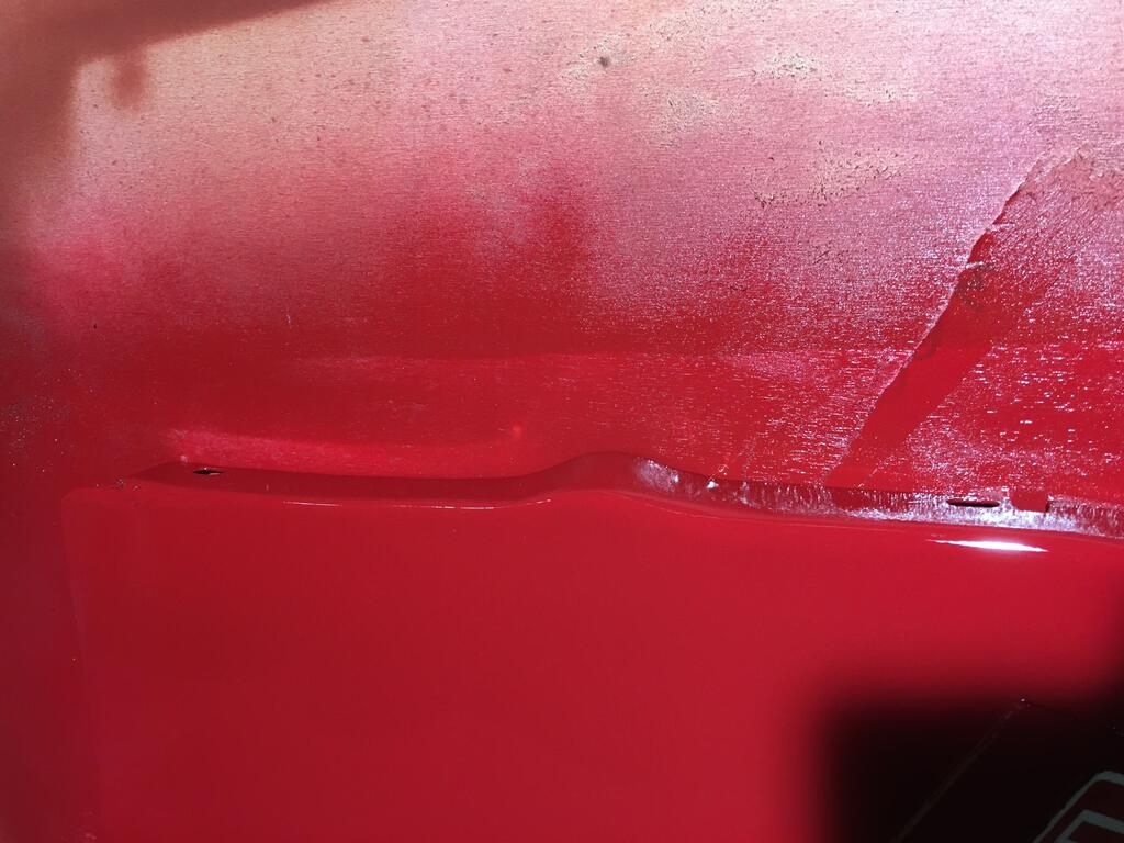

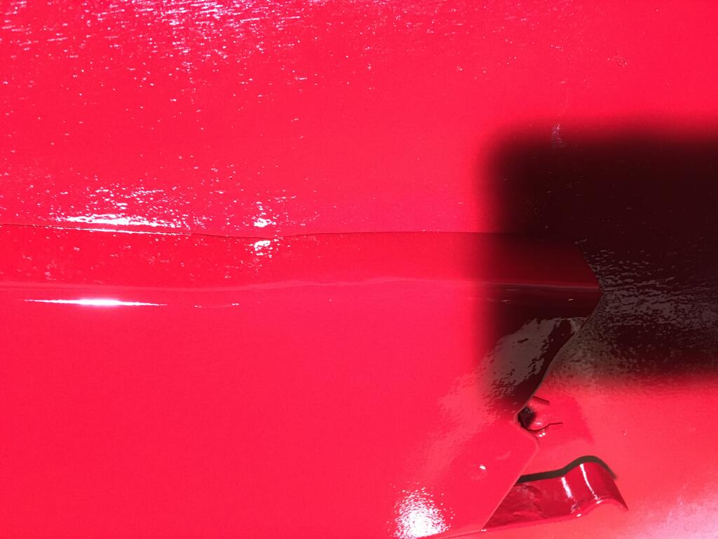

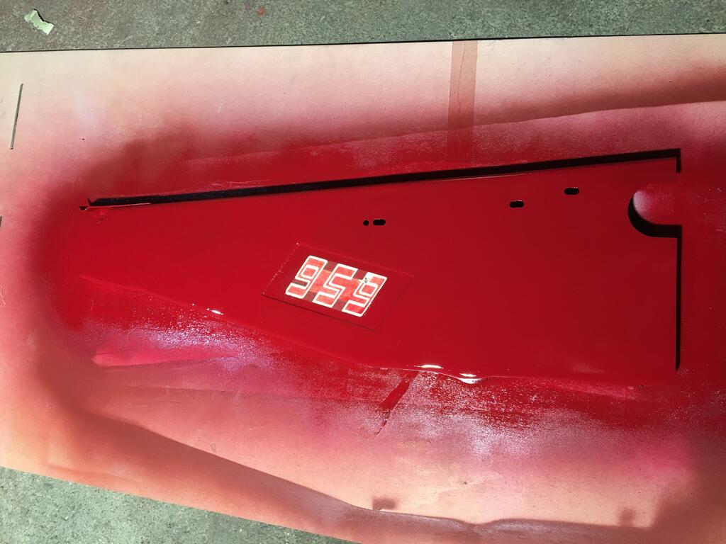

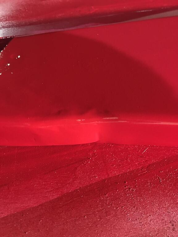

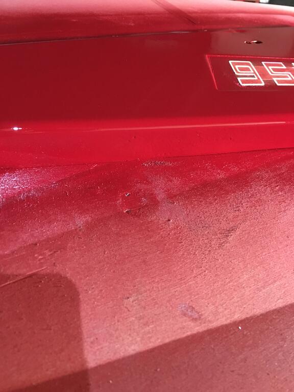

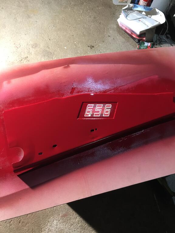

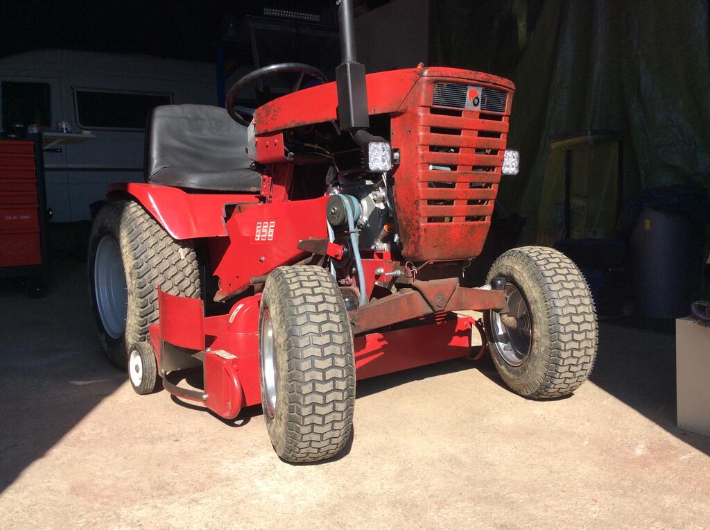

Tractorhead 9,217 #179 Posted March 17, 2021 Another try of the Paintjob. while the last idea - working with Sprayfiller - was a Disaster, i grinded the whole Sheetmetal down to bare Metal. My idea was to Solder tinning the Edges from the Welding to give them a smoother surface, but i thinkering again about it and feared, that my Original Sign can melt maybe. Yes, i have a new one from Terry, but i like to keep it‘s original as long as possible. So i decided to grind it just down, leave the pittings what it have in it and primer than Paint it. The result is ok, not perfect in detail, but better than i feared and Rustprotection is definitely given. She is a old Lady, that make me some pittings and dull’s acceptable. No photofinish, but acceptable for me. - aaaaand the Original Sticker can still stay on her. 1 2 Share this post Link to post Share on other sites
Lee1977 7,785 #180 Posted March 17, 2021 How did you make the tractor larger? You went from a 656 to a 959. Old German Trick! It won't work on any I have, makes them smaller. 3 Share this post Link to post Share on other sites
Gregor 4,848 #181 Posted March 17, 2021 52 minutes ago, Lee1977 said: How did you make the tractor larger? You went from a 656 to a 959. Old German Trick! It won't work on any I have, makes them smaller. "Only through the eyes of Minolta" 2 Share this post Link to post Share on other sites
Tractorhead 9,217 #182 Posted March 17, 2021 It is a something about 9 HP Upgrade Engine...😂😂😂😂 but yes, you‘re right, the flip told the true... 😂😂😂 looks like it is now a Sleeper too..😎✌️👍 Share this post Link to post Share on other sites
Tractorhead 9,217 #183 Posted March 17, 2021 Beltcover is on thinkering about a mule drive let‘s do a Test - maybe tomorrow 3 Share this post Link to post Share on other sites

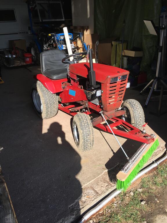

Tractorhead 9,217 #185 Posted March 20, 2021 Because of unstable and cold weather, i just fo tests today while cleanup the Shed floor. Firstly i moved one of the big Tableposts half meter aside, Jacked the table few mm up remove the Post and set it back down on it‘s final place, to get a greater clearance of at least 1meter for Snow blower and Tiller behind under the Table. Than i tried a today‘s arrived Tacho i ordered on the Bay. That thing is pretty cool and have an exchangeable Battery CR2023 for its own power. To pickup the Ignition just a simple clamp will be hooked on Sparkplug connector or somewhere on the cable. It shows in idle 1450 -1480 RPM and on max. Throttle 3760 RPM. The sound and the showed rpm correspondends. The refresh rate is 0,5 sec. Cool gadget, thinking to implement it permanently, but it is a LCD type, what doesn‘t fit‘s the age of my Horse. While cool down the Engine i decide to make few Detailed pictures of how the Engine fits. on the Enginemounts with closed hood the gap between Airfilter and the hood. Seems i made no mistakes on planing ahead. even the Exhaust have perfect gap, not too close, not to far away. one issue i found today, i need a shorter drive Belt maybe 1“- 1,5“ the Spannerpulley sometimes still scraps a bit on the Beltcover, but all other works as it should. if i gently press the Clutch pedal 4-5 mm the Pulley stops scratching permanently. 7 Share this post Link to post Share on other sites

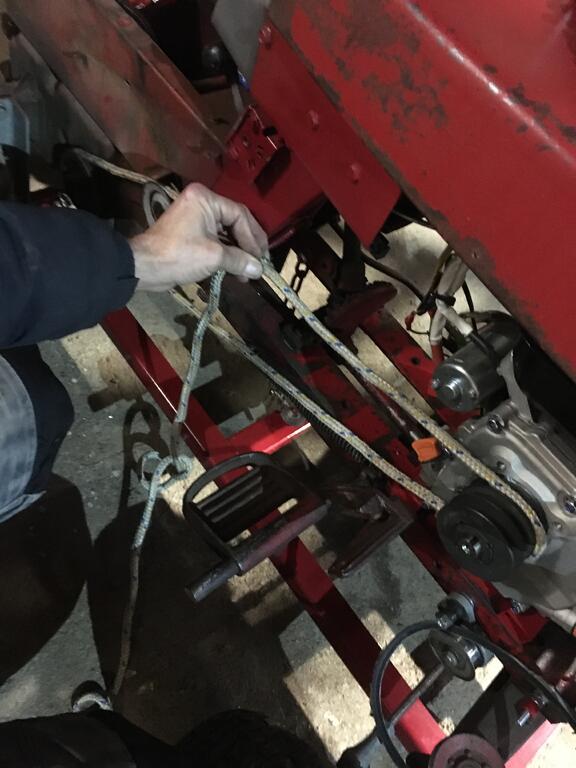

ebinmaine 80,757 #186 Posted March 21, 2021 15 hours ago, Tractorhead said: shorter drive Belt maybe 1“- 1,5“ 1" would likely be enough. Seems from my experience it takes very little variance to make the proper changes. Nice work on the engine change Steve. I understand the logic of the tach. It's neat to see the rpm. I wouldn't want the new style on an old tractor. There are 2" round tachs that have been modified. I'd like to have one as well but I don't know of one that's "plug and play" for a 60 year young single cylinder engine. 1 Share this post Link to post Share on other sites
Tractorhead 9,217 #187 Posted March 22, 2021 On 3/21/2021 at 10:57 AM, ebinmaine said: 1" would likely be enough. Seems from my experience it takes very little variance to make the proper changes. Nice work on the engine change Steve. I understand the logic of the tach. It's neat to see the rpm. I wouldn't want the new style on an old tractor. There are 2" round tachs that have been modified. I'd like to have one as well but I don't know of one that's "plug and play" for a 60 year young single cylinder engine. Belt measurement how i learned.... Few day‘s ago a idiot tried to crack Kati‘s beloved Car „ the Sleeper“ Because of this happens i was today shortly with the sleeper at a friend who is a bodywork plumber. He kept it and will fix it - that‘s definitely not a Work i can do to much damages. The good thing was - the idiot who tried to crack the car open, fails. The bad thing was - he make a lot of damage in the A- pillar and damaged it‘s structure i wish to catch this idiot in a dark night .... 😎 only we two.... However my heart goes wide open after i see such a pretty nice Car there. 2 2 Share this post Link to post Share on other sites

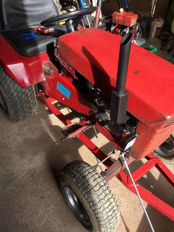

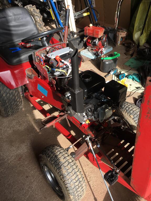

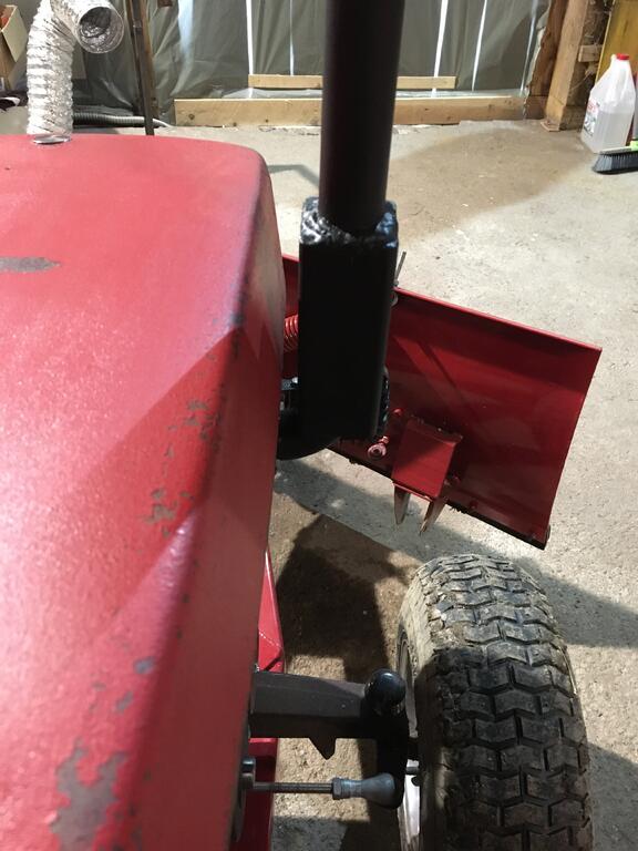

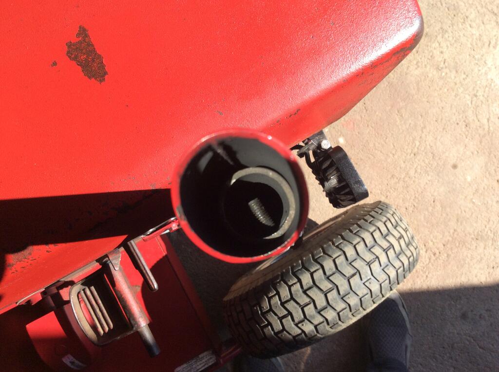

Tractorhead 9,217 #199 Posted April 4, 2021 After some rework, the Horse did make yesterday it‘s first Mowjob.😎 it run‘s like a charme, the predator has plenty of power overhalf the 1800RPM. below it seems it rapidly looses some power, but it works for me. i only disagree with the church pipe sounding Exhaust, so i calculated a lot arround and try the equations to bring into a solution. I made a Silencer as precalculated and give it a Try. to be honest i made 4 different, and chooses the best for my preferred RPM‘s or better Frequency range. from idle to full throttle i have a spread of 3000 Hz, that is the goal to silence. At the beginning i started with a 97dB on the driver Seat, a Value, the Motor manufacturer have fixed. i tried it more silence but with the same or even better Power. the Testride while mowing yesterday was a completely Success. at Full throttle i only reached 86 dB on driverseat, more than 10dB less than Factory and a more mellow Sound. 73A01983-DE44-46D7-9F4A-DBCB3AD299AA.MOV Here is a view to the silencer in the Exhaust. while looking for some material in the Shed, i found an older Piece from a past Project and get some stupid ideas... It‘s a Smart Turbocharger from a 3 cyl. engine a little reworked what i put on my Quadbikes Engine some moons ago. With racing fuel 100 octane and some mods there where several funny rides, not the safest, but who cares.. 😂 Found also the old electric Oilpump and few other things are laying arround. Ughhhhh - some stupid ideas hit my mind... So i ordered a set of stronger Valvesprings - just in case.... it‘s allway‘s better to have, than to need - ya know 😎 4 Share this post Link to post Share on other sites
