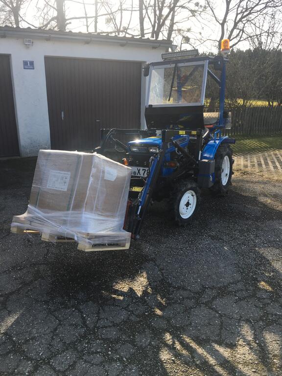

Tractorhead 9,217 #151 Posted February 5, 2021 I put a Message on the Mailbox written with thick black edding 3000 so that he can see it. leave my number in case of. at 11:30 the driver call‘s me - i‘m here, where is the machine to unload? i told him i give his Company the advice to call half hour before arrive. out of the Office and a quick race home. - new personal record normally a ride takes 27min nail it in 8... 😎 So fired up the Iseki to unload the Palette . The palette Fork was a blast and work like a charm, i just wasn‘t able to steer, lift and make a Video together. i know i have to learn that quick... 😇 The driver was also unable to make a Pic while unloading, i just see his thump on the lens... 😂 but i have at least a pic after unload.. however... back into Workshop and a fast lurking, yap all is fine and well deliverd. here is it unboxed in compare to the Plowshield. - yap it‘s not a Huge one - only 56cm Workwidth but it was that dang cheap, so i be fine with it. Because it‘s made for an 5 HP Engine i think it maybe can reworked to be used with the 656. firstly mount all parts so far to see what i must rework on it. first thing that was a nogo was the Drive shaft. a completely housed Star connector no suitable for me on the horse. unscrewed and a grab to the grinder... To make it usable for my purposes i develop the idea to cut the housing at 2,5cm and free up the Star. Done- after this was a Success i tried my Pulley Collection to see wich one will maybe Fit. i found a 67mm one for a Taper but this is too small and i’m sure it get too much friction, so i have to enlarge the pulley but no other Options here for now. ok, search another Pulley with ( measured diameter on mine was 63mm *2,3) will be something arround 144-160mm in diameter. why not 3? I don‘t like to run it continousely on Full throttle and if the 656 is not really powerful enough i think i try it on a Hydraulic Motor on the 212 Horse. search for a other pulley that fit my needs. 5 Share this post Link to post Share on other sites

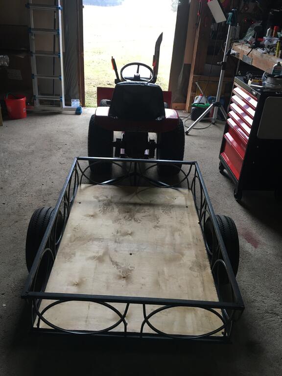

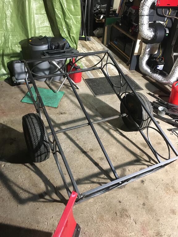

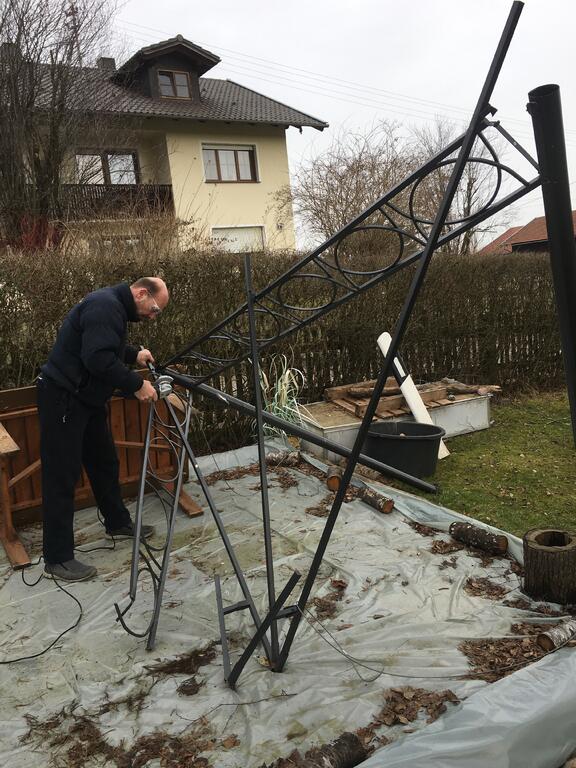

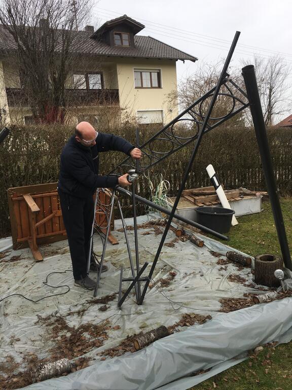

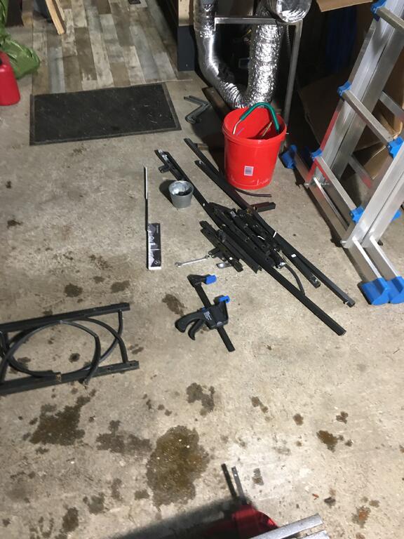

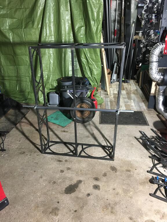

Tractorhead 9,217 #152 Posted February 6, 2021 Removed today the fracts of the Pavillion what is collapsed these Day‘s. while i removed the Tarp and see the pure Metalfragments, i developed a crazy Idea to dump that Metalscrap... No, i wan‘t trash it - ya know a Brainfree didn’t Dump any Metal. I doubt it will be strong enough for it’s repurpose, but however ok, Cut it in estimated usable Parts, than i bring them into the Workshop and sort them out. good things aside, rest in the trashbox, preparing the Rest to further repurpose. When all was precutted i see it is not the Strenght as it appears, but hopefully Stiff enough to last few months. I will just know that when it‘s finished, so fireup the Welder and ditch the things together i have in Mind. Things will not perfect aligned, so it‘s just a quick and dirty built project to waste time and see if and how it works. Built a superlight Trailer for the Wheelhorse with it‘s old original front tyres. Tadaaaaa. built an Axle out of a 3/4“ cutted Pipes and a 3/4“ u Steel and drilled a hole in the ends for a fixing Clip. Fit‘s - cool So it maybe a Wheel Horse huh, the Tyres tells it.. 😎 It just needs a Wooden plate as bottom and than we will see, if and how long it lasts. i don‘t believe it lasts long, but however, it was funny to build. nice few hours project to rework scrapmetal. 2 9 Share this post Link to post Share on other sites

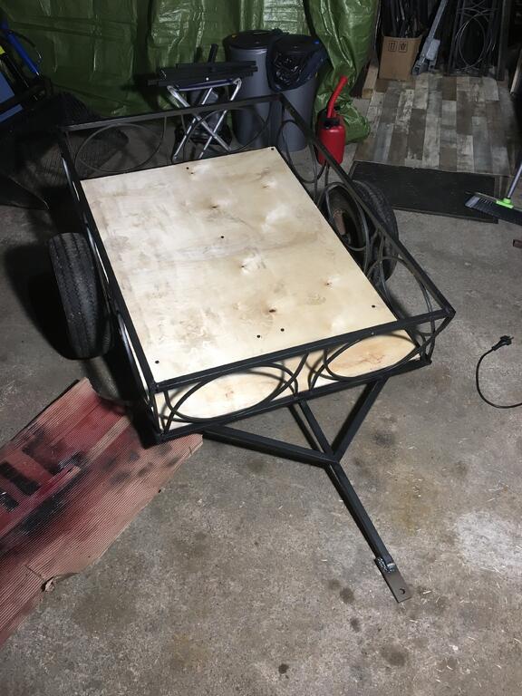

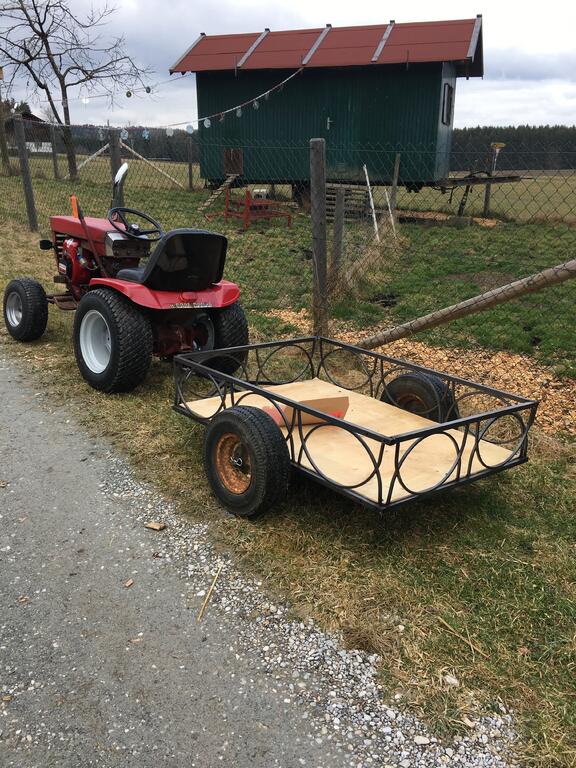

Maxwell-8 4,371 #153 Posted February 6, 2021 1 hour ago, Tractorhead said: It just needs a Wooden plate as bottom and than we will see, if and how long it lasts. i don‘t believe it lasts long, but however, it was funny to build. nice few hours project to rework scrapmetal. It looks more then strong enough to me. I mean, you can't fill it whit wet sand, so i will be just fine. Saving the planet and saving the wallet! WIN WIN situation! 3 Share this post Link to post Share on other sites

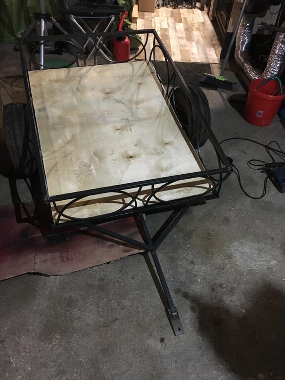

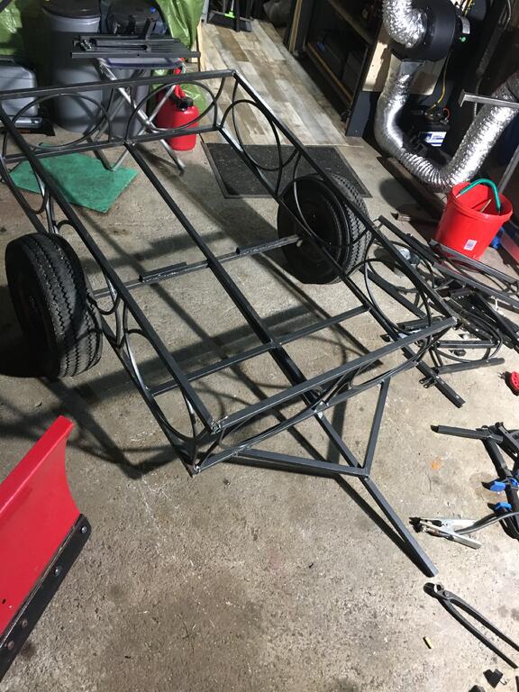

Tractorhead 9,217 #154 Posted February 6, 2021 @Maxwell-8 It appears Stronger than it is. this whole Metalstructure is just 0,75mm thick Except the Axel U Profile, that is 2mm strong. That is not much, but i will later improve the side edges to each other by Angleirons to enstiffned it. Actually it carries easy my 80 Kilos only on the Structure itself and with a Bottom and stiffned Edges i think it can carry about 100-150Kilos. Just the drawbar must be made stronger than. but we will see. So far i be pleasured even it becomes only a Garden Art 1 1 Share this post Link to post Share on other sites
ebinmaine 80,760 #155 Posted February 6, 2021 22 minutes ago, Tractorhead said: @Maxwell-8 It appears Stronger than it is. this whole Metalstructure is just 0,75mm thick Except the Axel U Profile, that is 2mm strong. That is not much, but i will later improve the side edges to each other by Angleirons to enstiffned it. Actually it carries easy my 80 Kilos only on the Structure itself and with a Bottom and stiffned Edges i think it can carry about 100-150Kilos. Just the drawbar must be made stronger than. but we will see. So far i be pleasured even it becomes only a Garden Art I'm over 120 Kilos so I'll come over and test it for you. 1 2 Share this post Link to post Share on other sites
Tractorhead 9,217 #156 Posted February 6, 2021 25 minutes ago, ebinmaine said: I'm over 120 Kilos so I'll come over and test it for you. You‘re allway‘s Welcome Bro. A mug full of hot Coffee is awaiting you 👍 1 1 1 Share this post Link to post Share on other sites

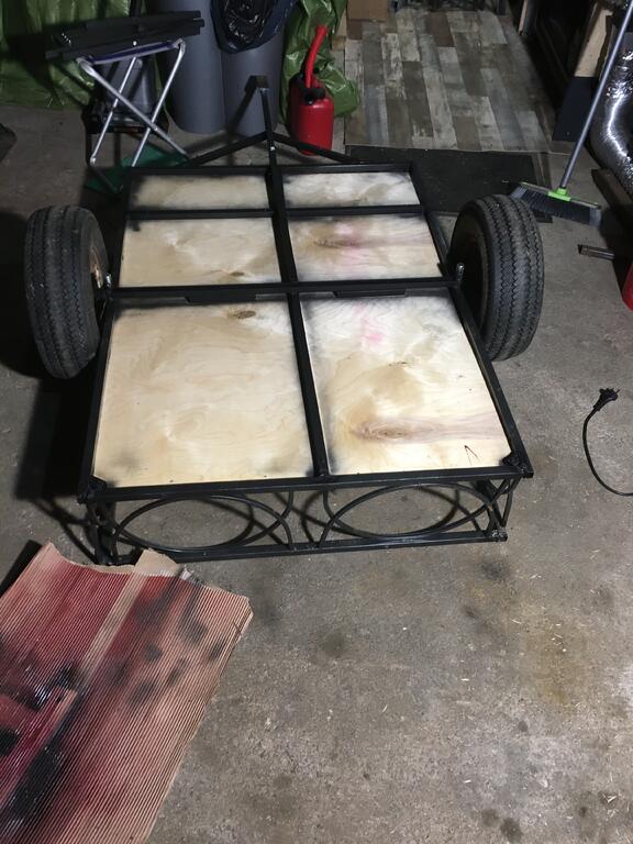

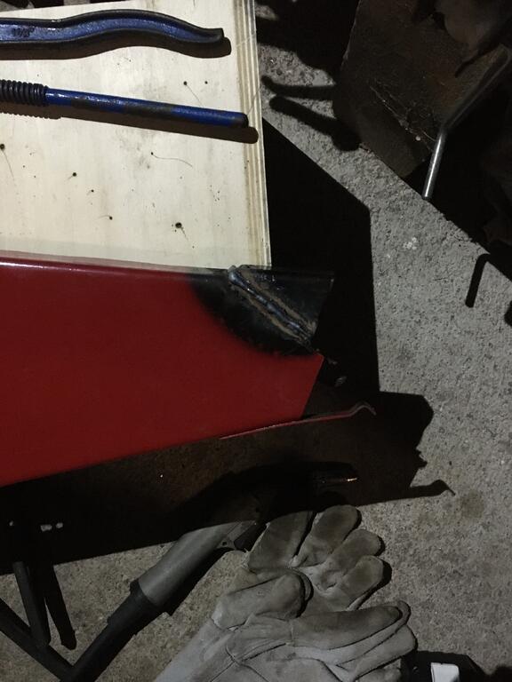

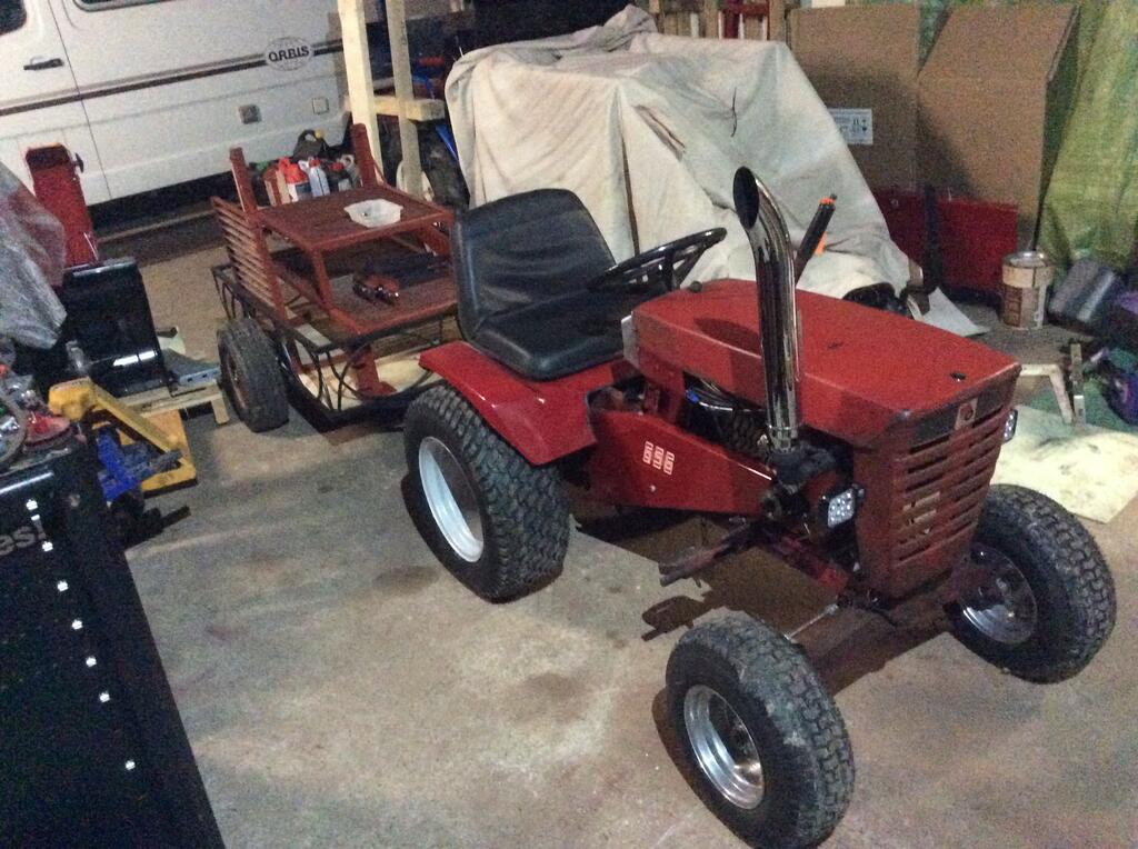

Tractorhead 9,217 #157 Posted February 7, 2021 Huh haaaaa heeey, i forgot i had allready a spare plywood plate. Yap, that is big enough... So grab the Saw and cut it to fit. than i drill few holes and mount it with the removed Screws from the Pavillion. at least i grab a rattlecan to protect the welds from under the Trailer. Tadaaa - seat test, yap much more stability. ok, the drawbar will stay as Weakpoint, but we will see how long it lasts. i can hop in that thing and it don‘t cracks. - so far so good. and i find it fit‘s the Tracta... 1 7 Share this post Link to post Share on other sites
ebinmaine 80,760 #158 Posted February 7, 2021 Steve man that looks awesome. Excellent use of onhand materials. 1 Share this post Link to post Share on other sites
Tractorhead 9,217 #159 Posted February 7, 2021 11 minutes ago, ebinmaine said: Steve man that looks awesome. Excellent use of onhand materials. It‘s a need, because of no playtime with the Horse.😎 to mow the Air make no sense i believe.... so if i can‘t do things with the Horse i have to do things for the Horse... 😂 2 Share this post Link to post Share on other sites

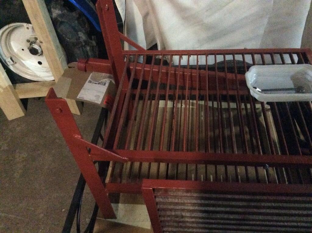

Tractorhead 9,217 #160 Posted February 19, 2021 Mart‘l asked me if i would rework a stairway to the chicken coop for Mum, She want‘s it after he stop‘s the Cows and mum like to be busy. But she afraid of the old steps to the chicken coop even in Winter because it is too slippery, so it should be a Winter usable stairway built not too slippery. Ok, no question i will do, how we do on Material? I have few things aside you can grab or you buy new - your decision. Let‘s see what we can reuse. - WheelHorse seat Time - 👍 i jumped on the horse and take it‘s new built Trailer to test it out and out we went. We ride several minutes to his hidden Shed with all the collected Stuff on a hidden place he had and i be allowed to go in and find and took whatever i need. a big honor for me to have that freedom and trust. Lot‘s of goodies laying arround, while lurking arround i see that Steel Rost Frames, built for eternity. They be from his fathers cowshed - little rusty but massive and pretty stable. I took them and put into the trailer. on the Way back i stopped by at Max, he also was wrenching in the Shed and took that Pict. pretty Cool Than i put the Rost frames in the Shed and begin to thinker about. Ordered a 6m Rect Steel 30x30 4mm to built the Construct. 1 3 Share this post Link to post Share on other sites

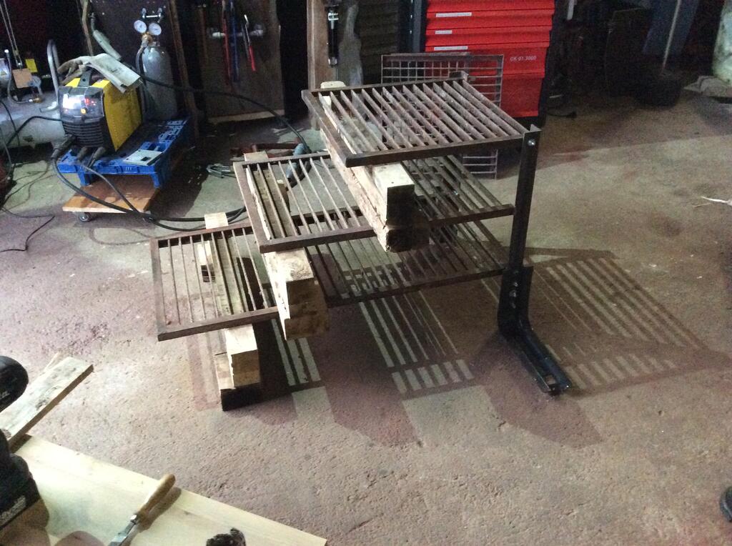

Tractorhead 9,217 #161 Posted February 21, 2021 (edited) The Stairway to heaven get‘s just a little more done. Still waiting for my Steel. i added to my Steel Order another angle iron 30x30 5mm and a U profile 34,5 x 40 in 5mm. When i try to lift it, i decide to built it adjustable and be able to remount it for a move. that thing becomes really heavy, i estimate about 50-70 Kilo‘s and it‘s not finished yet.. step height is 22,5cm and step lenght is 30cm. I try to build it for eternity. Both angle iron‘s are made of steel in 50x50 - 5 mm thick, the rost’s are made of steel 20x20 5mm thick. Few stiffer must be inserted and a handrail must also be buit for Mum. The front sides are made from a used Tank mounts like my FEL Fork is made from, they normally carries a 500 litre Tank, that should be strong enough. i screwed them only on, to be able adjust each side up to 15 cm in height. therefore i drilled several holes in 4 cm distance to be able to adjust. hope the steel comes soon. Edited February 21, 2021 by Tractorhead 5 Share this post Link to post Share on other sites

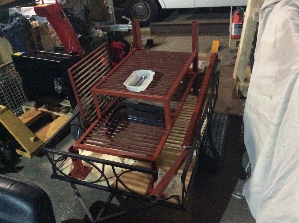

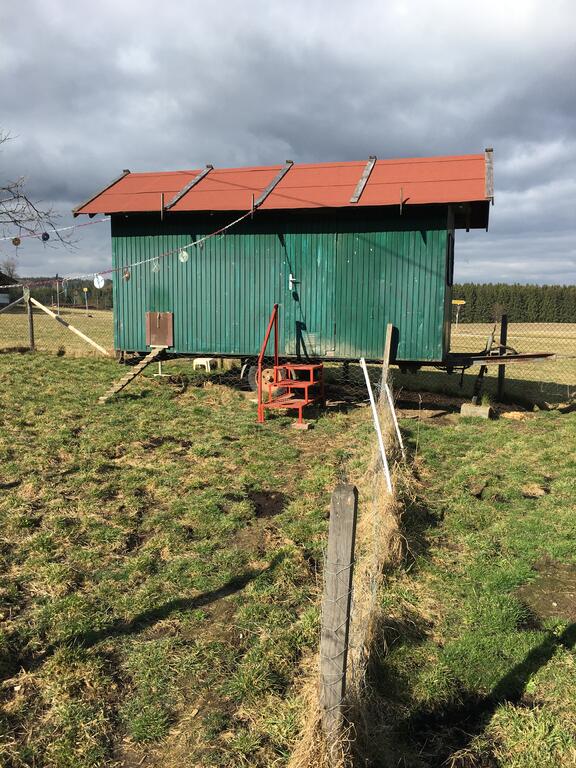

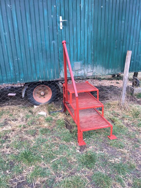

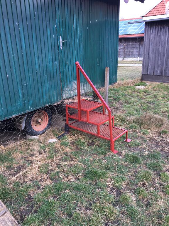

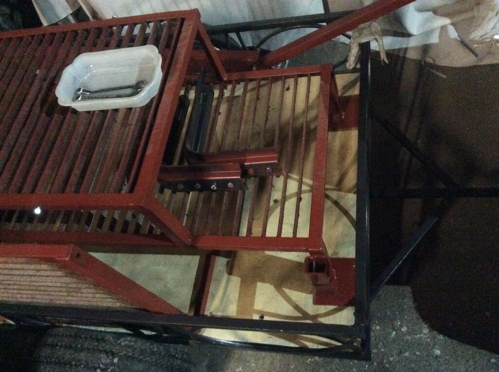

Tractorhead 9,217 #164 Posted February 26, 2021 stairway to heaven is today finished. At least i build a Handrail for Mum. Boy, that thing is now heavy... but i made it dismountable, after that i disassemble it completely to primer. While i plan to primer it after finalize, i took care of my ipad and let it home for today. So evidence picts will follow maybe tomorrow if i can deliver, but forecat talk about strong Rain. However, picture will follow soon. 2 Share this post Link to post Share on other sites

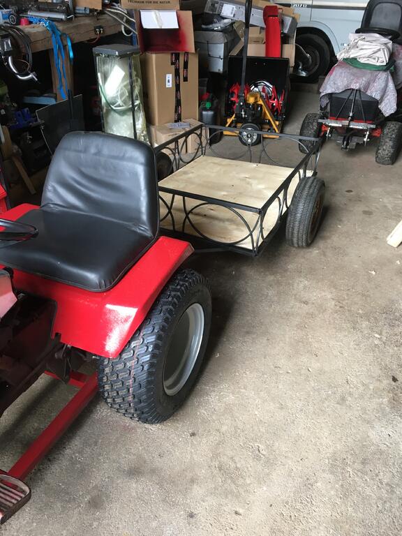

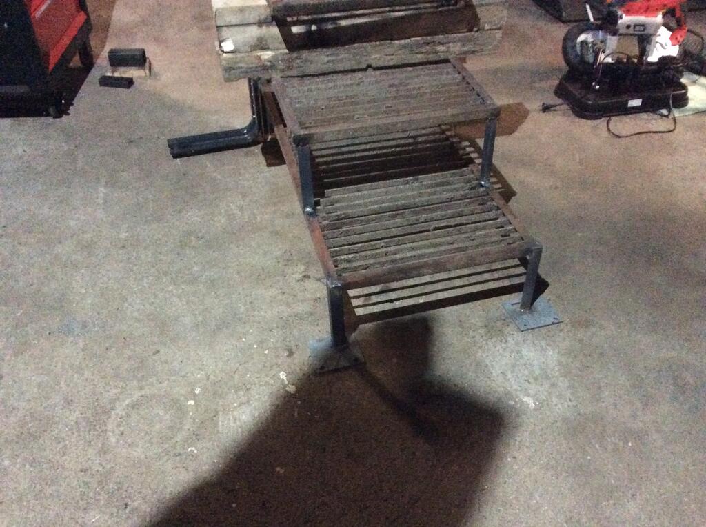

Tractorhead 9,217 #165 Posted February 26, 2021 (edited) Update, forgot the Car Key in the Shed, so quick a jump into and took few Picts. The Base step with sideway‘s welded handrail mount. Stiffned Second step behind the removable handrail and in Fron the top step. All fit‘s in my Custom Wheelhorse Trailer. Seems i dimension all in right Size. Ready to deliver👍 Edited February 26, 2021 by Tractorhead 1 3 Share this post Link to post Share on other sites

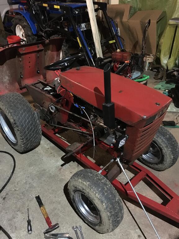

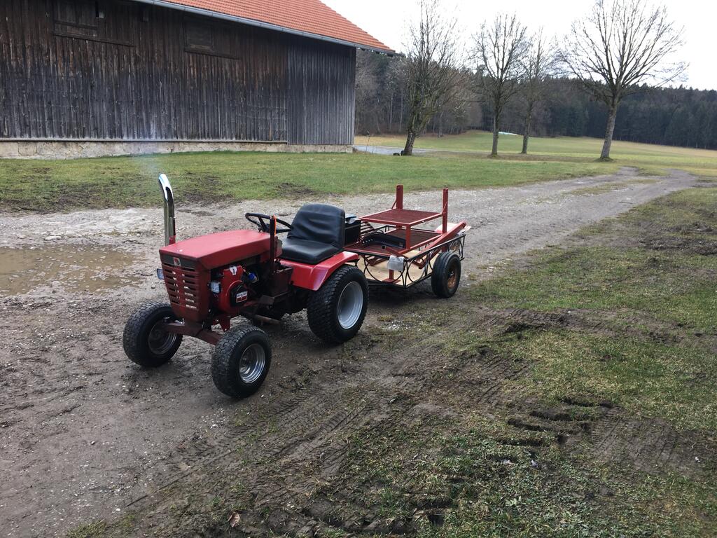

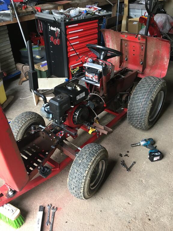

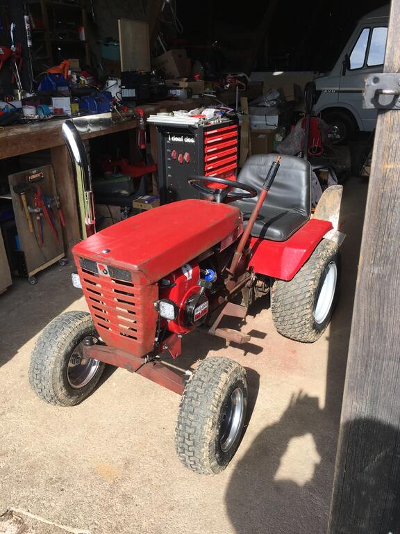

Tractorhead 9,217 #166 Posted February 27, 2021 Delivery Day for the „Stairway to Heaven“ Fired up the Horse to deliver the Stairway, when i do this stop for a quick picture, i hear a curiuos noise sounds like a backfire and the Engine begins little blue smoke. But it runs still well in idle and it is freshly Serviced include oilchange, so it have fresh oil in it. I double checking what will happen but nothing can be seen. All is well and she run‘s fine like allway‘s, except again a little blue smoke on throttle up. I fear „ pistonring“ maybe cracked. However i need her so we do that ride together. While we ride along, the blue smoke gets less until nothing can be smelled. I let her run in idle while i mount the Stairway on the Chicken Coop. about 30 sec. absolute no oilsmell again can be seen an she runns nice and smooth in idle without any Hickups. I love my little Trailer and several peoples ask me where to buy. Think i shall made a pre series - but no, it‘s be kept unique. Ok, please don‘t green over the Handrail end, yes - it‘s a rattlecan cap from the last Primer. 😂 No other solution was so quick on hands and it‘s better than anybody hurt itself. We tested it out if it‘s stable enough - yes it is. 2 idiots they jump on it around like 2 small kids...... 😂 after the „ hardcoretest“ we called Mum to test it. She like the Handrail and she feels save on it. - cool mission accomplished. Time the Cicken resides it, We did an agreement - free fresh Eggs for 3 years. 😎 Than i ride with the Trailer back to the Shed and changed over to the Tiller. With the tiller i ride to my little Field to prepare it. Ok Soil was a bit too wet, but it works so far. the Tyres collects a „security deck“ on top of them.... i tried to make a Video, but i missed the record button and hit it when i finished- 😎 20 min Video make in the Pocket.... 😂😂😂🤪🤪 At least i fixed my Plow, that it will align again after it was bent by the Beast when it hit‘s a Rock. i dig that Rock out last year with the FEL and hope, this year it will not happen again, because it further just work behind the Wheelhorse. I think it can be seen the bending where the rusty spot is - check - bavk in Service. To bend it bavk, i use a rope and bind the other side onto the big Workbench, than i used a 2m Steelpipe put it in a angle iron to bend it back carefully. hard job, but it works. Now we be back in Service. after i doing all today‘s jobs, i do a little Trailride, but because of worse forecast and cloudy heaven i let the iphone for safety reasons in the Shed. 1 7 Share this post Link to post Share on other sites

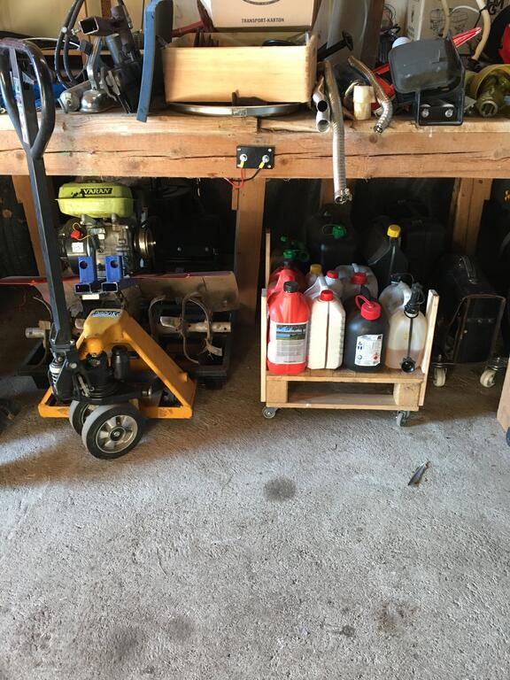

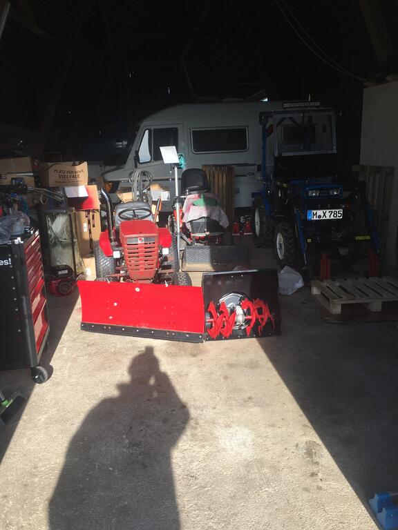

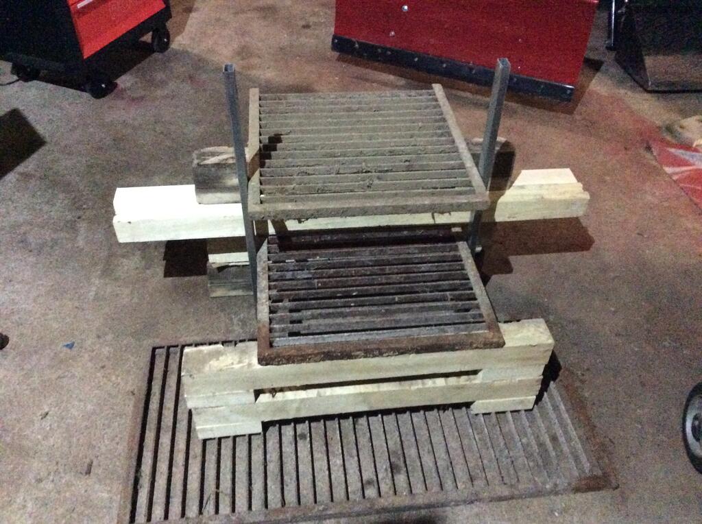

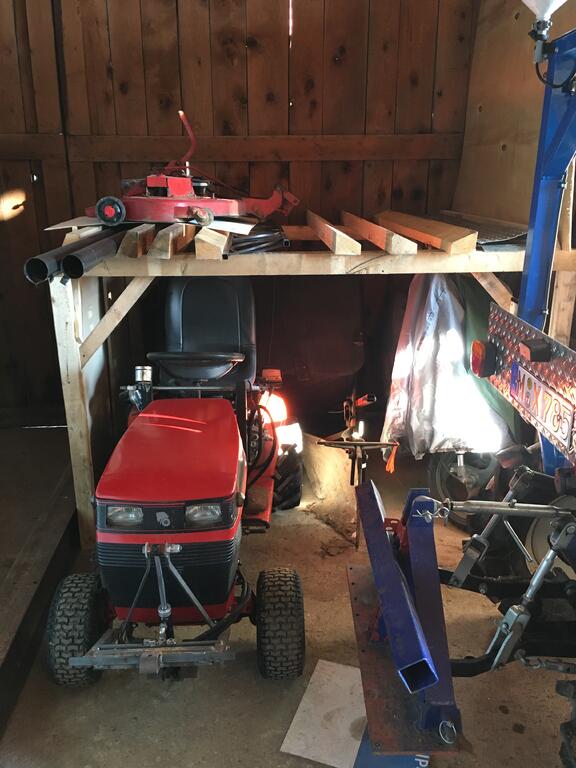

Tractorhead 9,217 #168 Posted February 28, 2021 Shed Spring cleanup today... Collecting lot‘s of wooden Tankpalettes, because of cheap wood for the new Horsie Garage. after the palette truck is finished and winter is gone so far, i have time for the snowblower. but im not in a hurry, so just look for a place to stay. after cleanup i shiftet one of the large workbench foot little more left, to align with the one in the back. so i get more room to store palettes under. a small oilcabinett out of a palette will close this movable system. all is quick and handyusable and if not needed fast outta Way. So Snowblower first, tiller after but i will maybe changing this order. at least i welded quick a Airtank holder for Max‘s Servicetruck because he will move the Tanks from the side away in the middle of the Truck. a successful Sunday come to an end. good night little Shed... - good night John- Boy....😂😂😂 3 Share this post Link to post Share on other sites

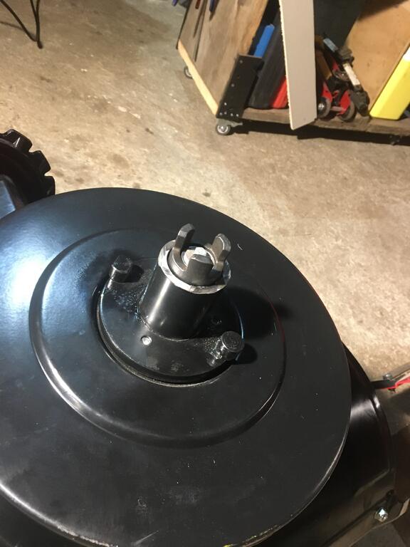

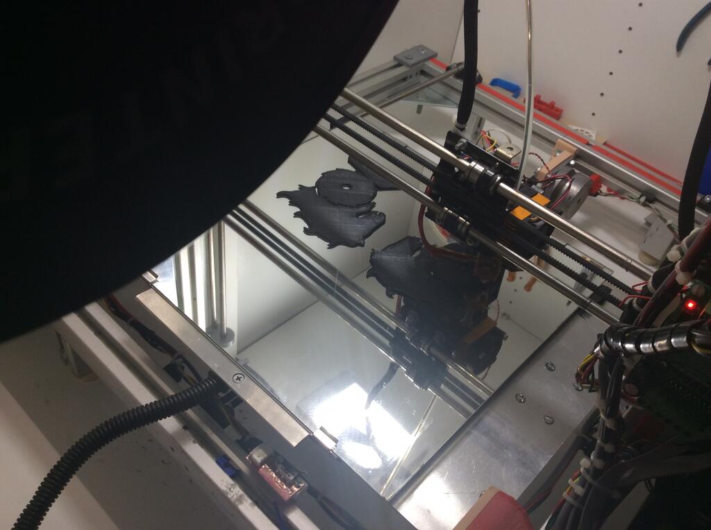

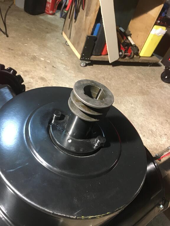

Tractorhead 9,217 #169 Posted March 1, 2021 Thing be delivered, quick into shed to look what‘s arrived. The both extended spindles .. - cool . next thing is to decide is the sheet metal to extend the Housing - steel or Aluminum. i think i get steel, because of possibly salt contamination and Alu corrosion. Steel can be welded on, Aluminum must be screwed. However, no sheetmetal here, so end workshop time and back home. fired up the 3 D Printer for a Test i drawed the last day’s. curious how it will be looking if Final. 4 Share this post Link to post Share on other sites

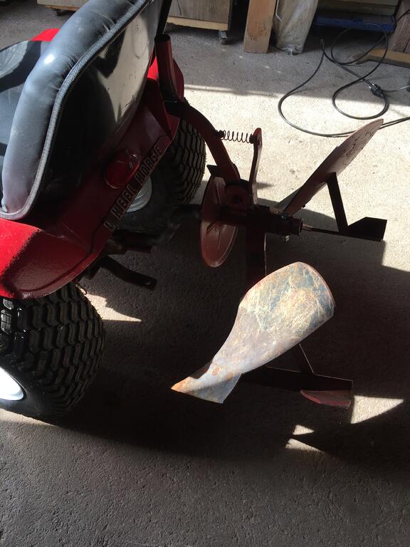

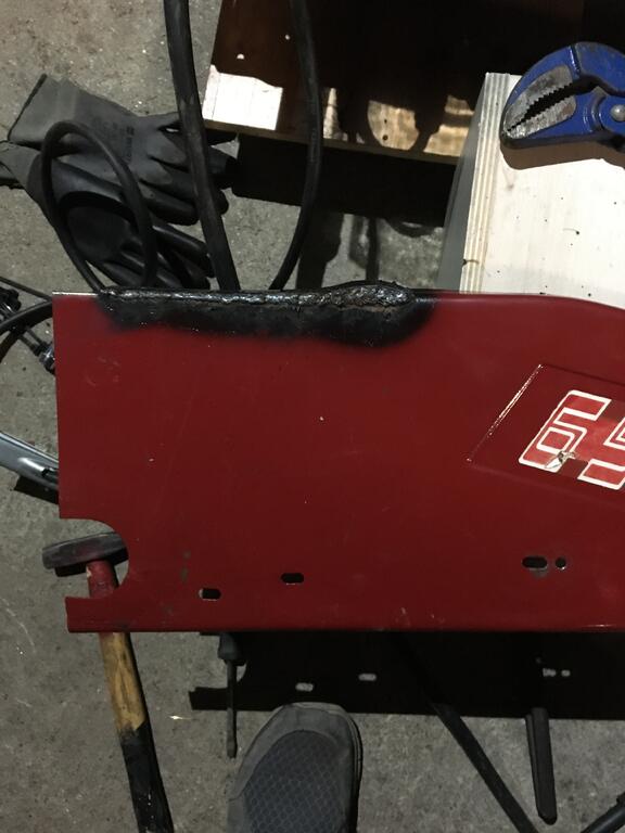

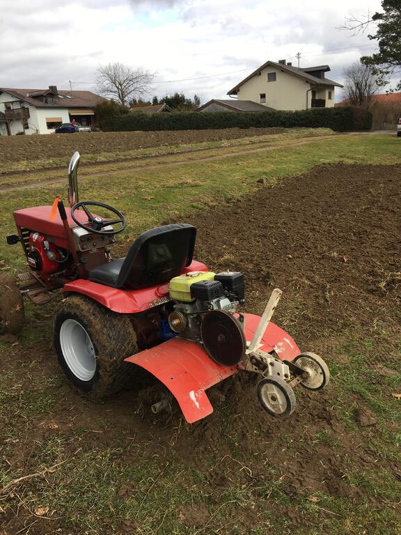

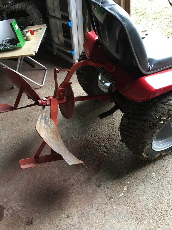

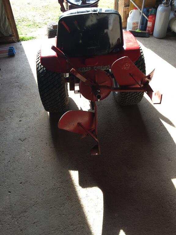

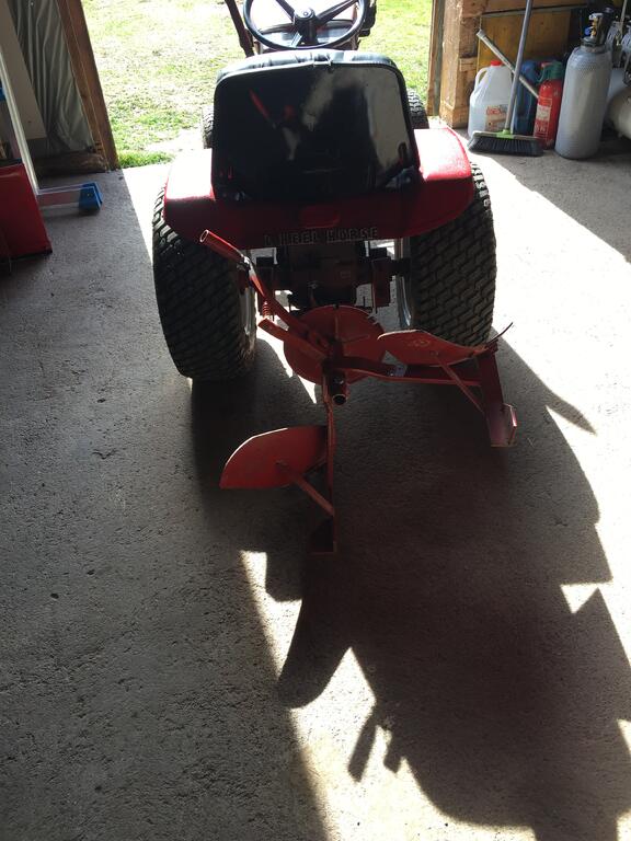

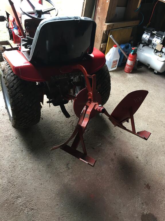

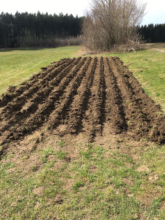

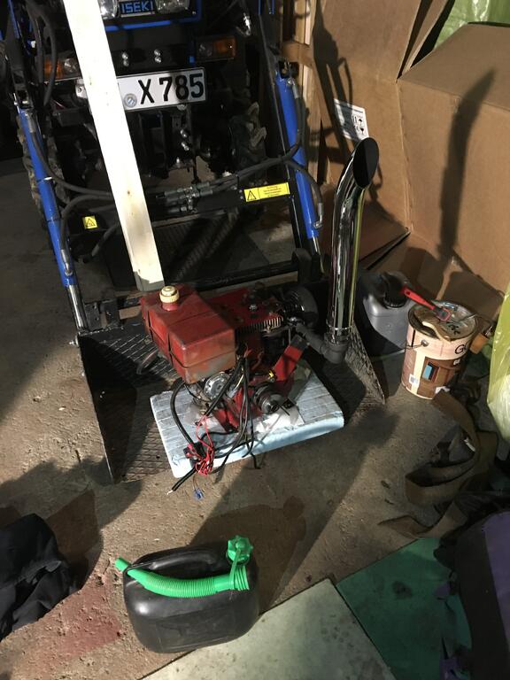

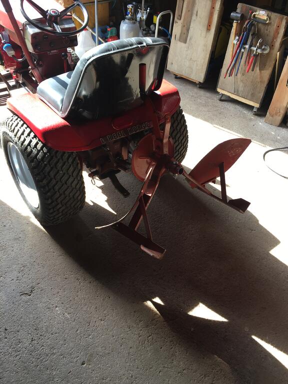

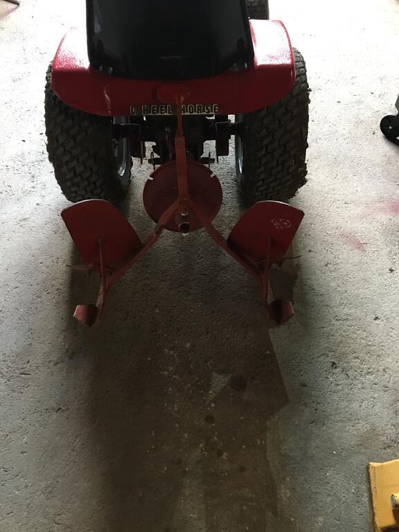

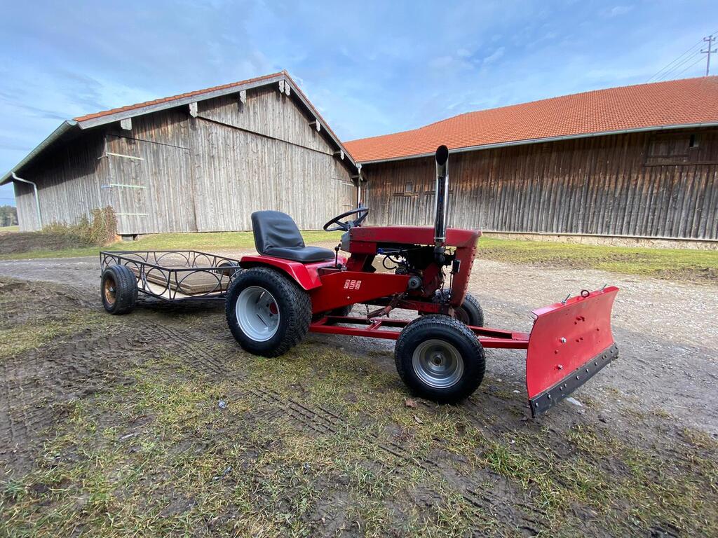

Tractorhead 9,217 #171 Posted March 13, 2021 Waterloo - F*** Firstly i did today my own Plowday - to see if my reworked Plow will work as expected. Yesterday i tried to bring it to glow with the induction heater, but it‘s just be able to burn down the paint and heat it up to dark red glow. That is enough to open a Screw, but not hot enough to Bend Steel. I tried it 2 Times but allway‘s after 2:30min the self protection occurs and i have to wait for next try about 2 minutes. - that‘s toooo long. So 1 KW is not enough for 1“ Steelpipe with 10mm thickness to bring it to glow bright red. Maybe the 1,8 KW will do the trick but i don‘t have. So i drive yesterday late evening to my Buddy, a Blacksmith and we bend the Plow as i measure it. after we bend it it must cool down and a „hold my Beer“ Task happens, the Watch show‘s 01:30 when we leave the Workshop.. 😎 Today i grabbed the Plow and decide to give it a Testride. The Tecky grunt‘s nice but begin also again a little with but after the Plow i make a real mess on the Road and decide to cleanup immediately. So i constructing a Quick and Dirty Cleanup System and give it a Try. that works better than expected. after that task i decide to go back and pickup the Tiller, the Soil is not too Wet. The radio forecast told - The next few Day‘s Winter should come back. but a stronger Wind ( they call it storm) occurs and i decide to hurry up. After passing the Road, i hit to full Throttle and hear just a gently scrapping noise, followed by heavy blue Smoke and a Popp. Engine stalls immediately. I try carefully to pull the Pullstart and the engine seems to move but hard and without a nice noise. If i interet the noise right, i bet Pistonring is Gone. - F*** Gladly i have the whatever it has Predator Engine i painted in Red in spare. purchased as 7 HP, the Brocure shops 11 HP the Housing tells something about 9 HP - Hahaha. So - Engine Swap - NOW ! first removed carefully the Engine to be able to rework it someday‘s. Than i build 2 Engine mounts to bring the Engine close to it‘s original Pulley height. Because of the Airfilter Box i decide to move it from 19cm from Front to 20cm from Front to Pulley Center. so it fit‘s snug to the Hood without needed Modifications on the Hood. Step by step adaption for the Engine adapting rails. The Predator looks not Bad in the Horse The Hood fit‘s snug. And after small Paintjob, it fit‘s also in optics. ( love the black Screws for the optic) So the Engine is mounted but i must adapt the Beltcover - no chance to keep it as it was before. The original Pulley on the Tecky have a measured outside diameter of 65mm, the predator pulley have 75mm 😎 so i have to rework it. welded, but not finalized And a new Front tip. Curious how it will perform. 2 1 Share this post Link to post Share on other sites

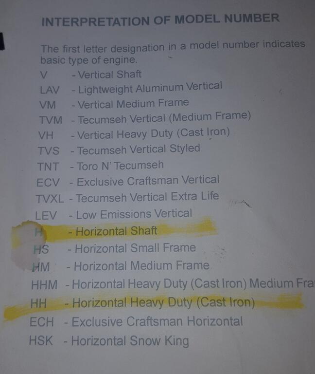

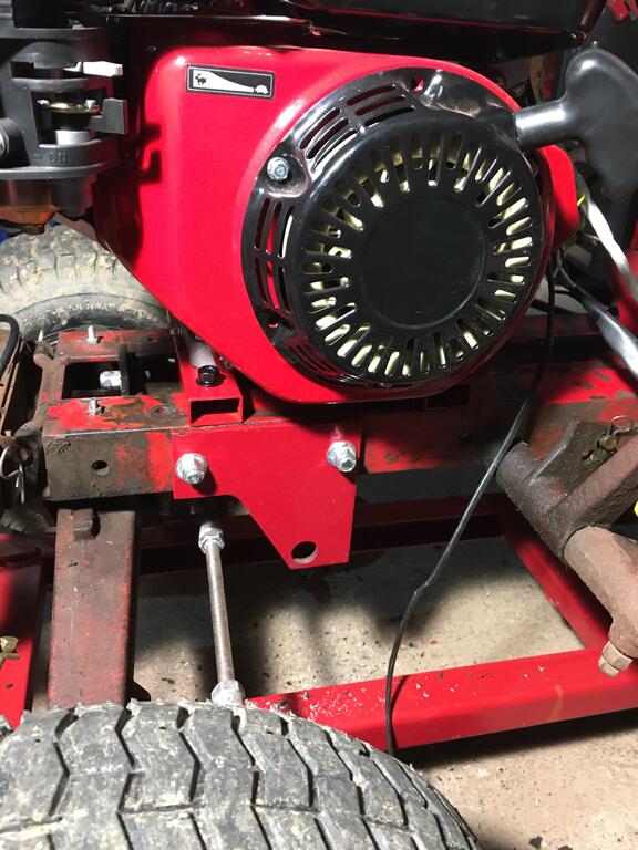

Gregor 4,848 #172 Posted March 13, 2021 1 hour ago, Tractorhead said: If i interet the noise right, i bet Pistonring is Gone. Is your Tecky cast iron, or aluminum block? Share this post Link to post Share on other sites
Tractorhead 9,217 #173 Posted March 14, 2021 10 hours ago, Gregor said: Is your Tecky cast iron, or aluminum block? It is a HH60 made of Aluminum. Share this post Link to post Share on other sites
Gregor 4,848 #174 Posted March 14, 2021 2 hours ago, Tractorhead said: It is a HH60 made of Aluminum. ???? H60 = aluminum HH-60 = Cast IronI was just wondering how much damage a broken ring might have done to an aluminum cylinder Share this post Link to post Share on other sites
Tractorhead 9,217 #175 Posted March 14, 2021 3 hours ago, Gregor said: ???? H60 = aluminum HH-60 = Cast IronI was just wondering how much damage a broken ring might have done to an aluminum cylinder We will see when i rework it. for the moment i switched over to the Predator to be prepared. That‘s the quicker solution for now. 1 Share this post Link to post Share on other sites
