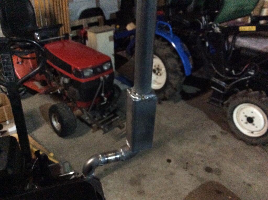

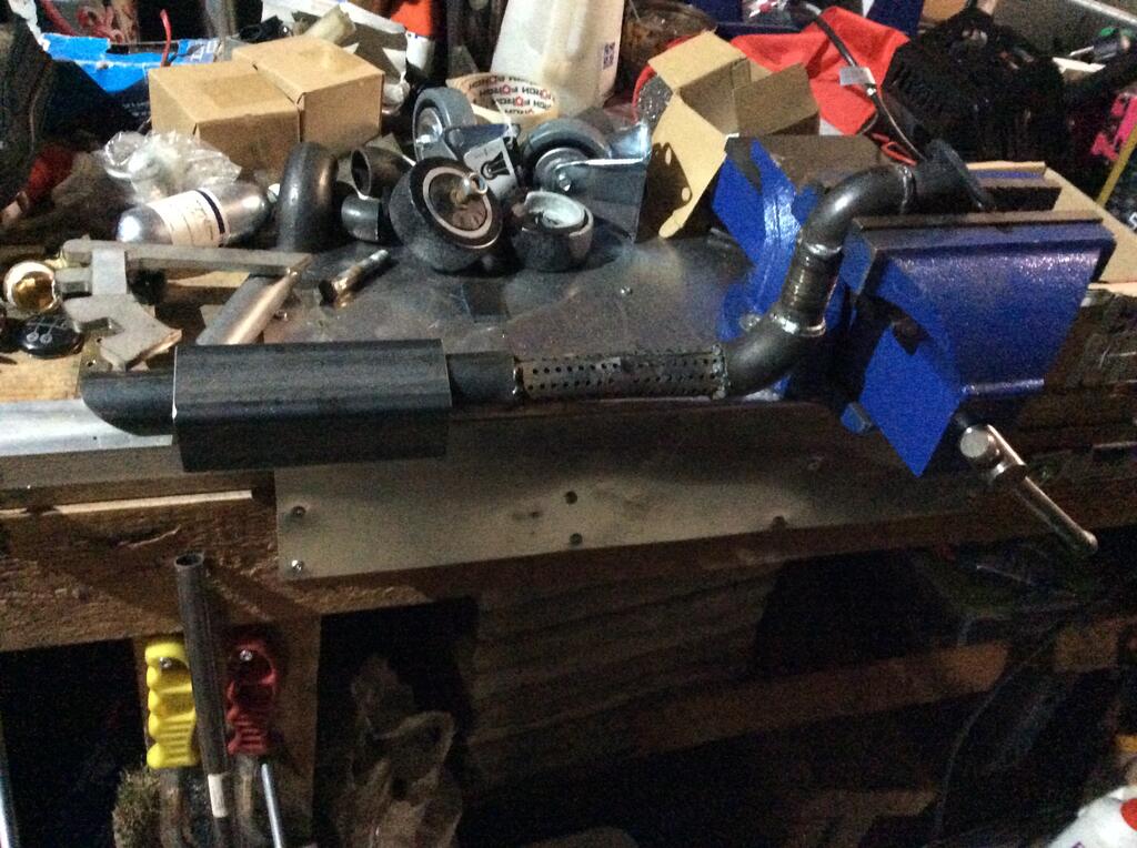

Tractorhead 9,217 #132 Posted January 21, 2021 Finished my new Stack for the Spareengine. Love it‘s dark bark 2 3 1 Share this post Link to post Share on other sites

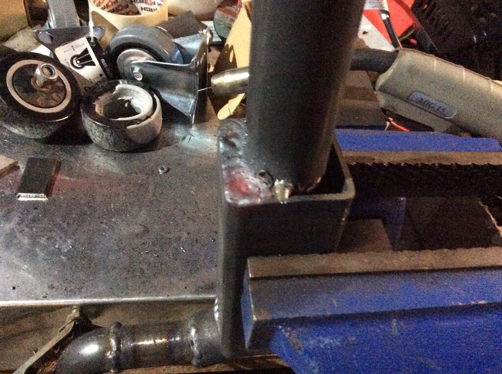

Tractorhead 9,217 #133 Posted January 24, 2021 How to make a Stack. you can calculate and equate some thing... or you just try it, that was my Way on this Stack how i built it. As first Part i reuse the cutted original Flange from the original Exhaust, than i welded few Pipe angles onto, so that it can Fit under the 656 Horse. i measured an gap of 9,8cm i need for clearace to the Hood. So i decide to increase it to 12,8cm to have more clearance later. The muffler Element was a holes sheetmetal, i reused from the Originalexhaust, what was on the Horse when i got it. the Muffler itself was strongly rusted, so I dismantle the rotten sheetmetal and found the inner will be in not too bad shape in rust. So a bit wirebrushed and reuse it, when i spotweld it i’m running out of Welding Gas. Arrrrrrr. Few day‘s later i get a new Bottle and can finish it. i cutted a Rect. pipe with 60x60mm 5 mm thick in a lenght of 13cm, what fits perfectly over the holes sheetmetal. i thinkering how to build the Endcaps and decided just to weld them. A waste of Gas and Welding Wire - maybe but it goes quicker and better than i thought. So i decide to just Weld it to together instead using thin Endcaps. With 3 more Welding Layers it should be thick enough not rotten fast in any Way. At least i thinkering abou an Flapper, but for the moment i keep it as it is. The Soundcheck is in the Video above. 3 1 Share this post Link to post Share on other sites

Pullstart 71,289 #135 Posted January 26, 2021 On 1/21/2021 at 1:07 PM, Tractorhead said: Finished my new Stack for the Spareengine. Love it‘s dark bark The bark is perfect Stefan! Did you use the rectangle tubing because that’s what you had, or for the look, or a different sound, or??? 1 Share this post Link to post Share on other sites
Tractorhead 9,217 #136 Posted January 26, 2021 (edited) 4 hours ago, pullstart said: The bark is perfect Stefan! Did you use the rectangle tubing because that’s what you had, or for the look, or a different sound, or??? It was a test. i previously thinkering about a round pipe, when i see the Rectangle pipe on my Steelwall. Than i decide how about a Rect. stack, the most have round tubes, so why not. So i grabed the Steelpipe cut it on my Bandsaw and give it a Try. first look seems a bit - huh let‘s say uncommon. thought also about an Rectangular Outlet, but i didn‘t have material in my needed Size aside. So i decide between a mix of round and rect and give it a Try how it sounds. Edited January 26, 2021 by Tractorhead 3 1 Share this post Link to post Share on other sites

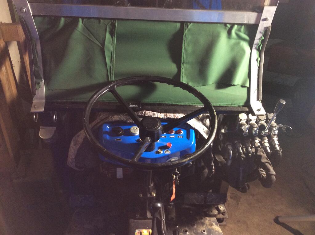

Tractorhead 9,217 #139 Posted January 27, 2021 Once a smoker needs a lighter on his Tracta something seems wrong.. so i decide today to change this. My solution was the second Highpower Coil, i use it only for the Lighter and it‘s illumination. Thinkering long before i did it, but i think the red Background light fit‘s my Tracta... 1 2 Share this post Link to post Share on other sites

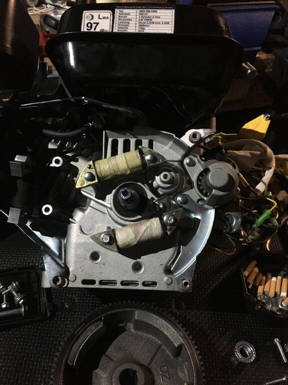

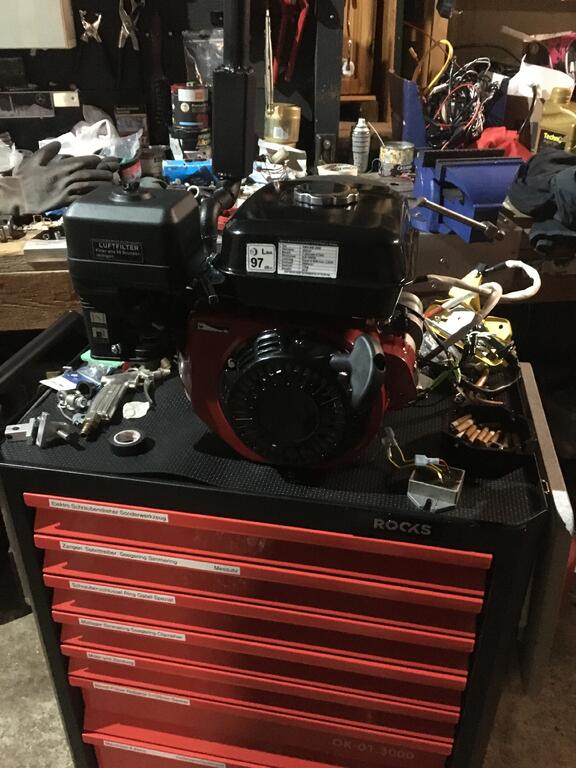

Tractorhead 9,217 #140 Posted January 29, 2021 added yesterday another Charging Coil in the Spare. So that it can also be used as a mobile Charger Generator.. aand back in Service with sensefully improved Charging System. Than Max today came along with his newest „toy“ The proud Owner of this Landy Discovery In Full Rally Setup - but even Road legal. Little Work must be done, but a cool Base setup. nice.. 👍 at least we both finished quick his new 20To. Workshop Hydraulic Press Two brainfree Gearhead‘s in one shed, could be a interesting mixture.... 😎😂 6 Share this post Link to post Share on other sites

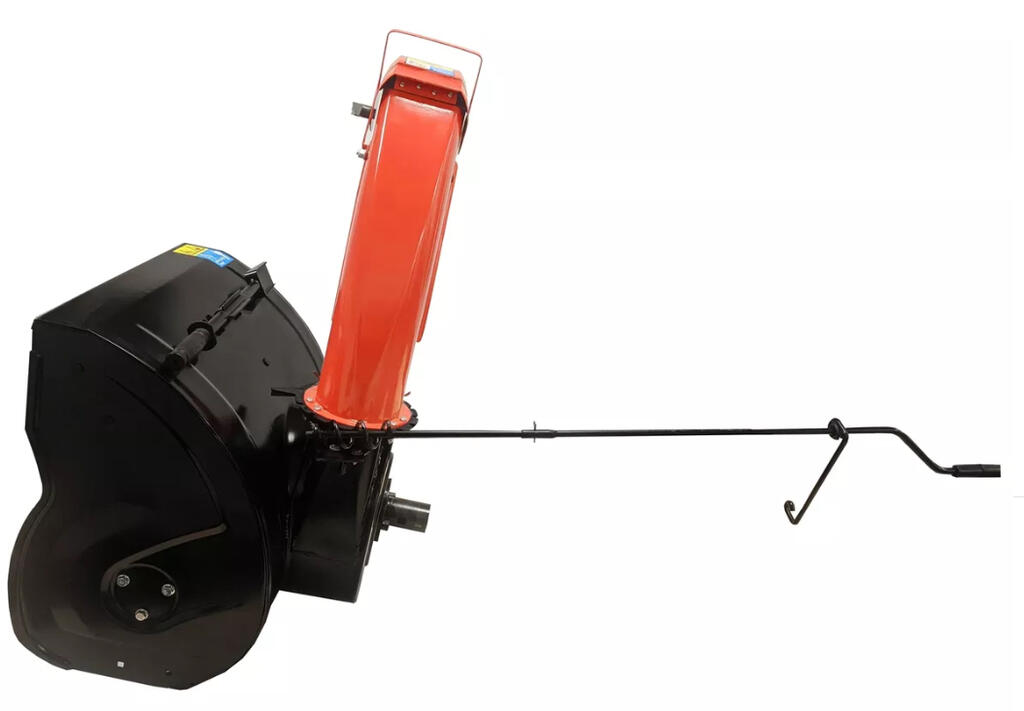

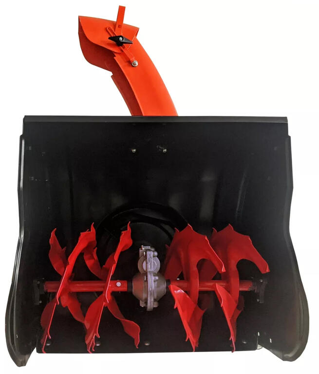

Tractorhead 9,217 #146 Posted February 3, 2021 Next Project in Pipeline.... 😎 Maybe not usable for this Year but .... 1 4 1 Share this post Link to post Share on other sites
ebinmaine 80,758 #147 Posted February 3, 2021 23 minutes ago, Tractorhead said: Next Project in Pipeline.... 😎 Maybe not usable for this Year but .... What type of unit is this? Size and shape and stuff like that? Share this post Link to post Share on other sites
Tractorhead 9,217 #148 Posted February 3, 2021 7 hours ago, ebinmaine said: What type of unit is this? Size and shape and stuff like that? I found it on the Bay for a dang Steal. basically it‘s for an Walk behind, but i just lurking longer time for such a Base. Basic Data are 57cm workwidth up to 45cm Snowheight and runs at 1000RPM. I thinkering since few Weeks maybe to build one completely myself, but than i see this offer. The first time i noticed about i just think huh, not Bad. But than it pops several Times up and i Missed the first Try. 2 Weeks later it pops again up and i decide to eyeball it closer until i see it‘s Price. This time it‘s the half than 2 Weeks ago, so maybe they make a mistake by typing the Price. I payed for all together less than half, than just for the single Gears as spare part, that changes my plan immediately. My plan is to cut it on the Sides, widen it to completely 80cm workwidth and bring it back to a Working unit. At least i will paint it in the Color for my Horse. I must also optical fit. about the Drive Situation i have not finally decided if i will rework it to Hydraulic driven or just Beltdriven. That decision will be taken when it was here and i can see it in detail. Than few Other Toy‘s arrived. first a new Telescopic Stand for the Worklight by 10 Bucks no question about it and a New Tracta Seat. I thinkering lot of my Beast‘s Seat. sure it‘s strongly damped, but that brings my Balance tilt point 16cm more up. On stronger Slopes sidewards it can be sometimes a little tricky to stay in the Saddle, So i decide to test this Seat, it looks comfy and fit‘s more to a Tracta. Will implement later maybe 2 Harley Seatsprings or i contact my local Spring dealer( just 5Km far) So i cutted a U Profile i made the Plowframe of and shaped it to fit my Seatplate. Than i drilled 2 M12 Holes for the Seat, grind my Seatplate down to bare Metal and fired up my Welder and weld the Mount for this Seat. Seatheight feels much more Comfy than the damped one even Without the Springs. At least i correct ( bend) the Levers for the FEL that i can reach and Access them very comfy from this now little deeper Seat Position. Next Task will be the green tarp front must be exchanged. That doesn‘t fit the Tracta‘s optics, but for a Testtemplate if does a good Job until now. It just doesn‘t fit optical in my Eyes.. Time to change it to a better Solution. 1 2 Share this post Link to post Share on other sites

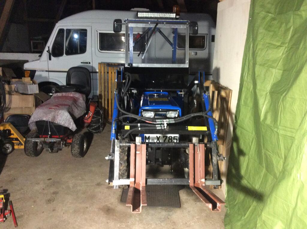

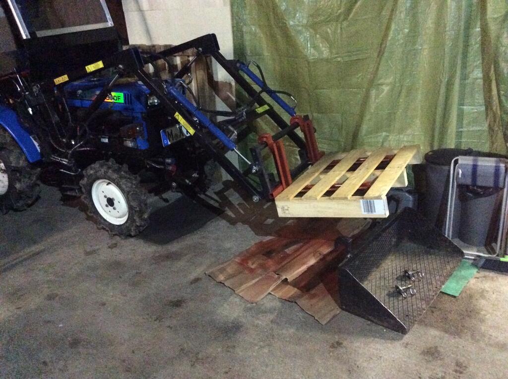

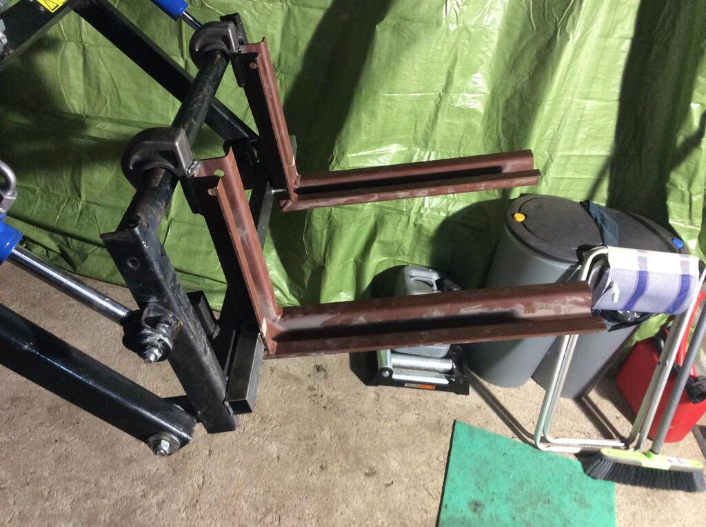

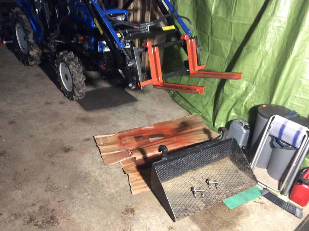

Tractorhead 9,217 #149 Posted February 4, 2021 Logistic Company sends me a Message, the Snowblower will be delivered tomorrow. I have to help them by unload. Huh, no Machine for that now. Ok, check the options.... I have no Forklift but i have a Tracta. - hooked. i have no Fork for the Front, just for the Rear lift. Dang. ok look what option‘s i have. searching in my Steel storage and find two Tank mounts for a 500 Litre Tank, i saved from the Scrapyard. yap, perfect... Fire up the Welder and buzzing them 2 Hooks on. So i can use them with the Quickchanger - nice weld a Side lock, that the Fork not move to any Side. inside i weld a Nut on, to act as Centering for each fork independently. they can be later interconnected by the Rect. steelpipe, but for now i try it as it is. Slap quick a little primer onto. And here we go... Next Attachement is done ! so i hope they will deliver tomorrow.😎😂😇 Inbetween, i used the new Press, to rework the new Front sheet below the Windshield a Workmate bends for me a bit where the Steering Wheel is and exchange the Tarp finally with a black Painted Frontblade made of 4mm Aluminum. Looks much better and is also massive stiffer. sensefully Social distance Work. 6 Share this post Link to post Share on other sites
