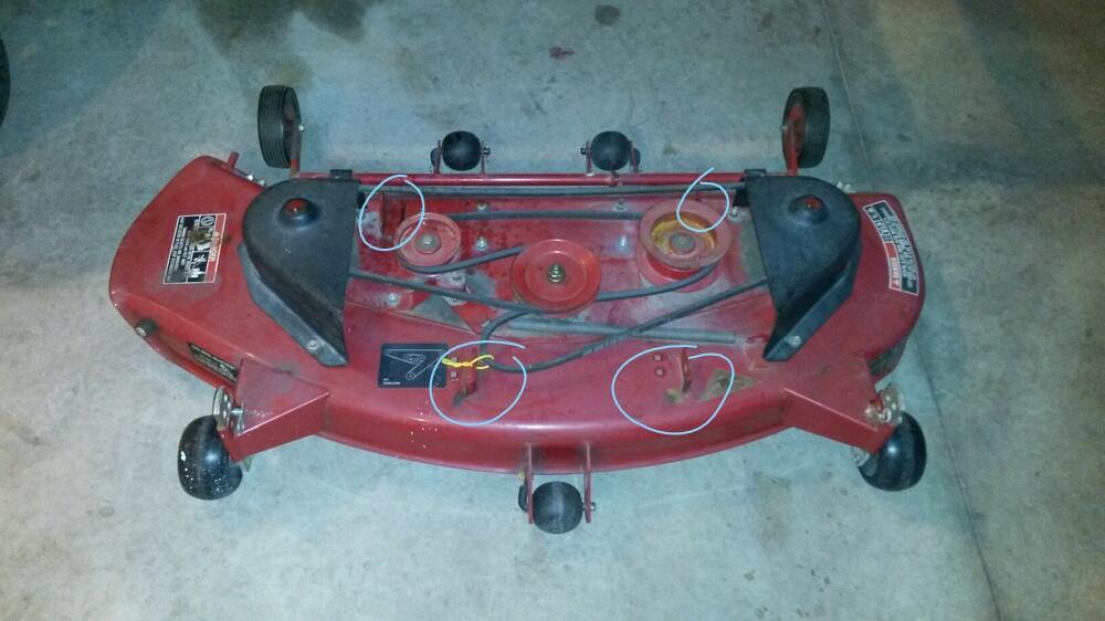

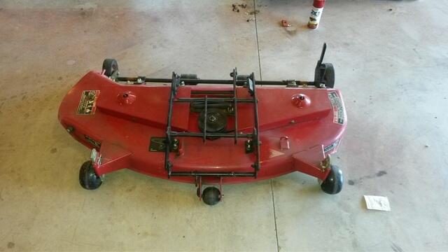

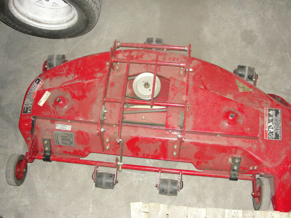

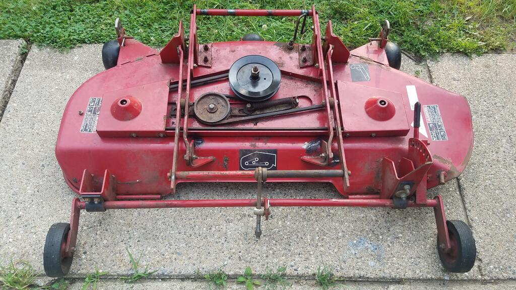

bds1984 1,513 #7 Posted August 19, 2020 I think you might be thinking of the 400XT series where there were some attachment interchangeability with the C/3/4/5 series. Here is my 260-series deck with the black belt guards that I bought new in the first picture (it is dirty from sitting in a garage for a decade). I had to cut off all four of the mounting points from the 260-series deck (circled in gray) and use the spindle shafts from my old deck to be able to use it on my C165. The second picture is a regular 48" deck that we've all seen on various C/3/4/5 series. The third picture is of the final conversion I've been using for the last two years and it cuts beautifully. The last picture is of the 520XI I had until last summer. Shell looks to be the same but you can see how the mounting points are; some welded, some bolted. But as you said, with a welder and hardware, it could be adapted. I can see the shells for the 44", 52", and 60" inch decks being different on the XI series, but the 42" and 48" inchers seem to be 90% the same and could be converted between the two fairly easily. Share this post Link to post Share on other sites
