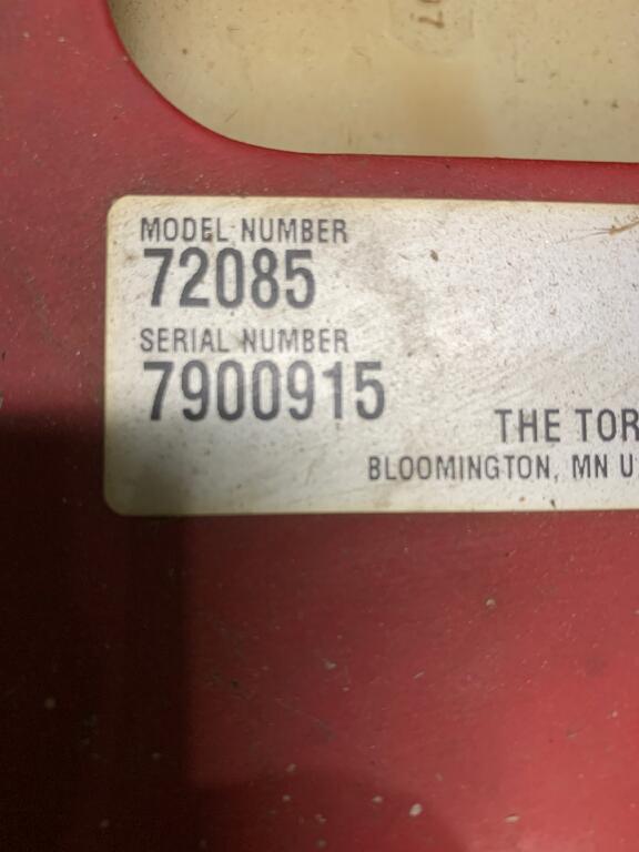

TonyToro 1,190 #4 Posted August 19, 2020 I asked him to send me a picture of what broke. Share this post Link to post Share on other sites

TonyToro 1,190 #6 Posted August 19, 2020 32 minutes ago, gwest_ca said: Left and right are different. Left and right are always from the operator's position in the seat. If you can get his model number and serial and the specific part he needs it may be possible to determine what other models used it. Garry Thank you! I’m waiting for him to get me serial number. from what he explained to me I was thinking the rod from the steering went to one tire and a longer rod went from that tire to the other tire...I was definitely mistaken...lol Share this post Link to post Share on other sites

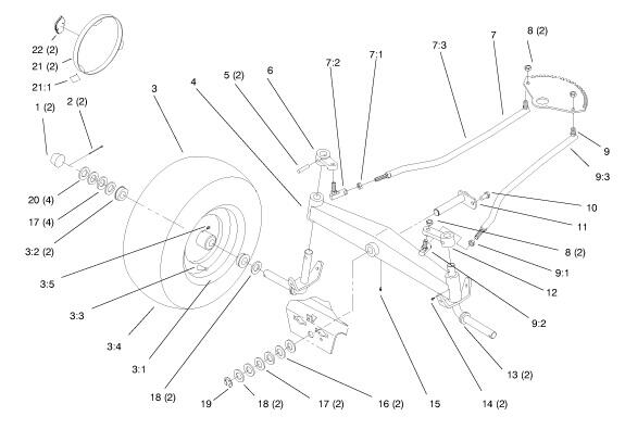

gwest_ca-(File Mod) 12,483 #8 Posted August 19, 2020 Here is the correct parts list so the part can be identified. Always like to get the correct list because changes can occur between the start of the model production and the end. 1996-1998 Garry 1 Share this post Link to post Share on other sites
