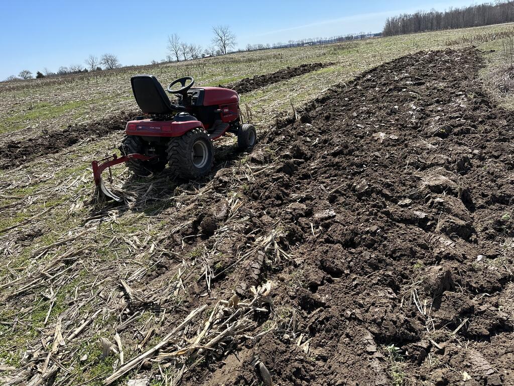

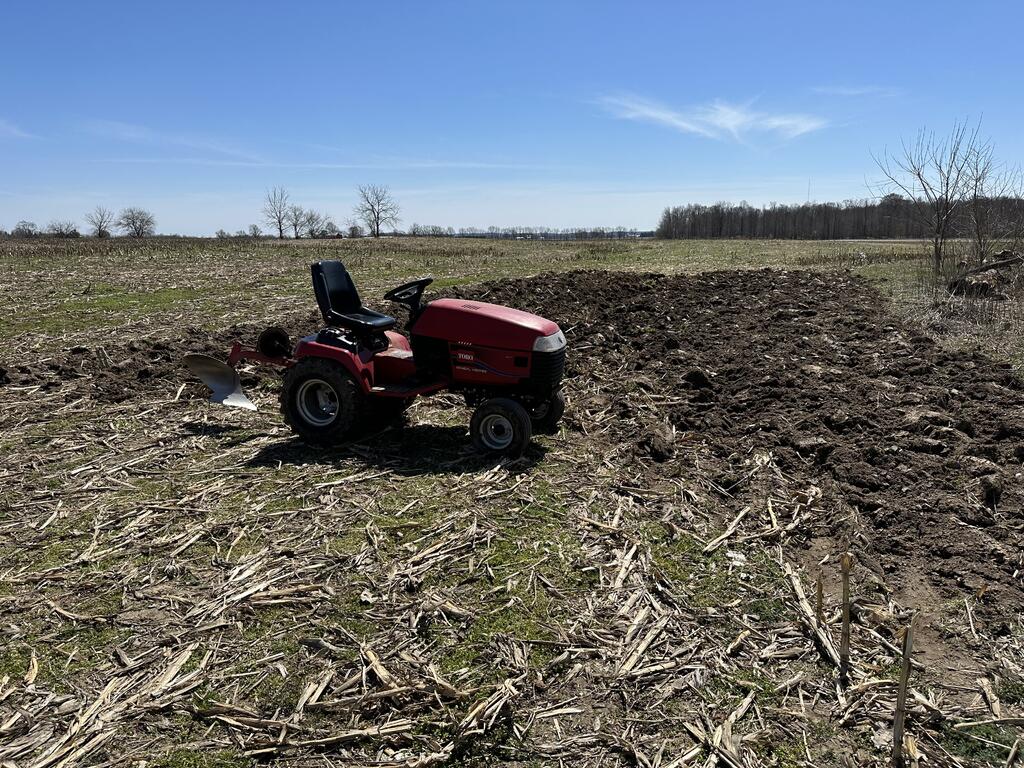

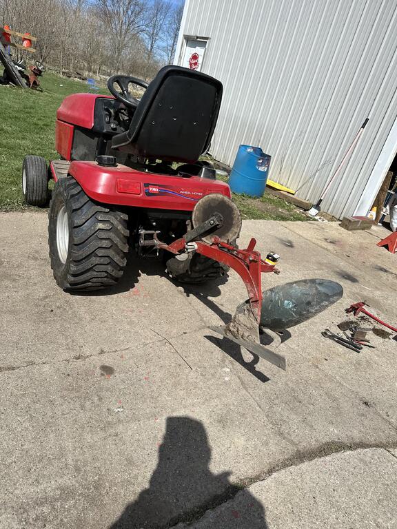

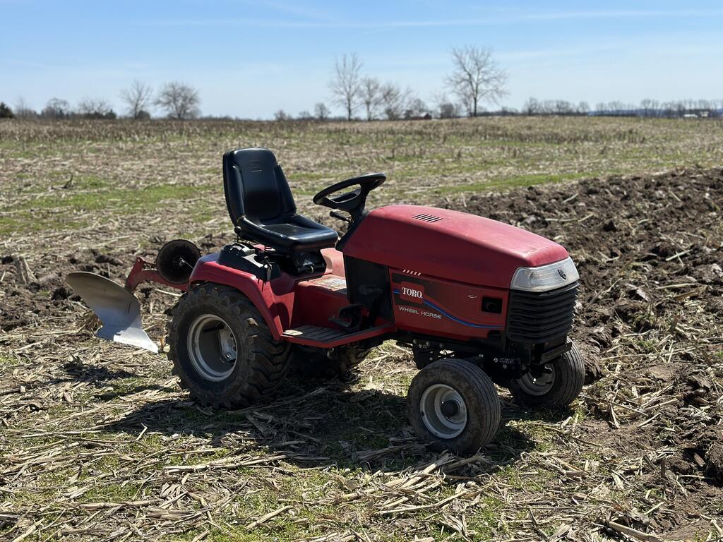

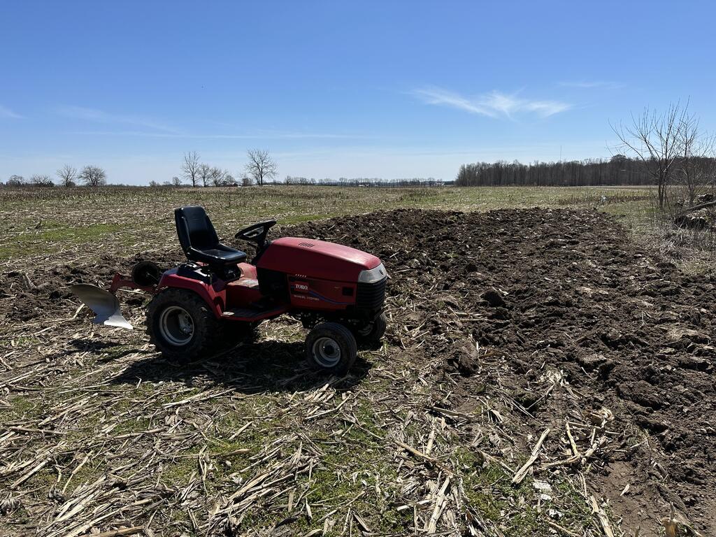

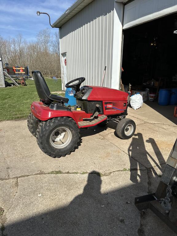

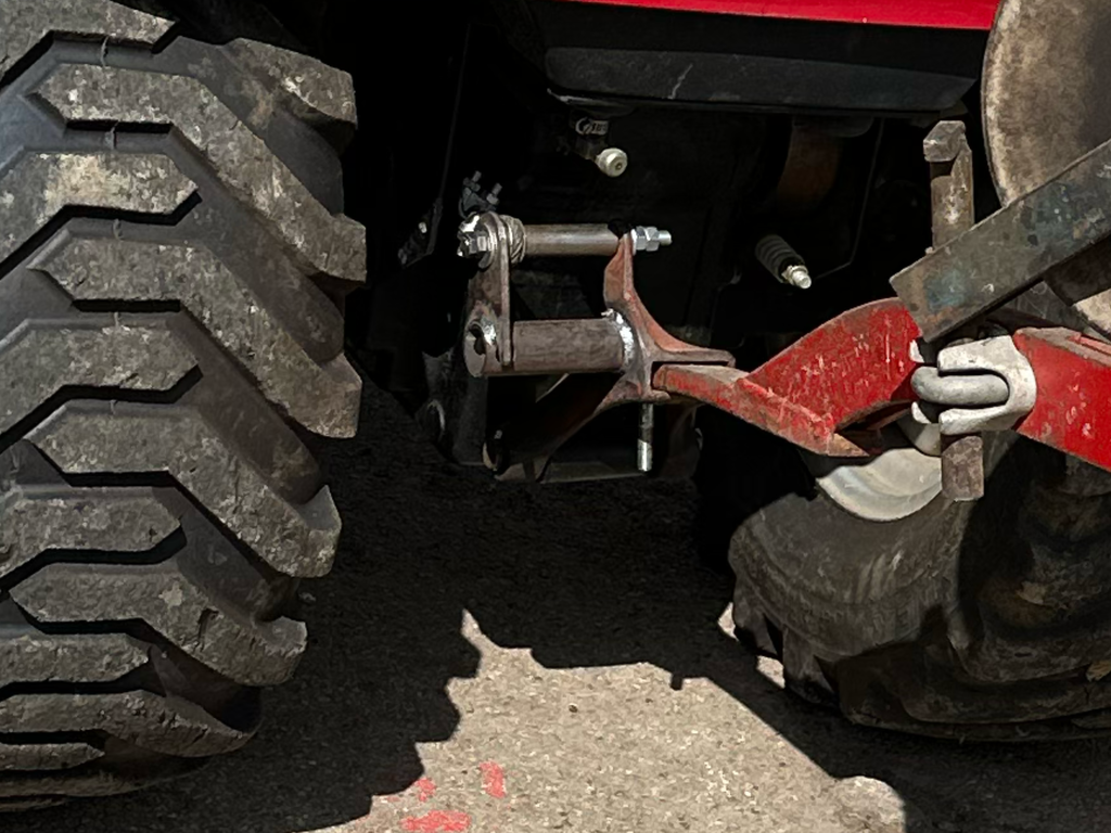

Pullstart 71,259 #77 Posted April 10, 2024 I sent @JoeM a message and he responded with delightful news. With a little modification to an older style slot hitch, and a piece of cable and some clamps I found in the shop, I was able to hook a 10” plow to this Xi. The loader is all stripped off it for paint, so I figured it would appreciate some run time after being in the shop for 2 or 3 years! Honestly we bought this in August of 2020, I think it was last used in September or October of that year. It’s time. I guess I haven’t updated this thread much, I am now running 26x12-12 OTR rear tires on stock wheels. During test and tune, there were no wheel weights, but I’ve added some 60 lb. Craftsman weights to each side. The front tires are little ribs, from the discount shelf at TSC. They are fluid filled with bead sealant and no tubes. The Xi is about 1,000 lbs, so I think it’s heavy enough to do the job, considering Putt Putt can pull this plow with about 3/4 the weight and less than half the power. 1 9 Share this post Link to post Share on other sites

Handy Don 17,484 #81 Posted April 15, 2024 Overkill for sure having only a single-bottom plow on that thing. New project (after the loader is done) -- two bottom plow! 1 1 Share this post Link to post Share on other sites
Pullstart 71,259 #82 Posted April 15, 2024 4 minutes ago, Handy Don said: Overkill for sure having only a single-bottom plow on that thing. New project (after the loader is done) -- two bottom plow! After the loader is done, as well as this thing did plowing, the loader should be a permanent fixture 3 Share this post Link to post Share on other sites
Handy Don 17,484 #83 Posted April 15, 2024 2 minutes ago, Pullstart said: After the loader is done, as well as this thing did plowing, the loader should be a permanent fixture Ah, yes. Good point! 1 Share this post Link to post Share on other sites

OoPEZoO 609 #85 Posted April 24, 2024 Careful......you're going to end up liking that so much that your going to need a 2nd 5xi so one can handle the loader and one can plow....LOL Any thoughts on how much weight you think that rear hitch can lift with the on-board hydraulic cylinder? I've been considering an attempt at rigging something up to the back of my xi to use as a sort of log skidder. Kinda like a mini 3-pt. Our property backs up to a tiny creek that is absolutely full of medium sized downed trees and debris. My #1 project for the summer is to use the tractors to get it all out, chip what I can, and dispose of what I can't. So far, I have been focusing on winching using other large trees as anchors and ****** blocks, but watching your videos using the rear lift got me thinking. It would certainly speed things up......just not sure if it could handle the 200lb or so to get a few inches of lift on a downed tree 1 Share this post Link to post Share on other sites
Pullstart 71,259 #86 Posted April 25, 2024 @OoPEZoO this plow is not a challenge for the 953. That said, I’ve never seen it plucked that fast from the ground! I’d also imagine a larger diameter cylinder would increase the lift capacity if needed. Everything seems tough enough to handle it. Share this post Link to post Share on other sites
PeacemakerJack 11,061 #87 Posted April 25, 2024 Great video Pullstart! Makes me think I should try mommas Big D sometime at plowday🤔🤔🤔 1 Share this post Link to post Share on other sites
Handy Don 17,484 #88 Posted April 26, 2024 On 4/24/2024 at 4:52 PM, OoPEZoO said: ny thoughts on how much weight you think that rear hitch can lift with the on-board hydraulic cylinder? ......just not sure if it could handle the 200lb or so to get a few inches of lift on a downed tree Perhaps stupidly, but.... When I put the sleeve hitch on a 500, including the cable lift line, I tested it by standing on the hitch and having a helper work the control. Lifted my ~210 lbs without any sign of strain. My personal guess would be that the weakest point is one of the ¼” pins in the cable clevis ends and it’d shear at 300-ish lbs. 1 Share this post Link to post Share on other sites
