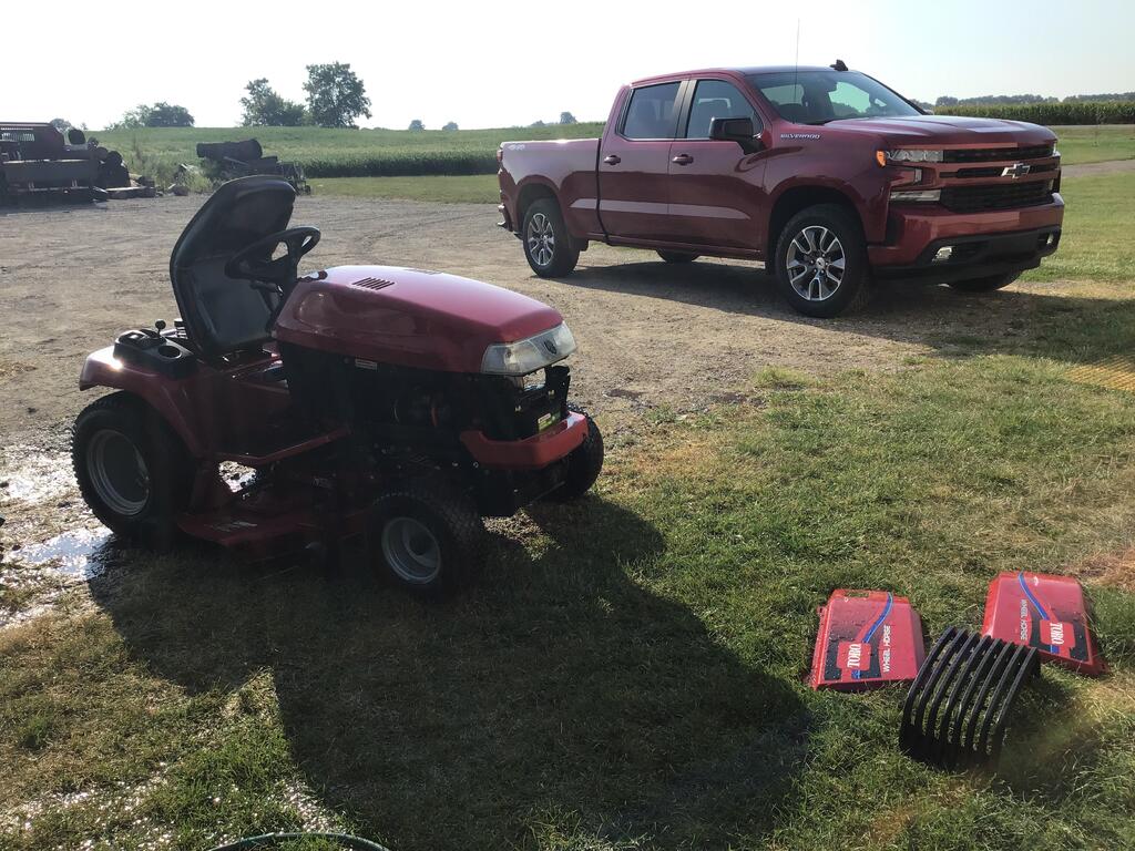

JoeM 10,318 #12 Posted August 17, 2020 Some folks shy away from the xi's and I figure they are a little more difficult to work on as compared to the earlier 520H tractors. I think they are a best kept secret. I have several of those now and I figure as you found out, taking off the main tin is a engine puller. I use an 1/8" brake line attached to the blow gun to get in and under the fly wheel area. Weaknesses, smart spark coils is one. Kohler makes a kit from for just over 100$ that will retro fit to standard magneto coils if you loose a coil. Another is the voltage detection unit (battery charge). Not available but it just operates the idiot light on the dash, taking the bulb out best fix. Smart turn steering, decreases hydo engagement when the steering wheel is turned, you either love it or hate it. Can be tubed to see how to disabled easily. And the last thing is the seat switch. All of the power for the ignition is run through the seat switch and if the switch gets any resistance things get erratic. (Smart spark and liquid cooled engines) Congrats on the find! and hey looks like the grill is intact! 2 1 Share this post Link to post Share on other sites

Pullstart 71,563 #14 Posted August 17, 2020 I have heard about the foam seal, I see one torn between the engine and “firewall”. What does this tear effectively allow or prevent? Share this post Link to post Share on other sites
JoeM 10,318 #15 Posted August 17, 2020 30 minutes ago, pullstart said: foam sea keeps the cool intake air from mixing with the hot air in the engine compartment. I have replaced one with some cheep window foam from wally world. seems to hold up okay. Toro is very proud of thiers. 1 Share this post Link to post Share on other sites

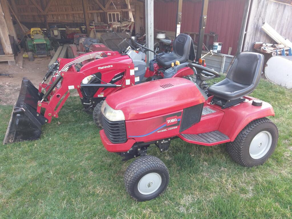

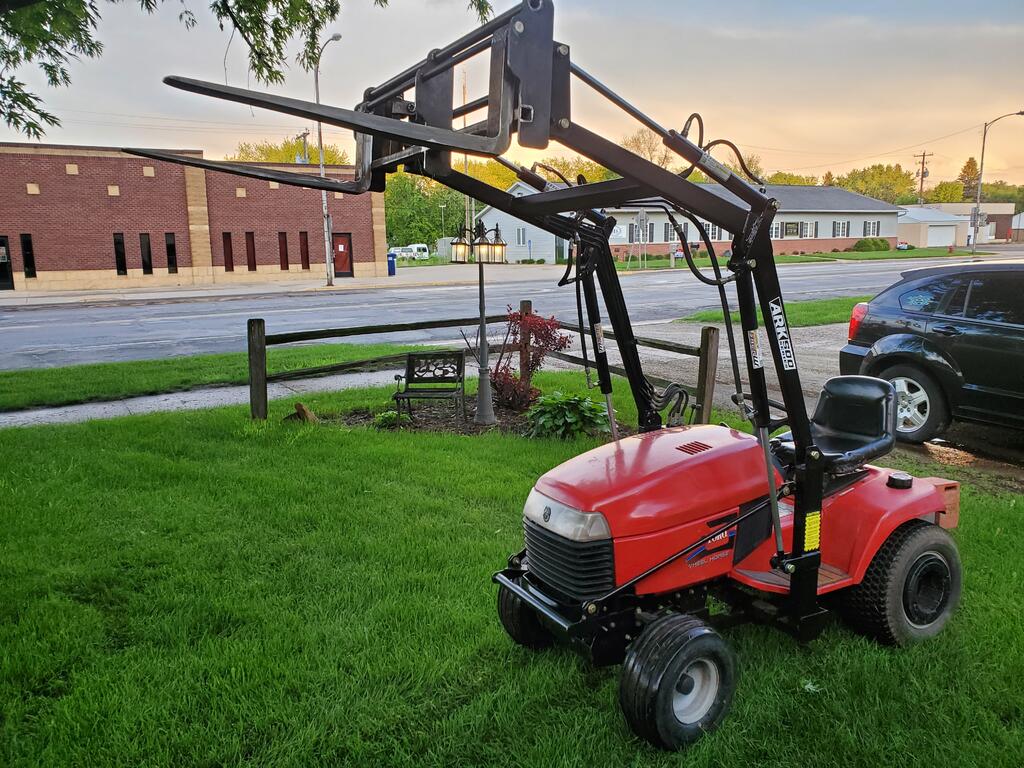

Shynon 7,730 #16 Posted August 17, 2020 I like mine with my loader on it. Just need to get the powersteering on it. 2 1 2 Share this post Link to post Share on other sites

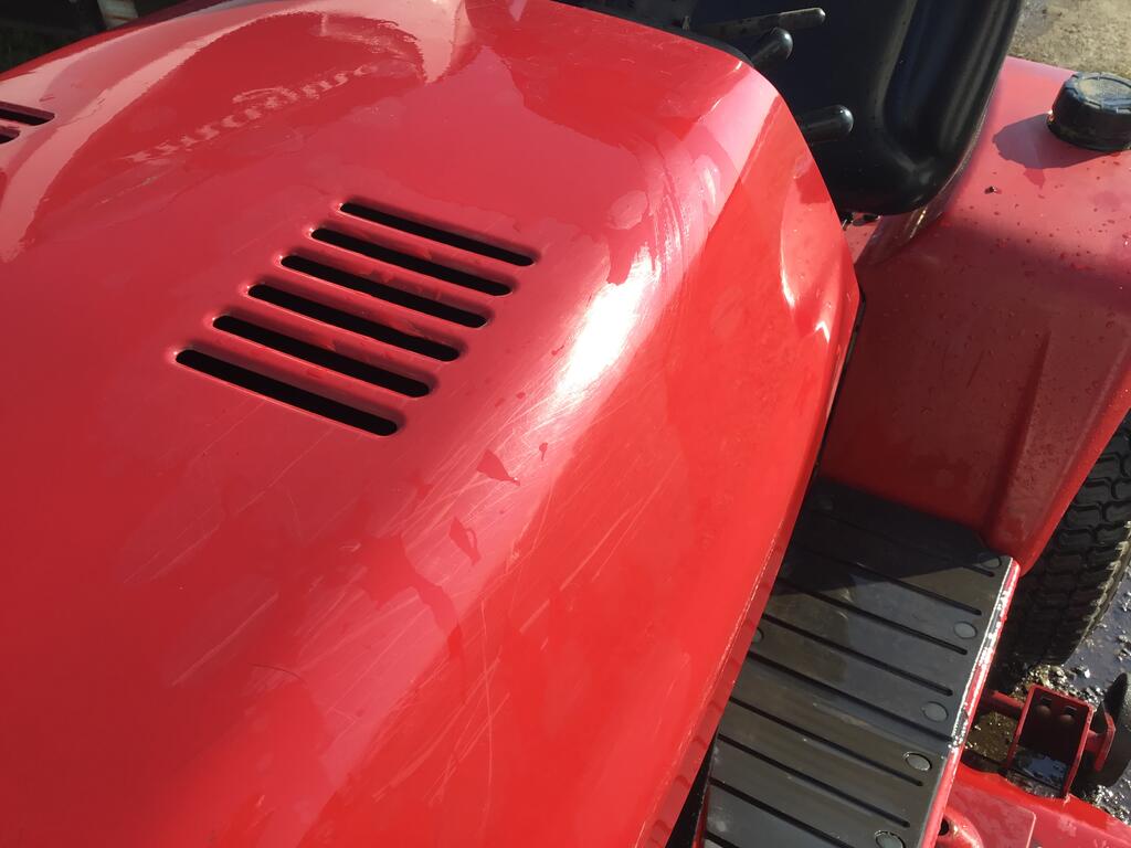

Pullstart 71,563 #23 Posted August 24, 2020 I gave this beast a bath today, and while I still think of a name I consider if I should wet sand the brush marks out or leave it as is as a worker? 1 Share this post Link to post Share on other sites
