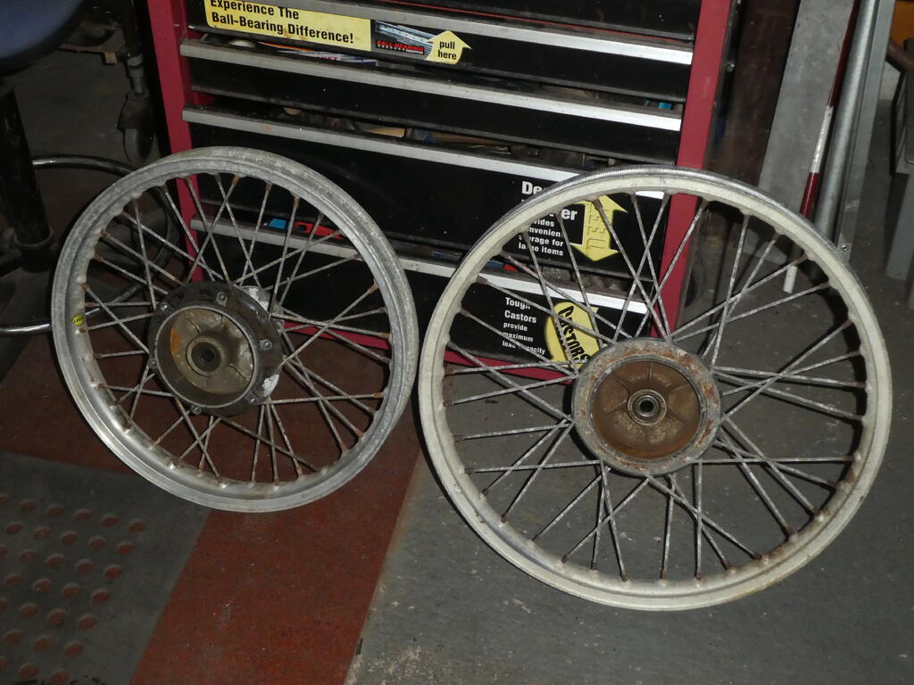

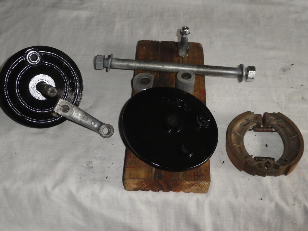

Stormin 9,987 #16 Posted August 25, 2020 Todays been a real washout. None stop rain. So it's been a workshop day. These parts are now finished and will be wrapped up and put away. Started on the wheels today. First the rear. Removed the brake plate and then the shoes. Cleaning the old paint off the brake plate took a while. Much scraping and wire brushing. Then it was primed. Later it got a first and second coat of top coat. Getting the tyre off was a right fight. It still had air in. Not bad for standing for 20yrs. My valve removal tool seems to have gone awol, so I got as much air out as I could by pushing the valve down. Next broke the beads with the use of a G clamp. Then the struggle started. The tyre side wall goes well down in the rim. About an inch. With the use of one long lever and two short ones, plus a big screw driver, the tyre succumbed. Pulling the tube out with some air still in it, was a struggle as well. Gave the wheel a bit of a clean up, then put it on one side. Next, the turn of the front wheel. Brake plate got the same treatment as the rear one. That and the brake arm are now awaiting a second top coat. That's it for today. Seven and a half hours is enough. Wheel will get the tyre removed another day. 4 Share this post Link to post Share on other sites

Stormin 9,987 #20 Posted August 27, 2020 Got the tyre off the front wheel today. Then, like the rear, got a bit of a clean up. The spokes and the hubs are going to take some work and time, to clean up and re-paint. Brake plates got finished. 5 Share this post Link to post Share on other sites

Stormin 9,987 #22 Posted September 4, 2020 Picked the frame and swinging arm up from the powder coaters this morning. Well pleased with them. Wheel hubs and spokes got cleaned up Wednesday and finished Thursday. Really time consuming. The remaining paint on the hubs had to be carefully chipped and scraped off. The spokes rubbed down with emery cloth. Hubs got a first coat of paint this afternoon. Brush painted with one of Carols 3/4" wide artists brushes. Next week I start the hunt for parts. 1 2 Share this post Link to post Share on other sites
