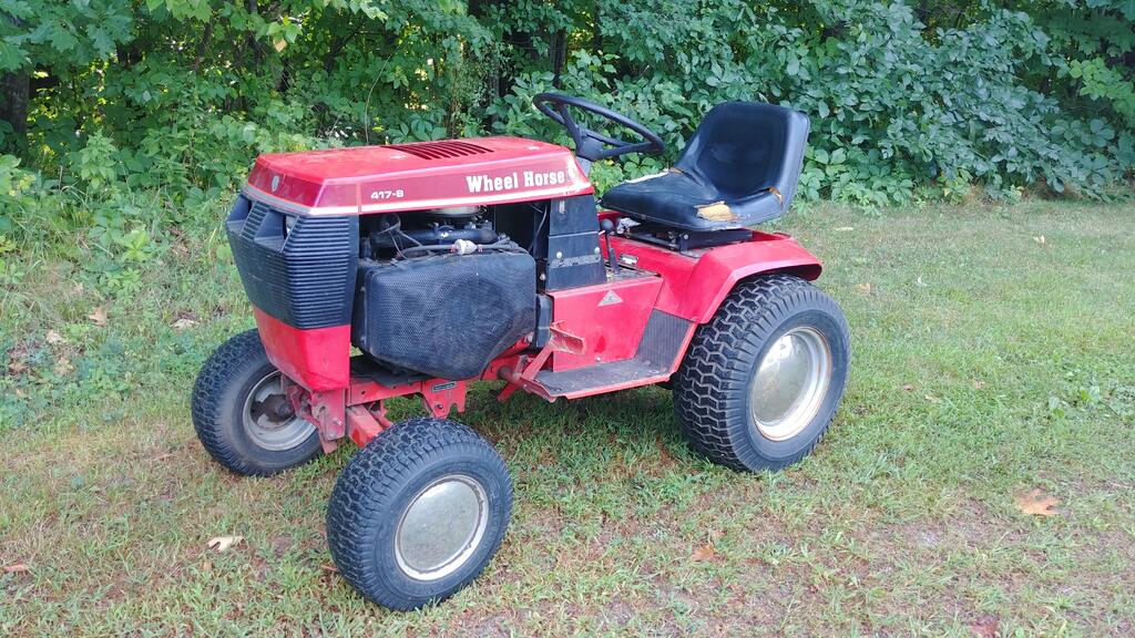

Seth Powers 35 #32 Posted August 27, 2020 Well, I got all the belts, replaced the oil, transmission fluid, put in new spark plugs, new blades, changed the air filter, and put the deck back on. It ran great for about 35 minutes, cutting beautifully until it suddenly died and it won't start. Not the inaugural run I wanted to experience. It seemed to lose power so I paused about 45 seconds before this happened so I stopped the pto and it seemed fine, so I continued until it died. Seth 1 Share this post Link to post Share on other sites
Seth Powers 35 #33 Posted August 27, 2020 Here it is, minus the deck. 2 Share this post Link to post Share on other sites

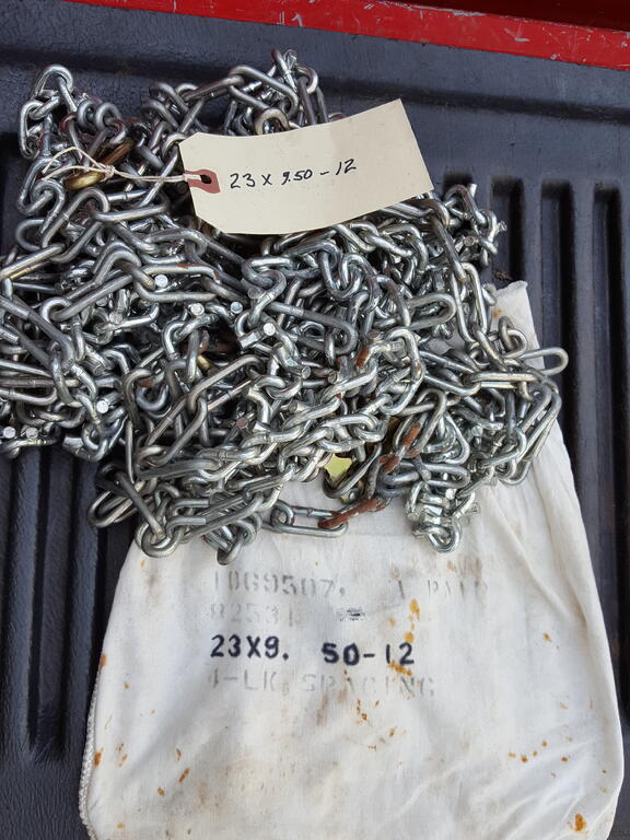

Seth Powers 35 #44 Posted September 9, 2020 On 8/19/2020 at 12:37 AM, Joe Warren said: I may have new chains. What size are your tires? Hi Joe, the rear tires are 23 x 9.5 -12. I will need chains for winter. Seth Share this post Link to post Share on other sites
Joe Warren 94 #45 Posted September 16, 2020 Hi Seth. My apology, I missed your earlier reply. I do have have a set of chains for your 23 x 9.5 -12 tires. Email me at joeww121@gmail.com if you are still interested. thank you, Joe Share this post Link to post Share on other sites

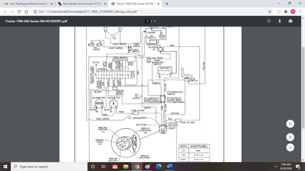

Seth Powers 35 #47 Posted September 27, 2020 On 9/16/2020 at 7:33 AM, 953 nut said: For testing purposes to eliminate any and all electrical components (except the points/condenser/coil) you could make up a small jumper wire directly from the coil "+" to the battery "+" to see if that allows dependable operation. Okay, so I replaced the points, the condenser, and the thing with three metal things (AC/?/?) that has something to do with electrical...sorry, I can't remember the part now. Anyway, when the tractor is running it shows a smidge under 12 volts which explains why it dies after about 30 minutes of use, because it is draining the battery. Now, we rigged up a wire directly from that thing with the metal things that has something to do with electrical (sits on the left side of the engine, up top on mine) from there to the battery, it actually showed between 13-14 volts. Aside from that, I am at a loss. The problem is electrical, but what is wrong? Share this post Link to post Share on other sites
ebinmaine 80,955 #48 Posted September 27, 2020 Pics would help a lot with the descriptions. I'm thinking you may be working with the voltage regulator? Do you have an amp gauge? Have you tried physically following the wires from the engine to the VR to see if there's a break or a bad connection? I ask about the ammeter because it could be at fault. Share this post Link to post Share on other sites
953 nut 69,825 #49 Posted September 28, 2020 On 9/26/2020 at 10:29 PM, Seth Powers said: Okay, so I replaced the points, the condenser, and the thing with three metal things (AC/?/?) that has something to do with electrical...sorry, I can't remember the part now. Anyway, when the tractor is running it shows a smidge under 12 volts which explains why it dies after about 30 minutes of use, because it is draining the battery. Now, we rigged up a wire directly from that thing with the metal things that has something to do with electrical (sits on the left side of the engine, up top on mine) from there to the battery, it actually showed between 13-14 volts. Aside from that, I am at a loss. The problem is electrical, but what is wrong? The component you have described is the Voltage Regulator/Rectifier. The wire from the center terminal of the R/R is probably a White wire and should go to the "R" terminal on the ignition switch. 1 1 Share this post Link to post Share on other sites
ebinmaine 80,955 #50 Posted September 28, 2020 @Seth Powers If you have a YouTube account you're welcome to take a video showing the things that you're looking at so we can all see it. I've been known to do that myself on several occasions. I'm quite confident we'll all get this figured out together and I know it's kind of a long drive but the offer is on the table for you to bring that over and Trina and I will take a look at it. Don't be scared off by electricity at all. Water and electrons act in much the same way but the terminology is a little different. 1 Share this post Link to post Share on other sites
