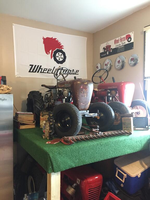

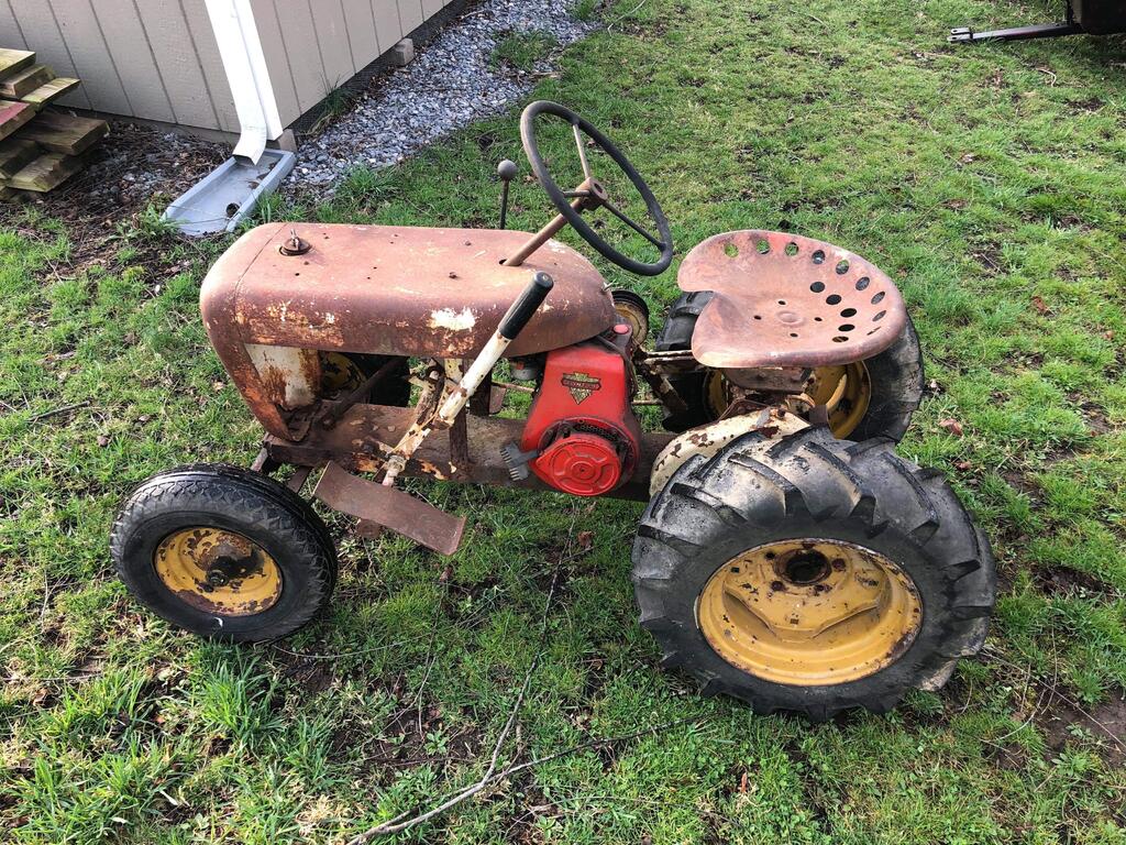

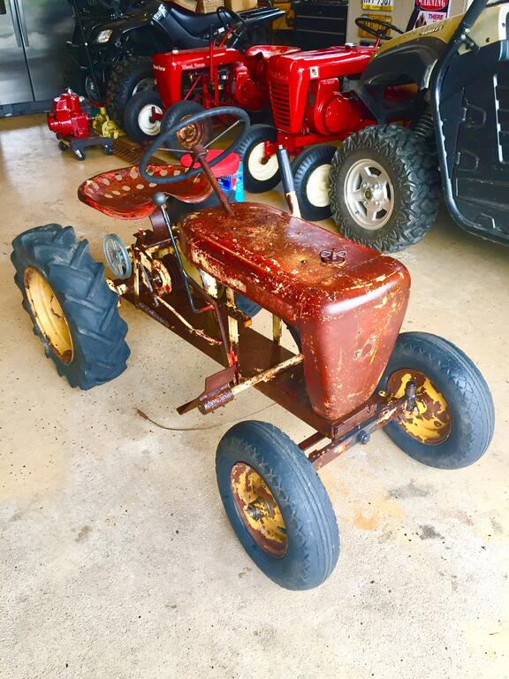

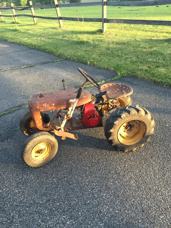

Ol’ Crusty the 1956 rj-35

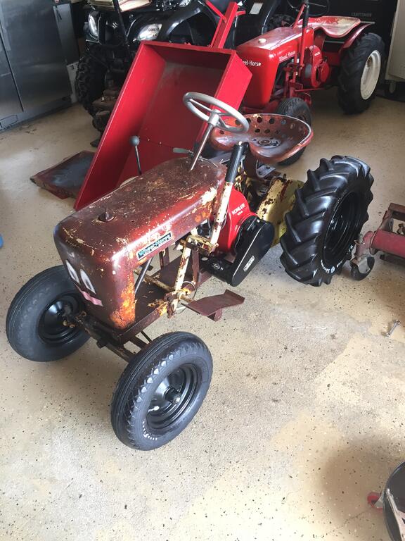

Wow another nice one! :handgestures-thumbupright:

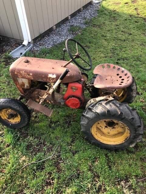

Couldn't do anything to save the Clinton?

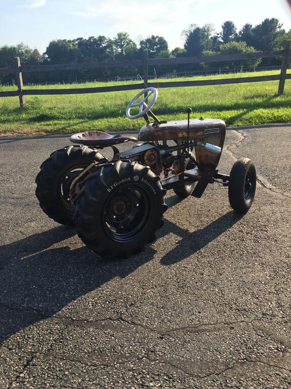

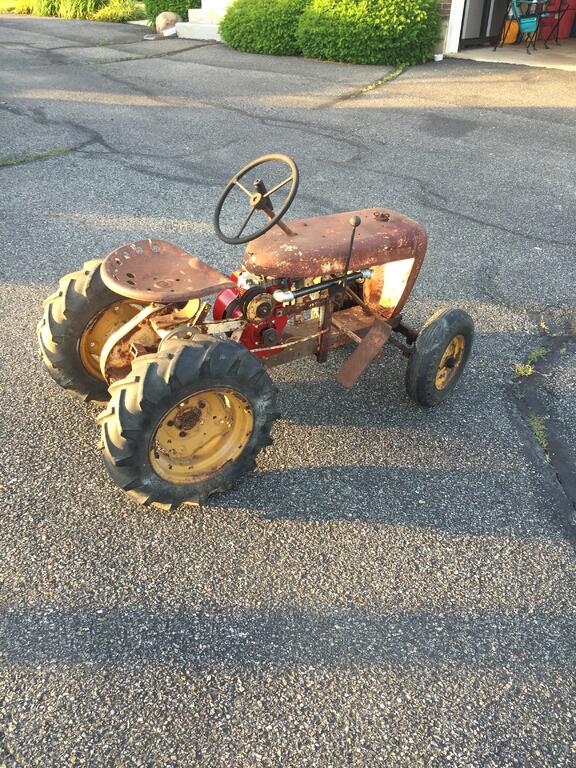

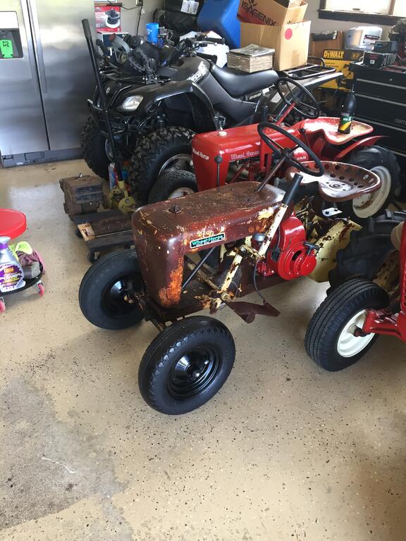

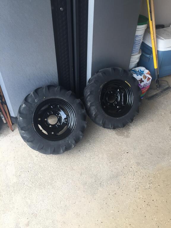

Thanks for the compliment!

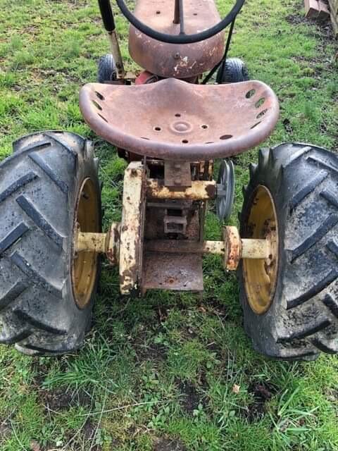

the Clinton on it was a later model that was not proper for the tractor anyway so I had worked a deal with the seller not to include it when I got the tractor.

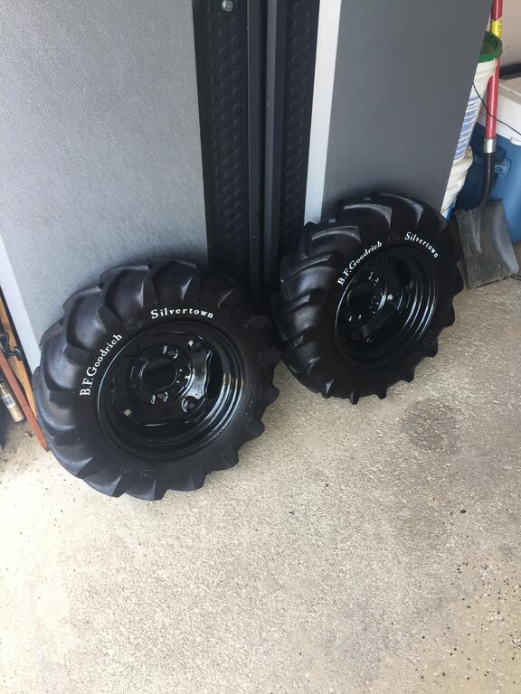

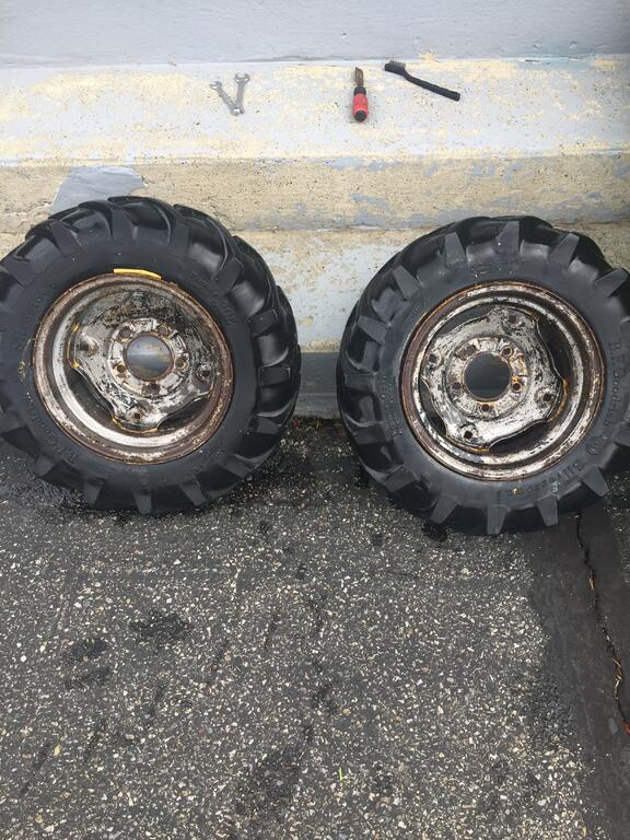

when I did these tires I cleaned them good then sprayed them with Dupli-Color tire paint. Which is really more like a dye. It’s watery and soaks into the rubber. After that I used a white tire paint marker and did the lettering. I had to go over the letters twice to get an even coat.

Very nice. I actually like the look of the fresh tires / wheels / engine on the contrasting patina body panels.

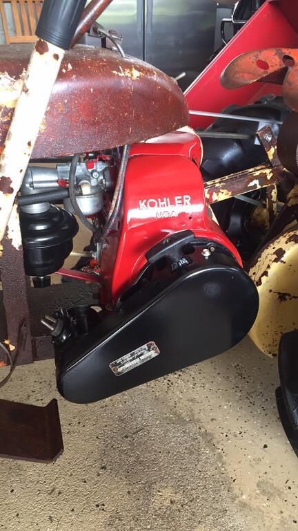

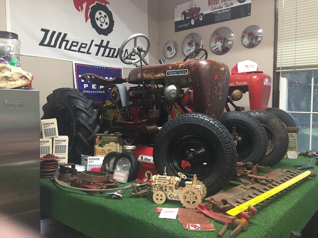

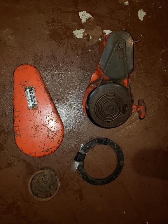

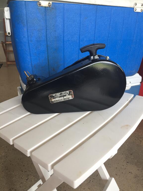

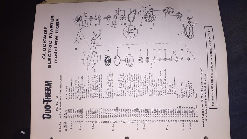

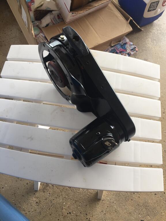

Lots of talent going on !! I am super interested in the history of that electric start option tho. Does anyone have any more information on it? Very Cool!
chompinthebit

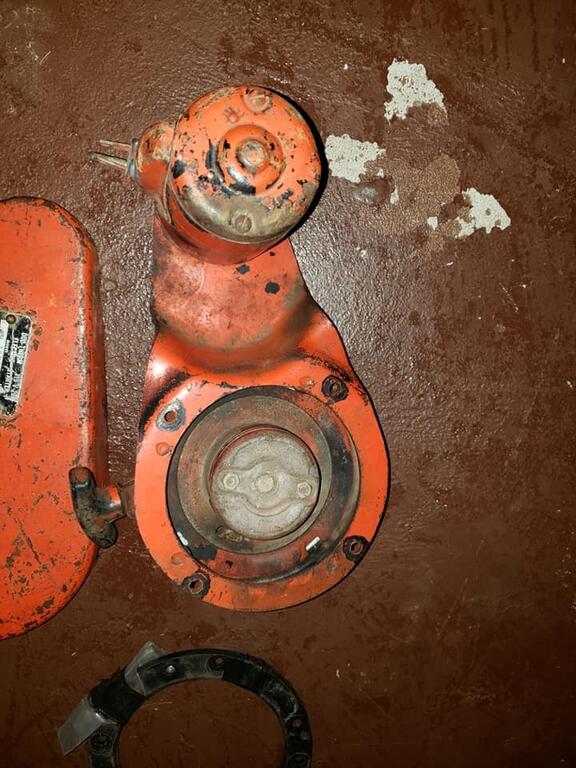

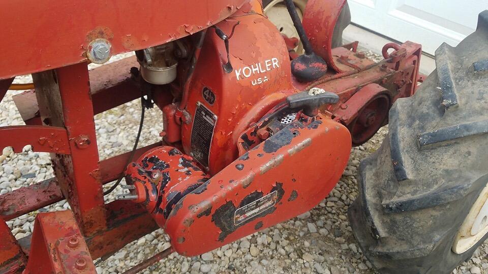

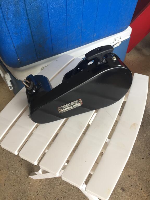

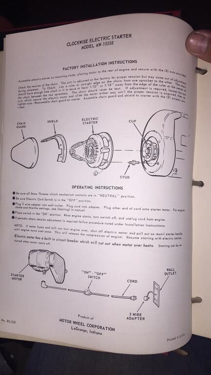

They were made by a company called Motor Wheel Company and branded as Duo-Therm. I know there were several variations for a bunch of different engines. They use a small 115-120v electric motor and would have came with a chord with a online switch. The motor drives a chain, internally there is a sprocket on the recoil side that engages the recoil and it has a cup similar to one for a regular recoil starter. The unit can be mounted in different orientations also. I have around 3 or 4 manuals for different models that I got with REO mower binders
i attached some more pictures of info I have and such.
  • Heart 1
bottjernat1
Wow Super cool! Thanks for all the information!
bottjernat1
Try to google this starter you cant find anything! makes it even more super cool! I see the mail says lagrange indiana. I live by there

What a tractor!  I honestly believe I like this one more than the restored one!

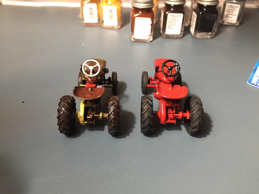

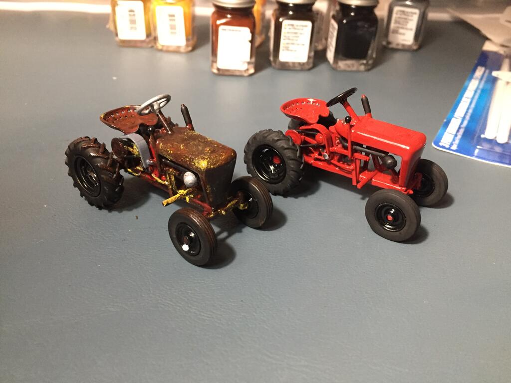

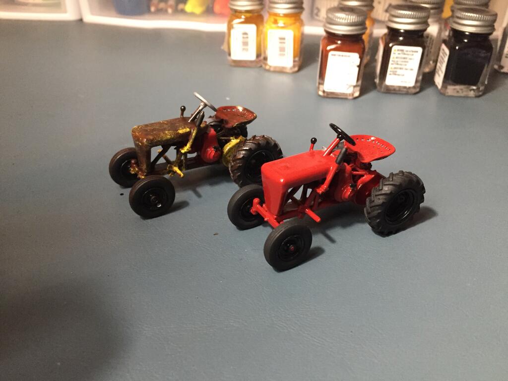

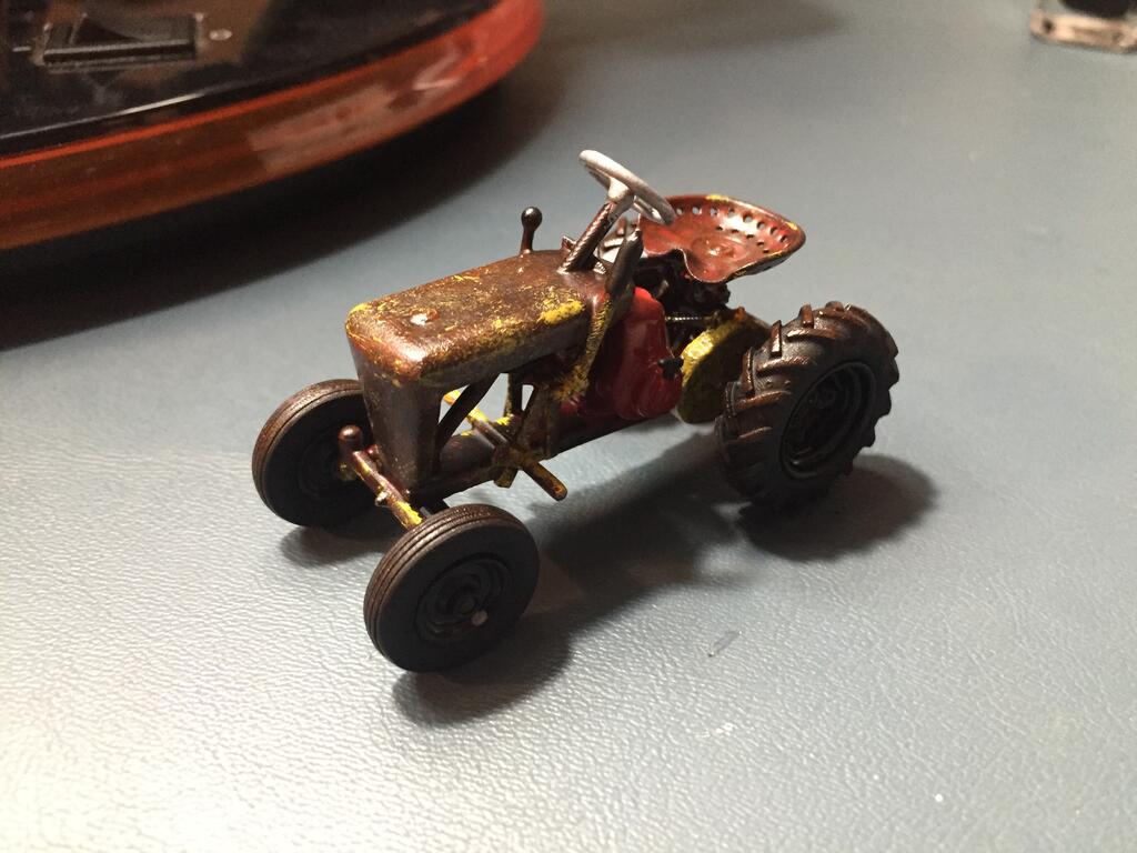

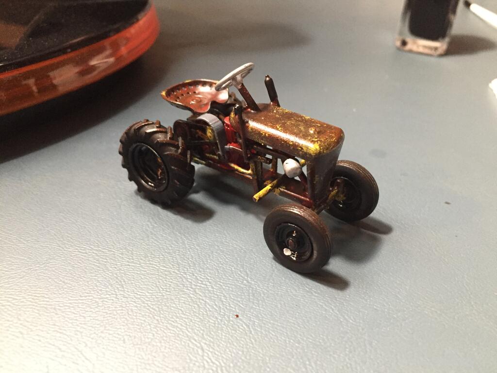

Very good job on the RJ WERE DID YOU  GET THE 1/25 SCALE RJ'S ?
:rolleyes: PM'd you the FB link.

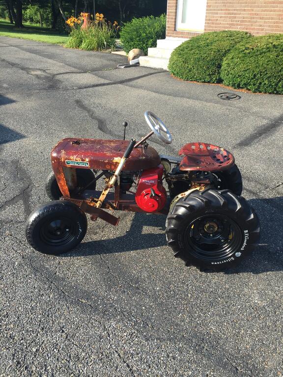

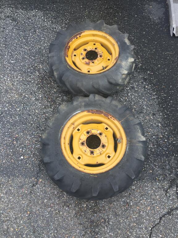

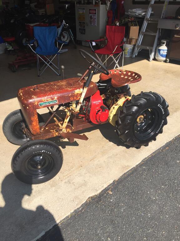

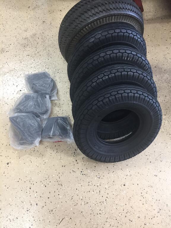

Put new front tires on yesterday, I think it really made a difference. They look much closer to the original BFG silvertowns
