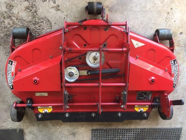

tom2p 2,396 #5 Posted August 12, 2020 (edited) keep blades sharp - rpm up but as others in prev posts mentioned - RD deck typically will not spread grass clippings as well as a similarly sized SD deck I currently use SD deck more often than RD - but cut for decades with a 704 and 312-8 with RD decks compared to SD deck - gotta keep the RD deck slightly higher (cut less grass) to minimize grass clippings from clumping behind the deck also - keep the front of the deck slightly higher than the rear can also add a deflector to the rear portion of the deck (as shown below) Edited August 12, 2020 by tom2p 1 Share this post Link to post Share on other sites

953 nut 69,827 #13 Posted August 23, 2020 On 8/12/2020 at 5:51 PM, T1000 said: The mower deck used to throw grass well and now its just dropping it and leaving a nice trail of clipping as I go along. Is the deck a side discharge deck? If a side discharge deck isn't throwing clippings it could be the RPMs of the engine are not high enough or as Garry said, the wrong pulley on the PTO being used. If your deck is a rear discharge like @tom2p pictured then it is doing what it was designed to do. Share this post Link to post Share on other sites
