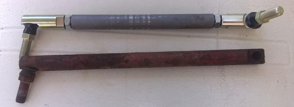

Herder 2,356 #5 Posted August 12, 2020 I copied this pic from another link, the upper tie rod is stock and the one below it I was made by another member. I nice job I might add. What has happened to yours is the ball has separated from the socket. You may be able to push them back together and wire tie it temporary until you get a replacement. And no tightening up the nut will not solve your problem. Good luck. 2 Share this post Link to post Share on other sites
