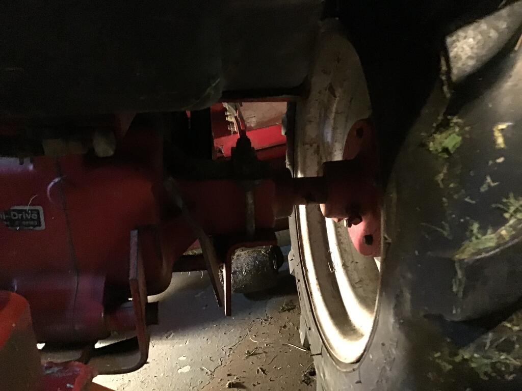

UncleT 2 #1 Posted August 12, 2020 Howdy guys, been years since I’ve been on here posting had to reset things. Anyway, have a problem with my 1991 416-8 tractor hoping y’all might have an answer too before I tear this thing apart..... While mowing down a hill, my tractor seems to goes out of gear, coasting, goes about a foot or two and reengages. Then, when you go up a hill, it hestitates, then reengages. Belts are near new and clutch and seems to be working ok. Any ideas? Thanks for any replies. Share this post Link to post Share on other sites

Bill D 3,065 #3 Posted August 12, 2020 Clean the ends of the hubs and input shaft. Mark the hubs and axle along with the pulley and input shaft. Drive the tractor then check if the marks you made are still alligned. If not then you have a sheared key on either your input shaft or axle shafts. I agree with John that the behavior you describe sounds more like hydro behavior. Bill 2 Share this post Link to post Share on other sites
stevasaurus 23,787 #4 Posted August 12, 2020 He said it was an 8 speed, so...no way this is popping in and out of gear. It has to be the wood ruff keys and slop between the wheel hubs and the axles. I doubt it is the input pulley and shaft. The good thing is, you do not have to open the transmission. Do what Bill said and then pull the tires and hubs...check the key ways and keys. Share this post Link to post Share on other sites

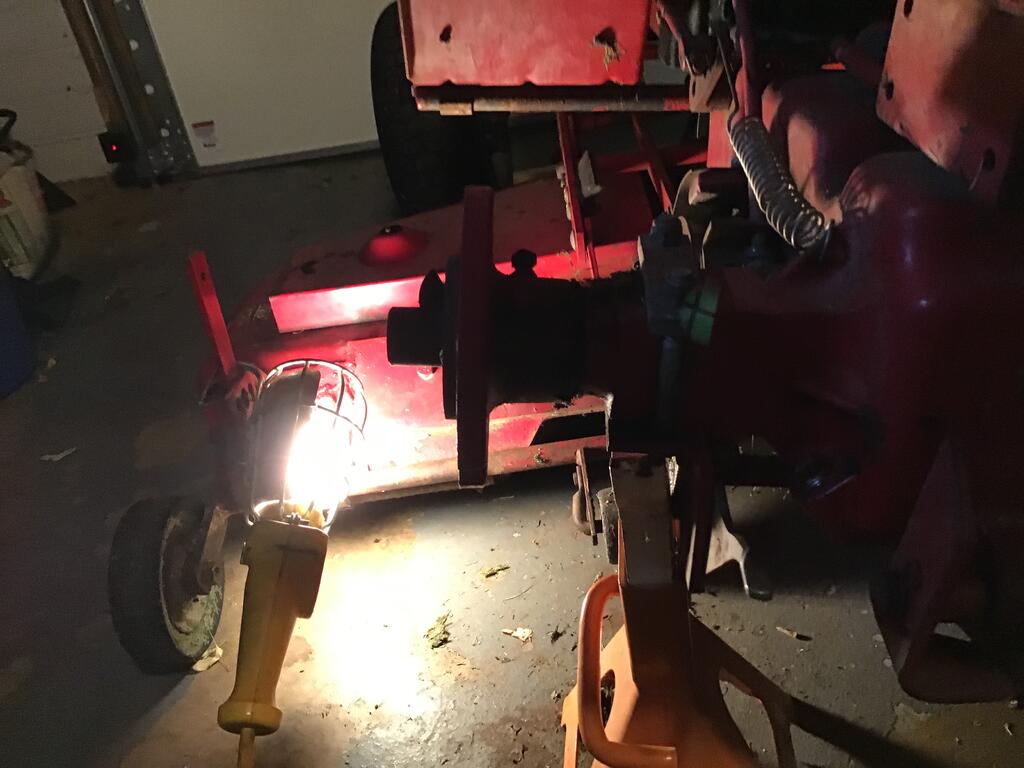

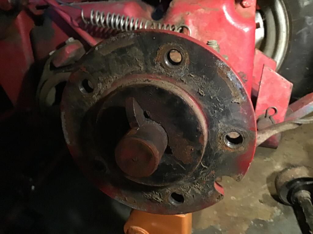

UncleT 2 #5 Posted August 14, 2020 I have a feeling the Woodreff Key isn’t suppose to look like this, is it? Thanks for the replies and help fellas. The shaft turns for about a quarter of a turn then it catches wheel. Any ideas how to get this thing off with destroying the shaft? And I notice the right side axle is about two inches from the axle housing but flush on the left side, is that normal for these machines? Share this post Link to post Share on other sites
RJ Hamner 1,029 #6 Posted August 14, 2020 There are things NOT to do. The hubs are cast iron and can fracture making the part unusable. Try soaking it in PB Blaster or another like product for a day or two then with a rubber hammer try tapping the hub to get it off the axle. If this fails your going to need the CORRECT type of tool to remove it. There is a section on the site for special tools/owner made tools that will give you some ideas as to the correct way to remove the hub. Don't ask me how I know so much about shattered hubs. Been there. Done that. 2 Share this post Link to post Share on other sites
Bill D 3,065 #7 Posted August 14, 2020 I would try removing that key with a pair of side cutting pliers. Use them to rock it up and out. Plan to purchase a new key when you do that. You will need to make a puller to get that hub off. There are pictures of various types of pullers on here. Buy new set screws as well. Also, the clutch return spring in the last photo is incorrect. It looks to be very weak. That would cause belt slippage which would also cause the problems you are having on hills. Please post some more pictures of the clutch return spring as the linkage may not be hooked up properly from what I can see. The spring hooks into the small hole on the arm, and the trunnion in the large hole at the top. Bill 1 1 Share this post Link to post Share on other sites

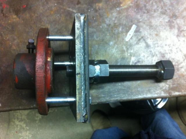

RJ Hamner 1,029 #8 Posted August 14, 2020 I just remembered that I took a picture if the tool I made to remove hubs. The whole idea is to keep even pressure on the part during the process. The plate looks pretty heavy duty (the wife tells me that I tend to "over build. I just call it "Hell for Stout) but that's what I had in the scrap bin. The all thread and nuts are from Tractor Supply. 4 Share this post Link to post Share on other sites

stevasaurus 23,787 #10 Posted August 14, 2020 @UncleT, you have to get the key out of there first. Usually, I would grab the key with a pair of side cutters and pry out...try that first. Second, take an old chisel and hit it with a 2 lb ball peen hammer right into the key...coming at it from the length of the axle and then pry. The key is soft metal and it may just come out doing this method. Third, cut that key with a saws-all or hack saw and file it smooth to the axle...now you can try to pull the hub off the axle. Make sure you file any burrs on the end of the axle also. Your right side hub looks like it is OK. The hub should be flush with the end of the axle. Share this post Link to post Share on other sites

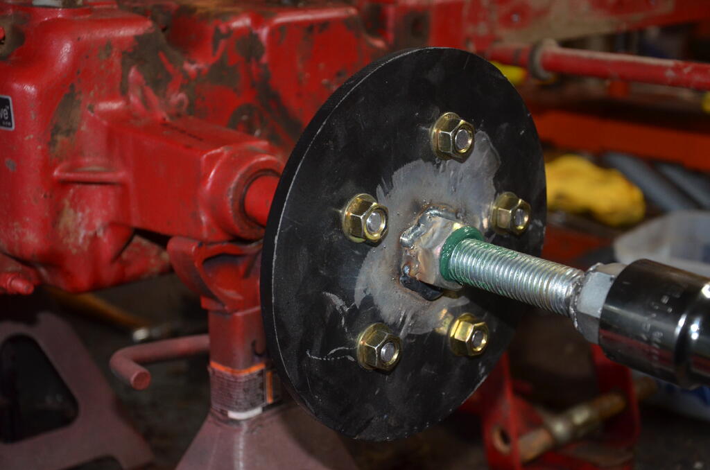

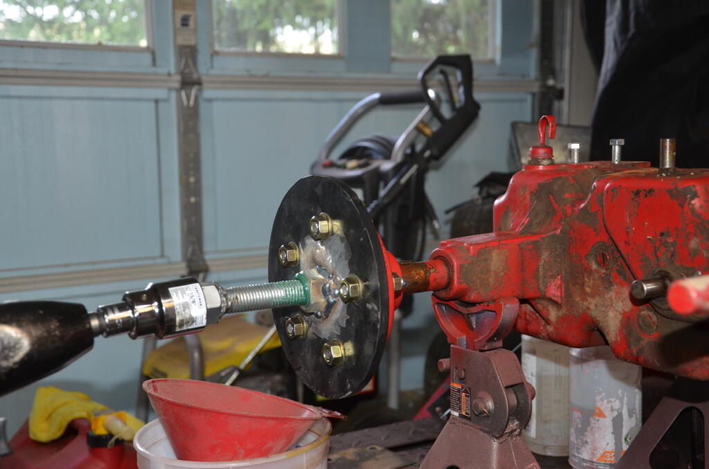

squonk 47,805 #11 Posted August 14, 2020 Here is a pic of the hub puller I made. I use a fine thread screw for more pulling power. 3 Share this post Link to post Share on other sites

UncleT 2 #19 Posted August 18, 2020 Well guys, with a little patients and persistence I got her apart. Just waiting for a new axle seal and retention clutch spring to put her back together. The woodreff key is even in good shape. The hub finally broke loose and slipped right off. Got lucky on this one..... Appreciate all the help and advice. You guys are great. Need more folks as gracious as y’all. I had a neighbor tell me to use brake fluid as a rust buster if the the rust blaster didn’t work. Not sure if that’s what did it, but after I did that, and let it set for 48 hours, it popped. So, there’s that if you never tried that before. I never heard of it before he suggested it. 🤔 . 1 1 Share this post Link to post Share on other sites
