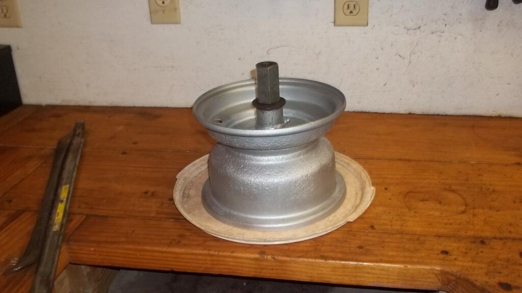

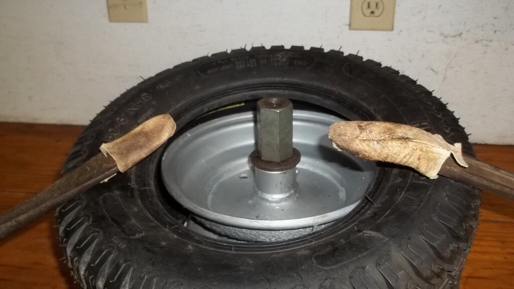

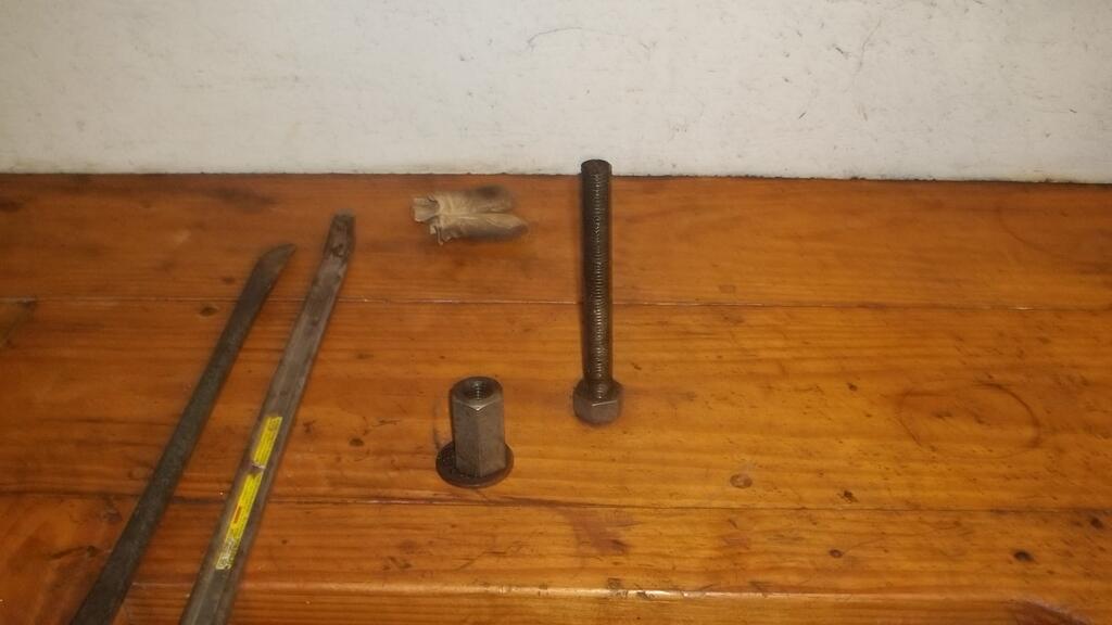

953 nut 68,824 #14 Posted August 12, 2020 For the front tires I have a piece of 3/4" all thread through the work bench, holds the rim in place well. To protect the newly painted rims I cut the fingers from some old leather gloves an slip them over the tire irons. 4 1 Share this post Link to post Share on other sites
