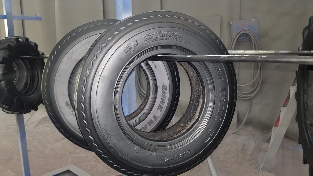

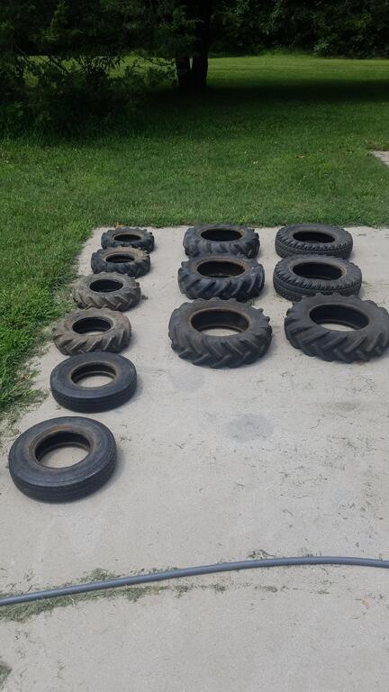

rmaynard 17,102 #3 Posted August 11, 2020 (edited) I have a old friend who worked at the local Goodyear retread plant here in my town. I asked what his job was and he said he was a tire painter. I asked what the big guys use to paint tires and he told me that is is just black latex paint. Below is a set of tires painted with a mixture of Behr exterior latex satin paint (color Baluga), mixed 50/50 with water and applied with an HVLP gun. Edited May 25, 2021 by rmaynard 5 4 3 Share this post Link to post Share on other sites

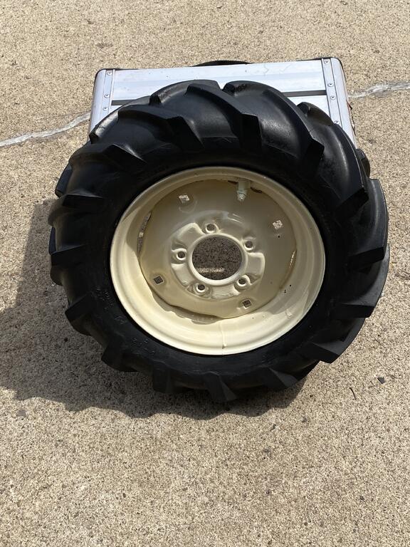

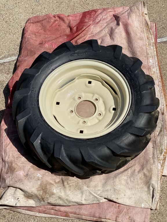

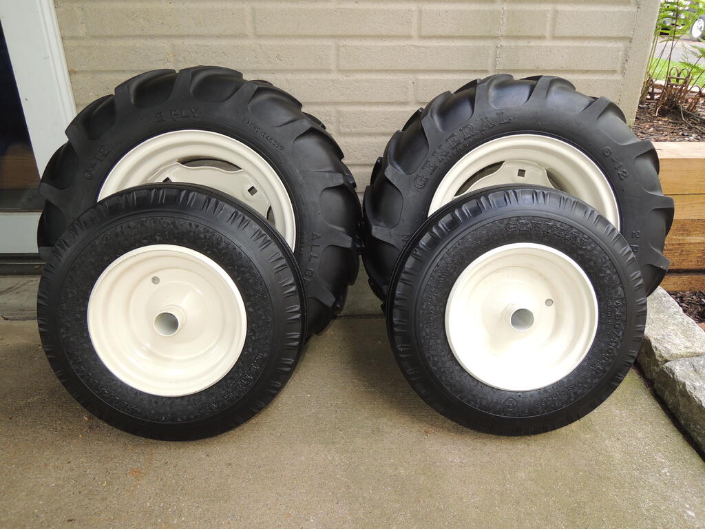

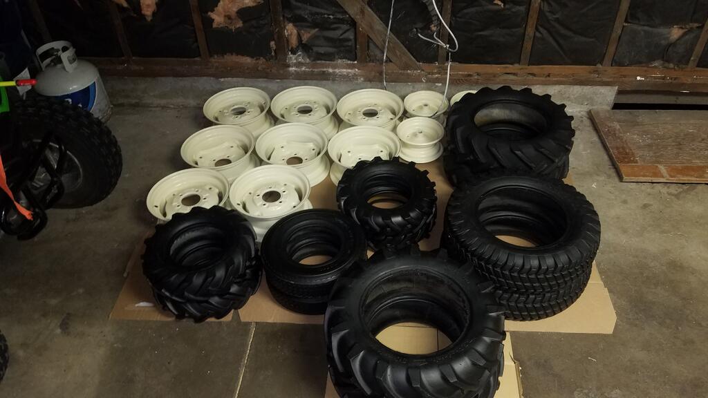

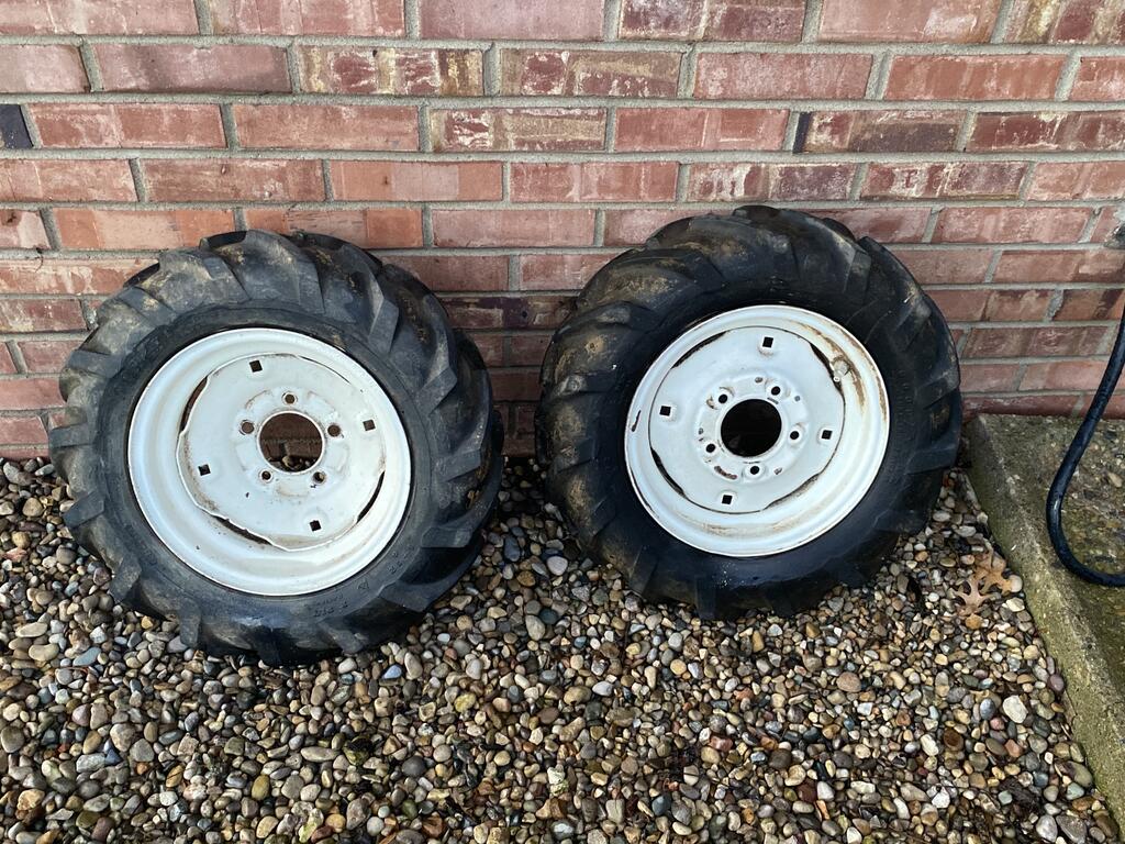

DBlackston 323 #5 Posted August 12, 2020 I recently used American automotive tire paint. Cleaned the tires with Blech-white. I read about this restoration process on this forum. Thanks so much to all the wonderfull information you all post here! It sounds like there alot of options for making old tires look new! Here are a few photos of mine before any treatment. Before and after cleaning. Before and after paint. Before any treatment and after treatment. All done. 2 1 1 Share this post Link to post Share on other sites
