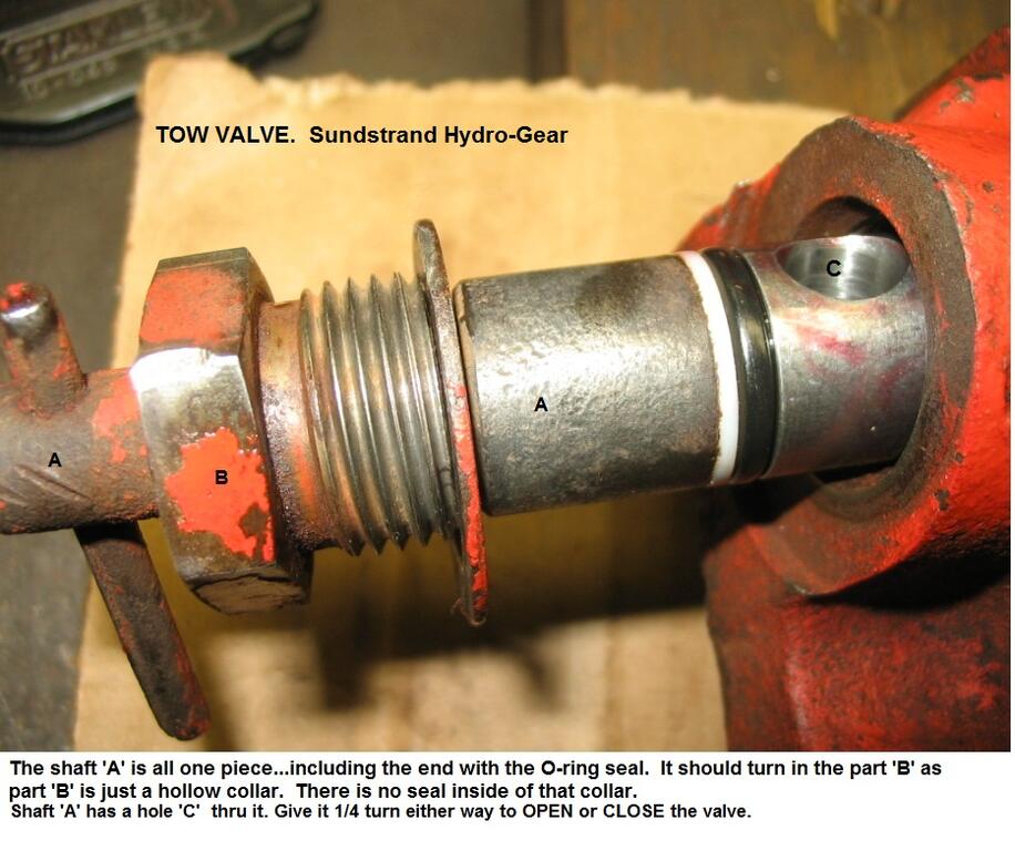

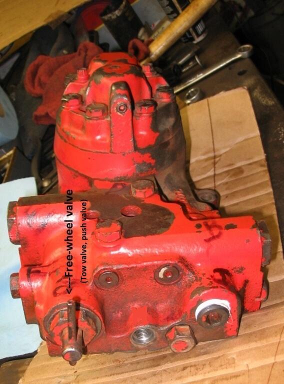

daveoman1966 3,882 #27 Posted August 17, 2020 Did you free up and/or remove R&R this Tow Valve / Push Valve on the top. There should be a Roll Pin in it that I do not see in your pics. Share this post Link to post Share on other sites
The Tuul Crib 7,354 #28 Posted August 17, 2020 Yes when l has it all apart and cleaned it up it got all new o rings and moves freely.. Share this post Link to post Share on other sites
