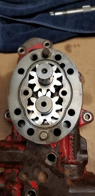

The Tuul Crib 7,354 #1 Posted August 10, 2020 Get the the gear drive together yesterday and I'm having a little issue. I torqued the bolts to proper spec numbers and when I go to turn the gear it turns rather hard. Took it back apart make sure the needle bearings were not in the way, everything is fine. It just feels like it's dragging not quite grinding but as though it's riding metal to metal. any thoughts?; IMG_8363.MOV Share this post Link to post Share on other sites

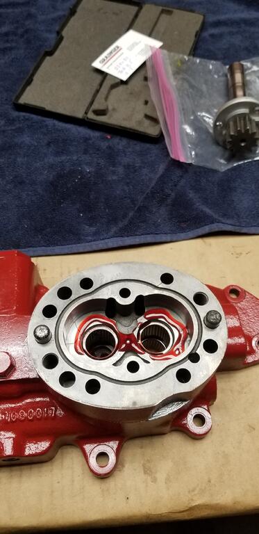

gt14rider 1,233 #7 Posted August 11, 2020 Just checked out my pump gear and can turn with two fingers, but there's some resistance. Will the shaft move smoothly with end cap off, when putting on end cap does it go on smoothly, maybe tap on the two pins or tap on end cap with a soft dead blow hammer while torquing down, also when torquing bolts, tighten in two steps, tapping with hammer and checking gear as you tighten. Also assembling lube for bearings and gears, talked to LJ and said that thay use blue loc tight between pump halfs. 20200811_091005.mp4 Share this post Link to post Share on other sites

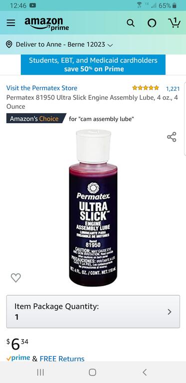

The Tuul Crib 7,354 #8 Posted August 11, 2020 44 minutes ago, gt14rider said: Just checked out my pump gear and can turn with two fingers, but there's some resistance. Will the shaft move smoothly with end cap off, when putting on end cap does it go on smoothly, maybe tap on the two pins or tap on end cap with a soft dead blow hammer while torquing down, also when torquing bolts, tighten in two steps, tapping with hammer and checking gear as you tighten. Also assembling lube for bearings and gears, talked to LJ and said that thay use blue loc tight between pump halfs. 20200811_091005.mp4 Yes before I put the cap on you can turn the shaft freely. I put the cap on and tap it in place and the shop still turns freely. Only until you talk them down is when it tightens up. I noticed you put some red colored lube in place. Is that trans fluid? Share this post Link to post Share on other sites
gt14rider 1,233 #9 Posted August 11, 2020 Cam shaft lube, put some on bearings, gears. Permatex make some, or manny others. Share this post Link to post Share on other sites
gt14rider 1,233 #10 Posted August 11, 2020 Use that lube though out intire pump, squash plate ,brass slippers. When all else fails get a bigger freaken hammer Share this post Link to post Share on other sites
lynnmor 8,885 #11 Posted August 11, 2020 Am I seeing cracks in both halves? Share this post Link to post Share on other sites
The Tuul Crib 7,354 #12 Posted August 11, 2020 1 hour ago, gt14rider said: Use that lube though out intire pump, squash plate ,brass slippers. When all else fails get a bigger freaken hammer Here's a question for you I know that automatic transmission fluid is formulated for friction is that correct? If so then maybe I should not be using it to put this together. I thought it is made for surfaces to grab hold of one another as a spin to gain momentum. Share this post Link to post Share on other sites

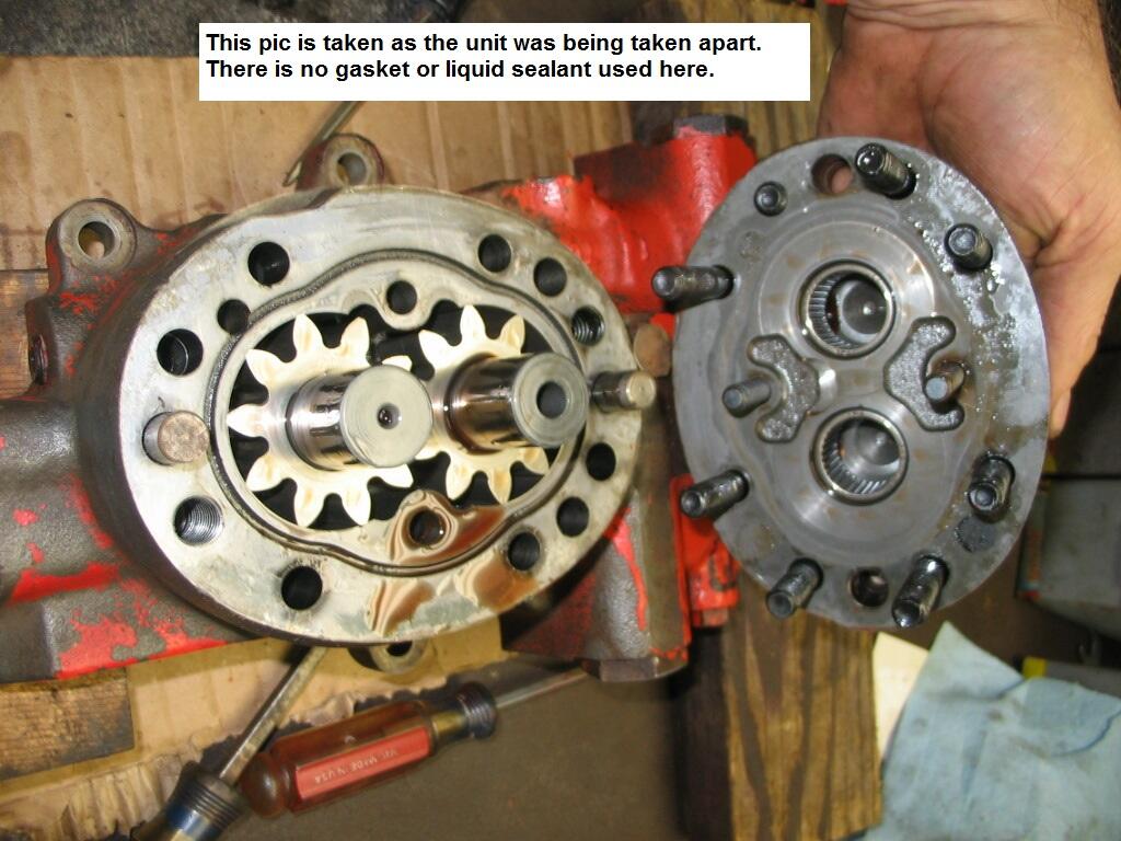

daveoman1966 3,884 #13 Posted August 11, 2020 Inasmuch as there was no liquid or gasket sealant between the two sides of the Hydro Gear (not the pump), I don't know that it is a good idea to use any sort of sealant. When torqued down, that sealant will 'squeeze' into the circulating fluid and work its way thru the entire system...contaminating the fluid. The sealant won't dissolve and just 'go away'. 1 Share this post Link to post Share on other sites
The Tuul Crib 7,354 #14 Posted August 11, 2020 And l wonder how well the ultra slick mixes with the ATF? Share this post Link to post Share on other sites

daveoman1966 3,884 #16 Posted August 11, 2020 (edited) In 30+ years and a dozen or more of these that I have torn down and/or rebuilt, never did I find one that had any sort of sealant or gasket as in the pic that I posted. These are match-machined faces and held by EIGHT bolts. It takes 8 bolts torqued in sequence to ensure perfect fit precluding the need of a gasket or sealant. To each his own though. Edited August 12, 2020 by daveoman1966 1 Share this post Link to post Share on other sites

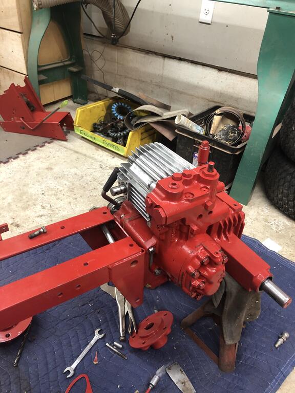

The Tuul Crib 7,354 #23 Posted August 16, 2020 Just got it back together and mounted back on the frame. 1 1 Share this post Link to post Share on other sites
Stormin 9,988 #24 Posted August 16, 2020 What was the problem with the bolts when tightened locking things up.? Share this post Link to post Share on other sites
The Tuul Crib 7,354 #25 Posted August 16, 2020 11 minutes ago, Stormin said: What was the problem with the bolts when tightened locking things up.? Not sure before I put it together the last time I added some of the permatex ultra slick. I didn't torque on them as much as before. Maybe within 3 or 4 pounds less .I'm thinking once I get the fluid in and moving it should be OK. 2 Share this post Link to post Share on other sites
