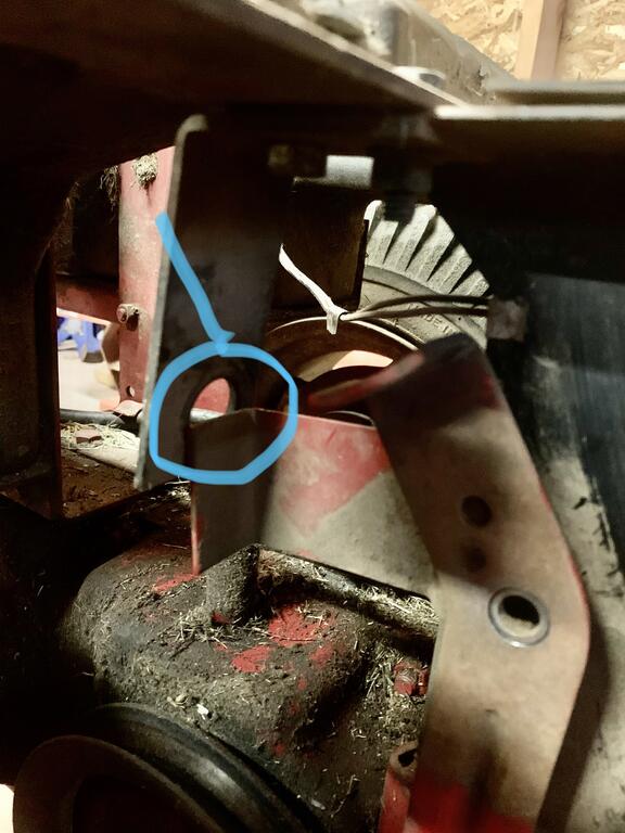

RDF 3 #1 Posted August 10, 2020 Hi there, I have my 1986 310-8 torn apart to replace the drive belt. The clutch pulley is a bit tired so think I will replace that as well. Looking at the stop bracket under the fender where the clutch pulley arm rests (when pedal is released), I can see a hole and am wondering if there should be a rubber bumper on this bracket. Looking at parts manuals, I can see that newer tractors have a damper cylinder in this location and this bracket is actually called a damper bracket. Reading through this forum I can see that the damper cylinder came in a few flavors and was mainly used in later years. Provided that I don't have a model that would have used a damper, is there instead a rubber bumper that should be in this location? Right now it is metal on metal. See picture below. Note that the pulley has been removed from the clutch arm. Share this post Link to post Share on other sites
gwest_ca-(File Mod) 12,014 #2 Posted August 10, 2020 With the correct length belt installed the arm should not reach back that far. Garry 1 Share this post Link to post Share on other sites
RDF 3 #3 Posted August 10, 2020 That makes sense. The old belt was pretty loose. Not sure if it was from wear or if the belt was maybe the wrong size to begin with. It was flapping around pretty good. Lots of cracks and the top layer is delaminating. I rolled the dice with it for two winters, but am not feeling lucky anymore. Better to change it out in warm weather than when I have a driveway full of snow. 1 1 Share this post Link to post Share on other sites
