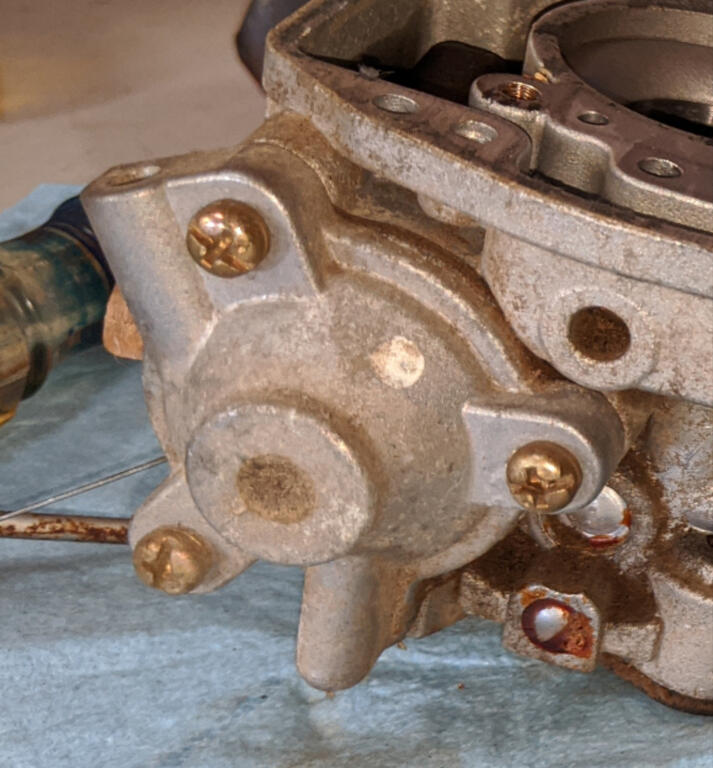

1990Onan520-H 15 #1 Posted August 10, 2020 Hey all. I've got a 96 416 hydro that started surging on me. So I pulled the carb and am cleaning it out since the machine sat outside for probably 20 years not being used. But during cleaning I saw this piece on the side of the carb with 3 screws on it. I want to pull it to clean it out, but I am having trouble finding a gasket or even figuring out what it is. Does anyone know what this is or where I can get a new gasket for it? 1 Share this post Link to post Share on other sites
lynnmor 9,073 #2 Posted August 10, 2020 Onanparts.com has the accelerator pump parts. I don’t like those carbs and replace them with older models that have no pump. 2 Share this post Link to post Share on other sites

1990Onan520-H 15 #7 Posted August 10, 2020 1 hour ago, lynnmor said: Onanparts.com has the accelerator pump parts. I don’t like those carbs and replace them with older models that have no pump. Guessing this would be the kit? https://onanparts.com/index.php?main_page=product_info&products_id=263&zenid=f06f2863a312922dbac8d042d2a8c48d I'm leaning toward just fixing what I have, but am curious as to why this design carb is maybe not as good before I spend the money on this kit and new gaskets for it etc. Share this post Link to post Share on other sites
tom2p 2,396 #8 Posted August 10, 2020 (edited) I'll jump in - until lynmor can weigh in the accelerator pump adds complexity ; another area that can require maintenance and/or cause an issue accelerator pump can also adversely impact the engine - more specifically the oil and then the engine if it is supplying the engine with too much fuel (which then can be 'unburnt' and dilute the oil) ... this can especially be a problem if/when the engine continually surges and accelerator pump provides excess fuel Edited August 10, 2020 by tom2p 1 Share this post Link to post Share on other sites
