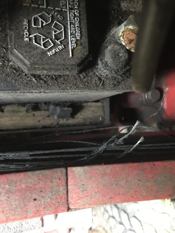

vmen84 61 #1 Posted August 9, 2020 To start off I was mowing the backyard and I guess I didn't see one of the dogs toys that I apparently didn't see which was cloth I realize this after I got halfway through mowing then by that point one of the belts had burnt up Believe is the drive belt I have a few questions. First what size belt does it be 100 wheel horse 1974 take second are there any good videos on how to replace those belts are there any videos that I can watch that show me how to do this step-by-step? Share this post Link to post Share on other sites

vmen84 61 #4 Posted August 10, 2020 So it looks like this I am new to this so what size belt would that be for the 36 inch mower deck and I'm assuming it's only belt i'll have to replace because I know there's belts underneath the deck as well but I'm not sure if those are bad now Share this post Link to post Share on other sites
gwest_ca-(File Mod) 11,757 #5 Posted August 10, 2020 Sorry thought it was a mower belt you lost. This is for the tractor drive belt to the hydro transmission. The sizes listed are for the original belt. If you get an after-market replacement it will be even inches in length and get one designed to bend backwards over a flat idler. 5/8" x 84" should work. Garry Share this post Link to post Share on other sites

gwest_ca-(File Mod) 11,757 #8 Posted August 10, 2020 Tractor drive belt # 7478 replaces # 4535 - (HB/5L x 84.22" or 5/8" x 84.22") from belt chart and appears to be correct. 1974 B-100 Auto model 1-0510 Garry Share this post Link to post Share on other sites
