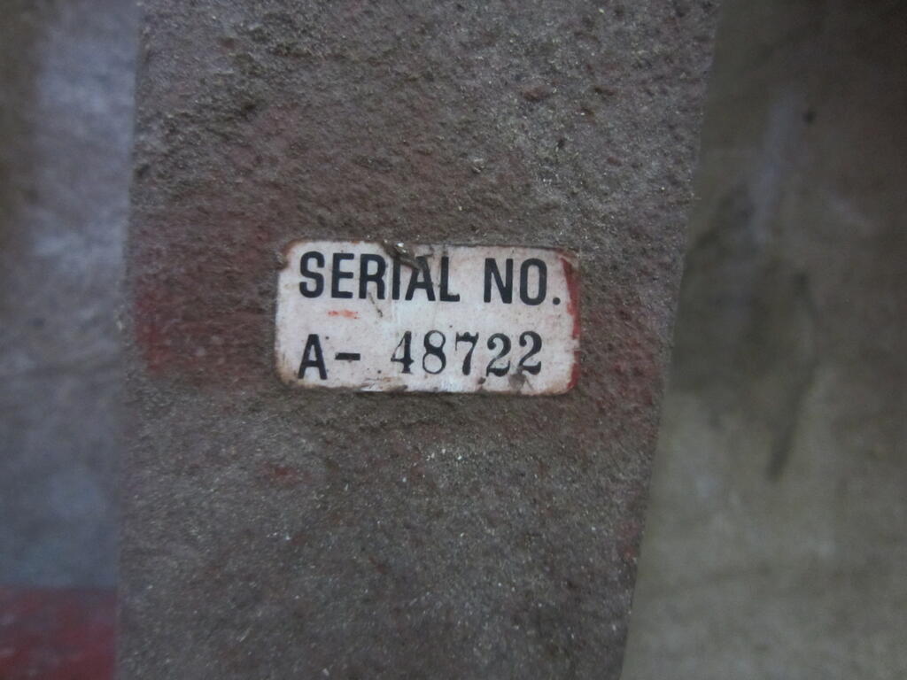

Herder 2,356 #1 Posted August 9, 2020 I recently posted a 50 inch sickle bar in the classified section, it was on one of my 953's. I had assumed, yes I know "assumed" that it would it fit any long frame Wheel Horses. Someone has asked about the fitment between the 953 and other long frames. Just wanted to be sure about interchanging between tractors. Any assistance would be appreciated. Thanks. Share this post Link to post Share on other sites
