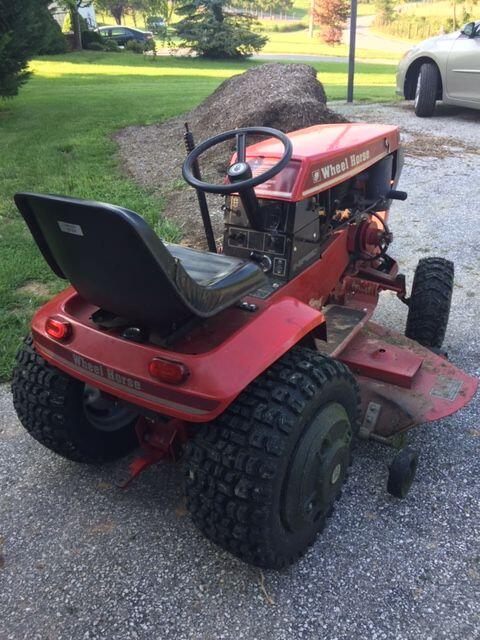

Lagersolut 764 #8 Posted August 10, 2020 3 hours ago, stevasaurus said: Just thinking, those new bolts might be the culprit. I believe the bottom 2 bolts are blind holes, but the top 2 go through. (I always thought all 4 were blind holes, until I did my Brother's #5091. The top 2 were open). You can pull out those top 2 bolts (1 at a time) and put some Teflon tape on and see if that is your leak. @Lagersolut Those new Grade 8 crossed my mind that's why I threw it in there on my last post . I just had this apart a few months ago had a thread here replaced the cluster gear . Just bought this 416-8 last September went over the entire unit ...here's a pic - just stepped up on these new Kenda tires for the hill we live on . This things a beast ....hands down favorite of my 4 . 1 1 Share this post Link to post Share on other sites

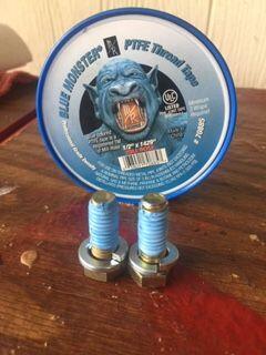

Lagersolut 764 #9 Posted August 16, 2020 (edited) Taped up replaced one at a time - closer inspection ( pulled the input shaft pulley back away from case ) looks like it's really damp . Think I'm going order one and replace it - if it's not the problem now it will be later This dope tape made for oils and gasses . Edited August 16, 2020 by Lagersolut 1 Share this post Link to post Share on other sites
