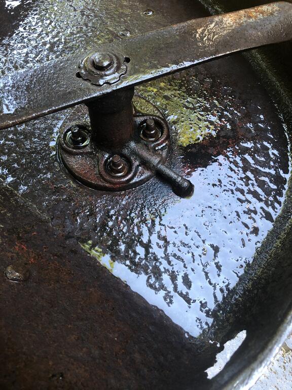

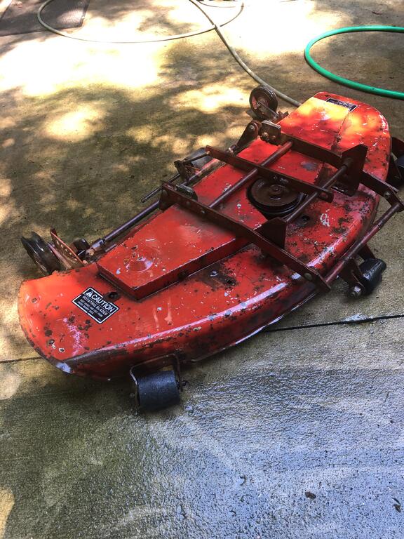

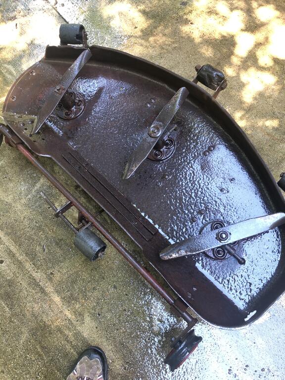

The Tuul Crib 7,354 #1 Posted August 8, 2020 (edited) Drove about an hour west of here to pick this up this morning. It has two rust holes in the normal spots. Somebody has done some repairs along the way but all in all the deck is pretty solid. Seems to be the older style 48 inch but there are no serial numbers to be found. Looks possible to be maybe early 70s or late 60s? Edited August 8, 2020 by The Tuul Crib 1 3 Share this post Link to post Share on other sites
gwest_ca-(File Mod) 12,358 #2 Posted August 8, 2020 Should be one of these 1966-1967 model RL-486 replaced by 1968 model 5-1481 1969 model 5-1482 1970 model 5-1483 1971 model 5-1200 1972 model 5-1201 1973 model 5-1202 1973-1974 model 5-1210 1975 model 5-1211 1976 model 65-48MS01 1976 model 65-48MS02 1977 model 75-48MS01 - These all used blades with 5/8" x 3/4" double-D center hole unless the spindles have been upgraded. Garry Share this post Link to post Share on other sites
peter lena 9,943 #3 Posted August 8, 2020 the tuul crib, in addition to the patch work needed , take advantage of that clean solid bottom , and after a thorough drying , spray oil penetrating oil on it and a hot sun drying / feeding the metal . do that a number of times to prevent rot and stop corrosion . after oil soaking, leave in sun upside down so the deck gets hot and draws in the oil lubricant. been doing that for years , no rot, pete Share this post Link to post Share on other sites
daveoman1966 3,884 #4 Posted August 8, 2020 From the Toro MPV.. Deck # 5-1200 https://lookup3.toro.com/partdex/index.cfm?xCaller=Toro Share this post Link to post Share on other sites
Lee1977 7,709 #5 Posted August 10, 2020 It's an early Double D the attachiment hardware looks wide might be for a D series. Share this post Link to post Share on other sites
